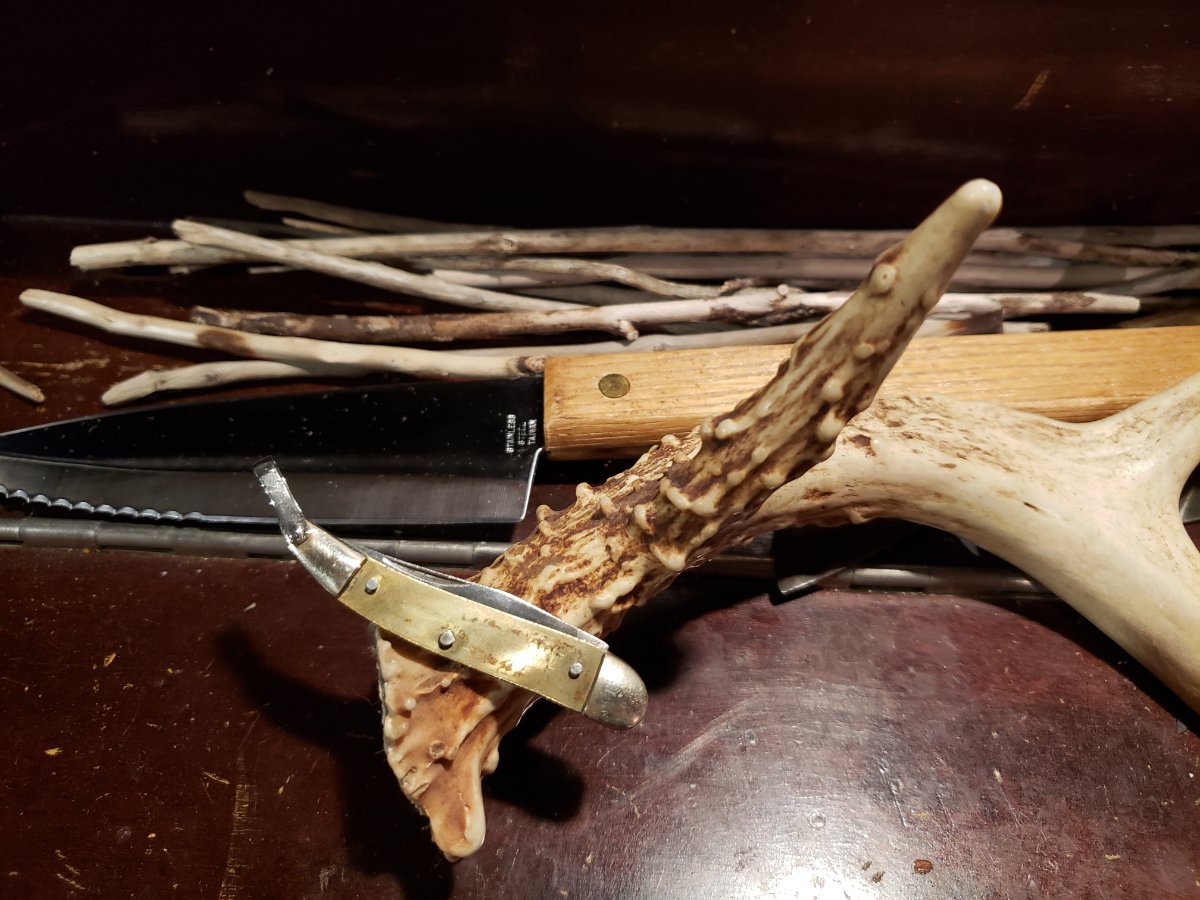

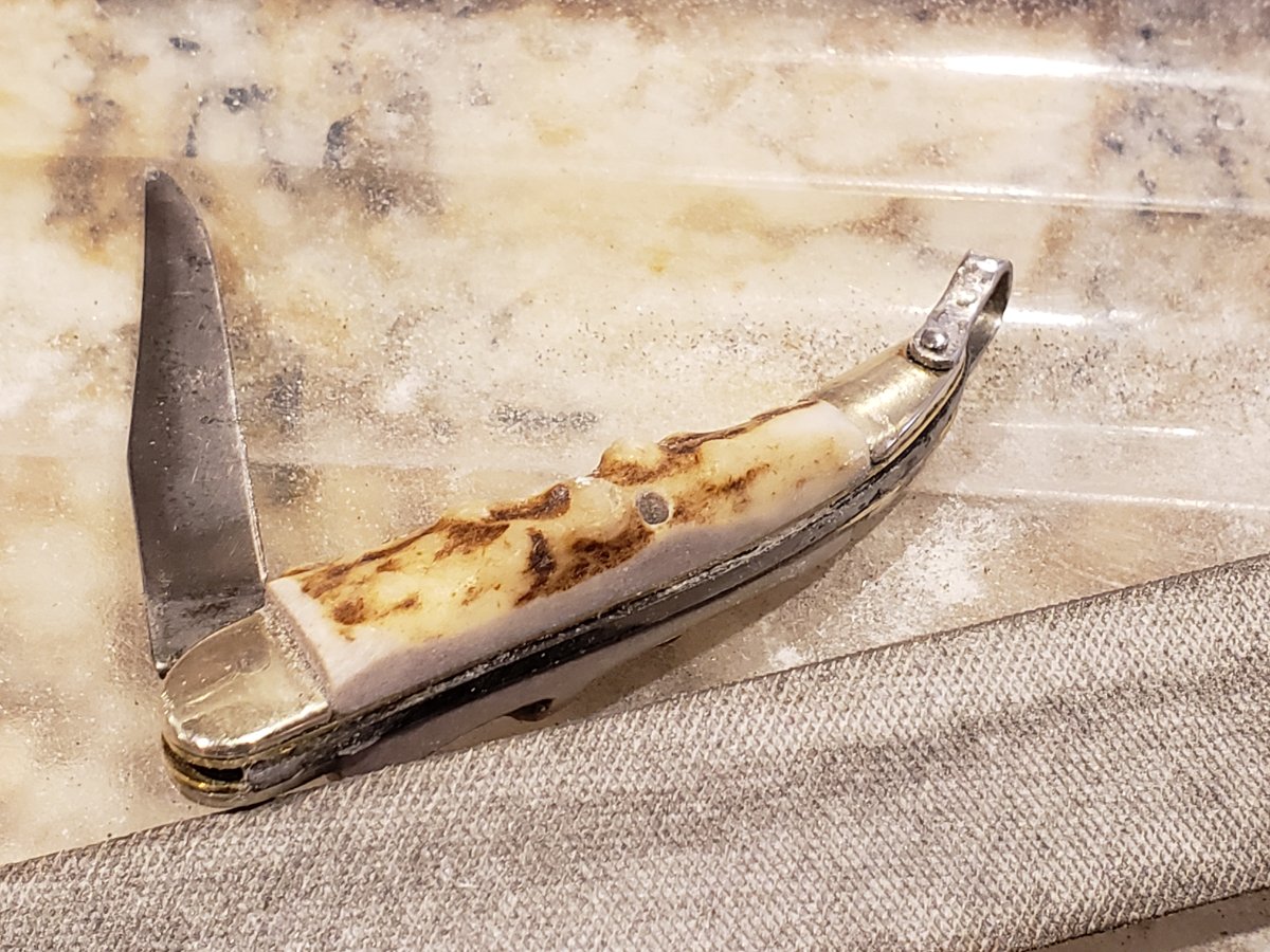

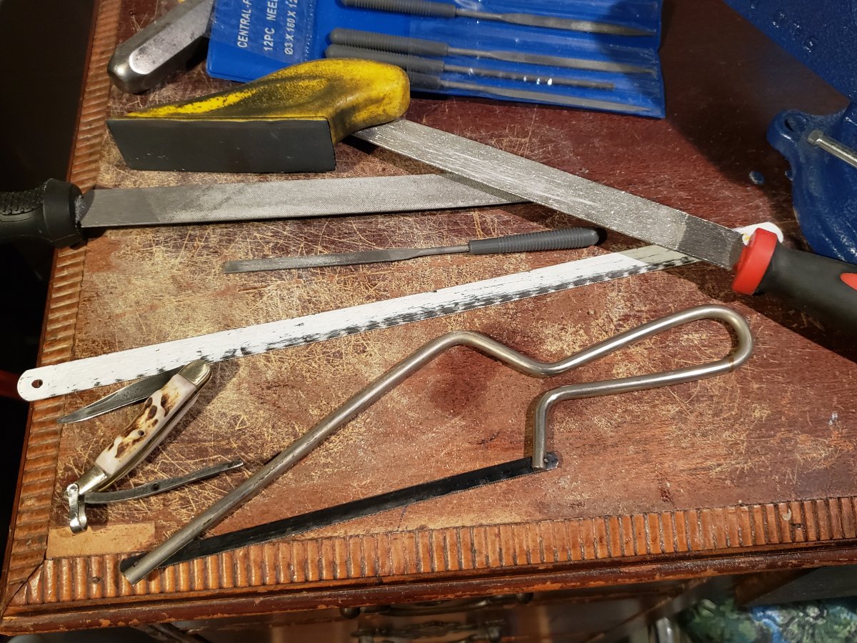

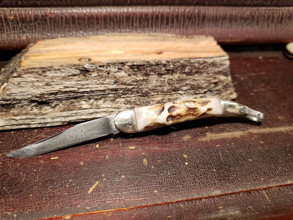

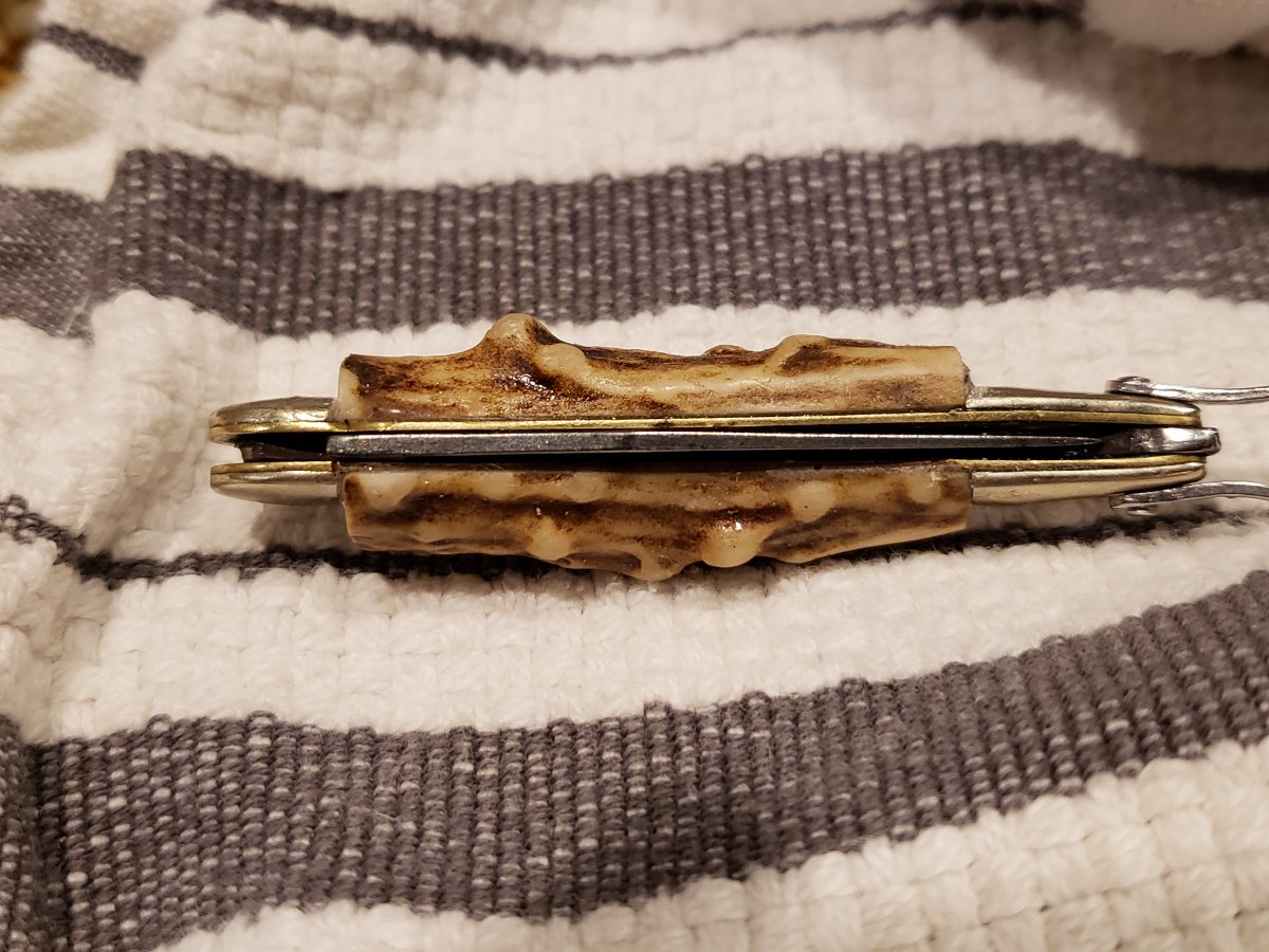

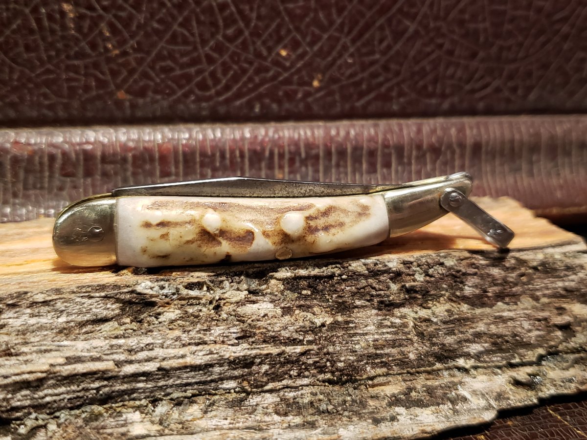

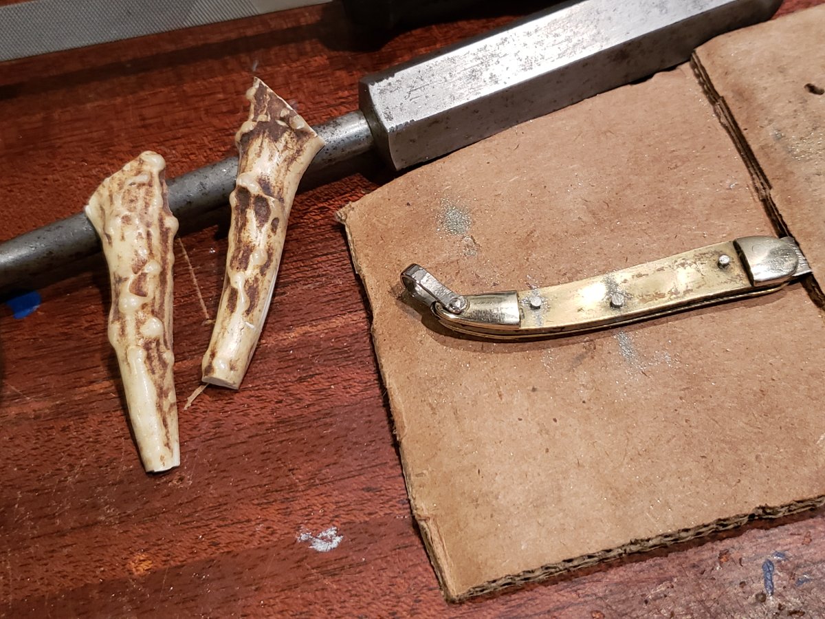

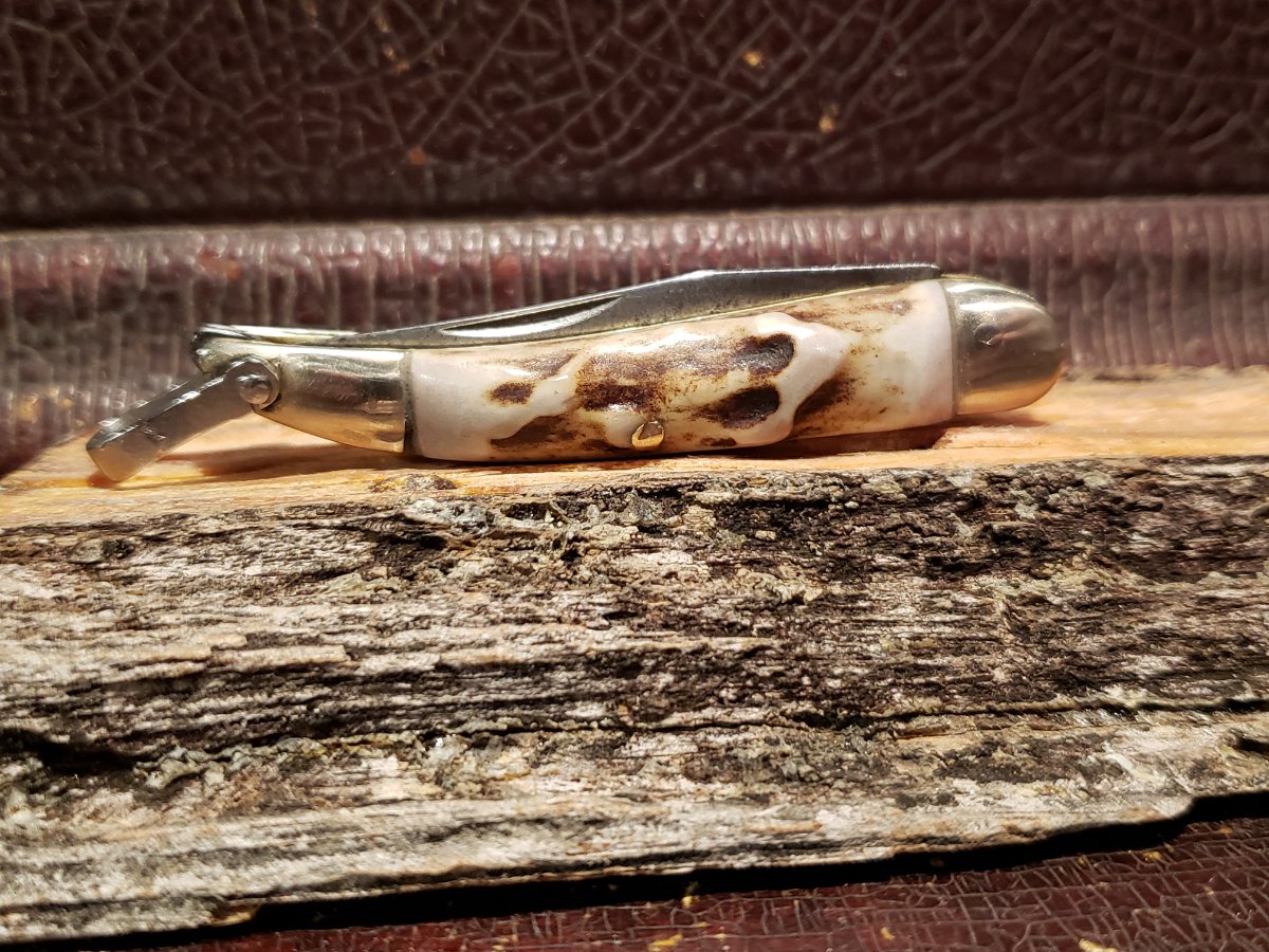

My first attempt at rehandling a solid bolstered knife. Chosen subject was this tiny Colonial. It once had risqué picture celluloid scales. Those were cracked and gassing. The antler used is local wild shed white tail. I didn't do scale pins, only the pivot. The action is compromised because I reamed the pivot pin hole out slightly on accident and now it's out of round with not enough backspring material to fix it. The scales are fatter than intended. As I shaped them, at a certain point, I couldn't make them thinner without losing width, so I leaned into the fat boy look. Just hand tools used. That hacksaw blade was new when I started. Learned alot about shaping antler. There's a slight gap next to bolster on the mark side by the bail. I mixed the antler powder from sanding into the epoxy to color it. Mediocre results on that.

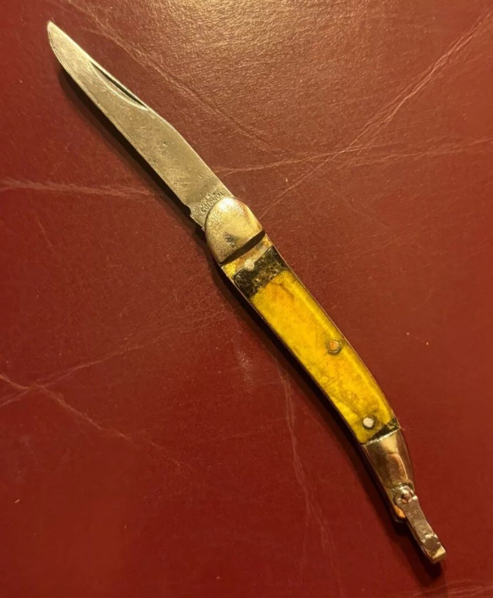

Here's the before. This is a pic from the bay listing.

Re: Fat Stag Colonial
Very nice!
I have found Whitetail antler to be one of the more difficult antler to work with, and usually yielding poorer results.
They are full of curves. Most of mine have had a decided grey inner color.
Elk and Moose are brighter colored inside, usually daeker contrasting outside, and being larger are usually easier to get a flat piece out of it.
The fact that you made Whitetail antler look that great is a testament to your skills, sir!

I appreciate the feedback RevReverand wrote: ↑Fri Jan 17, 2025 1:05 am Very nice!
Thank you kind sir
Will be doing a slightly larger tipped bolster next. Hoping to improve my skills to the point where I'll feel good putting new pants on an Ariel coke bottle midlock hunter I was gifted. It's an awesome knife, I want to do it justice. Need lots of practice

Oh and i misspoke on my first post. I redid the rocker pin, not the pivot. The pivot pin was left alone, the rocker pin hole on the backspring is what's now out of round.
