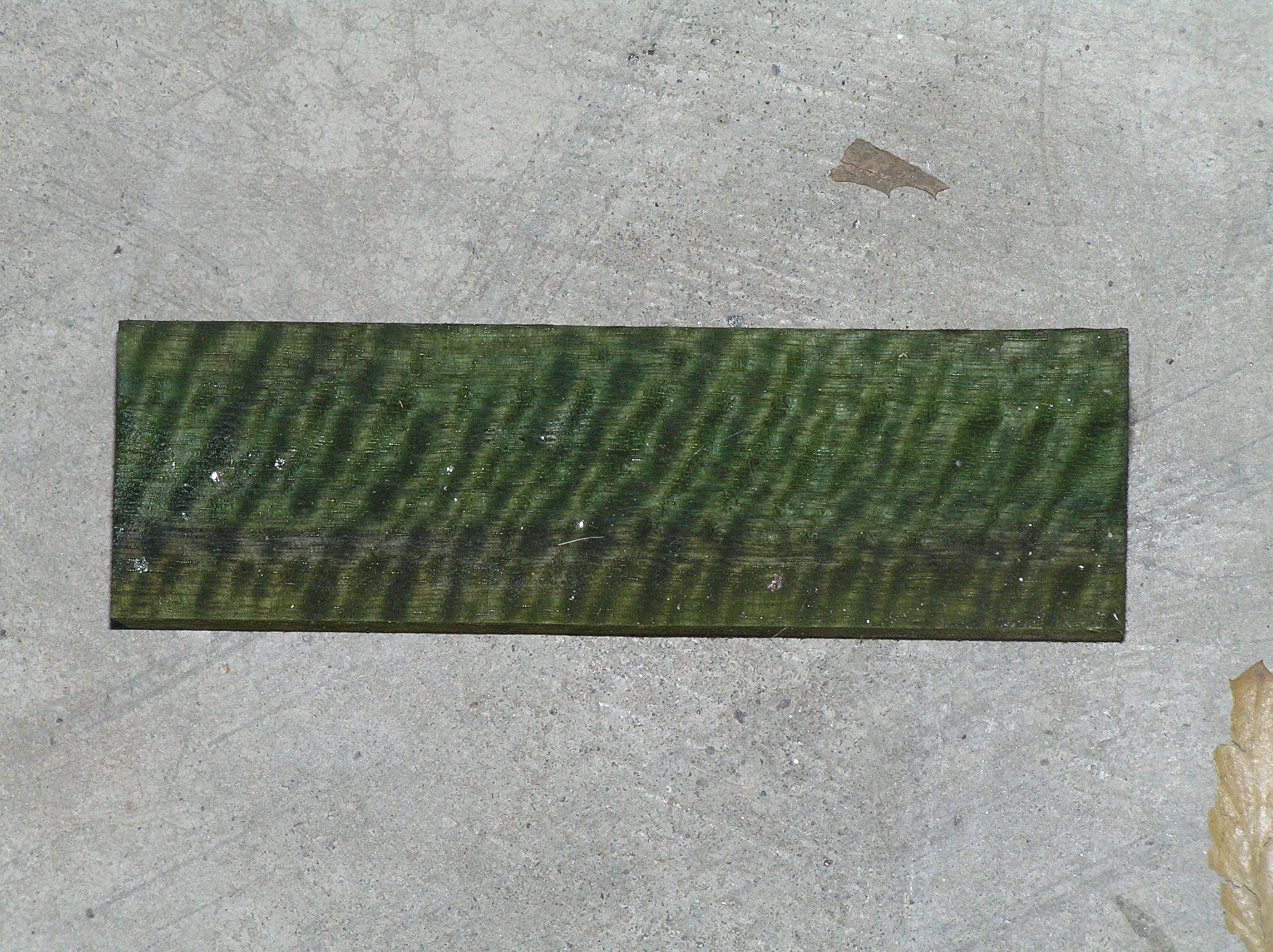

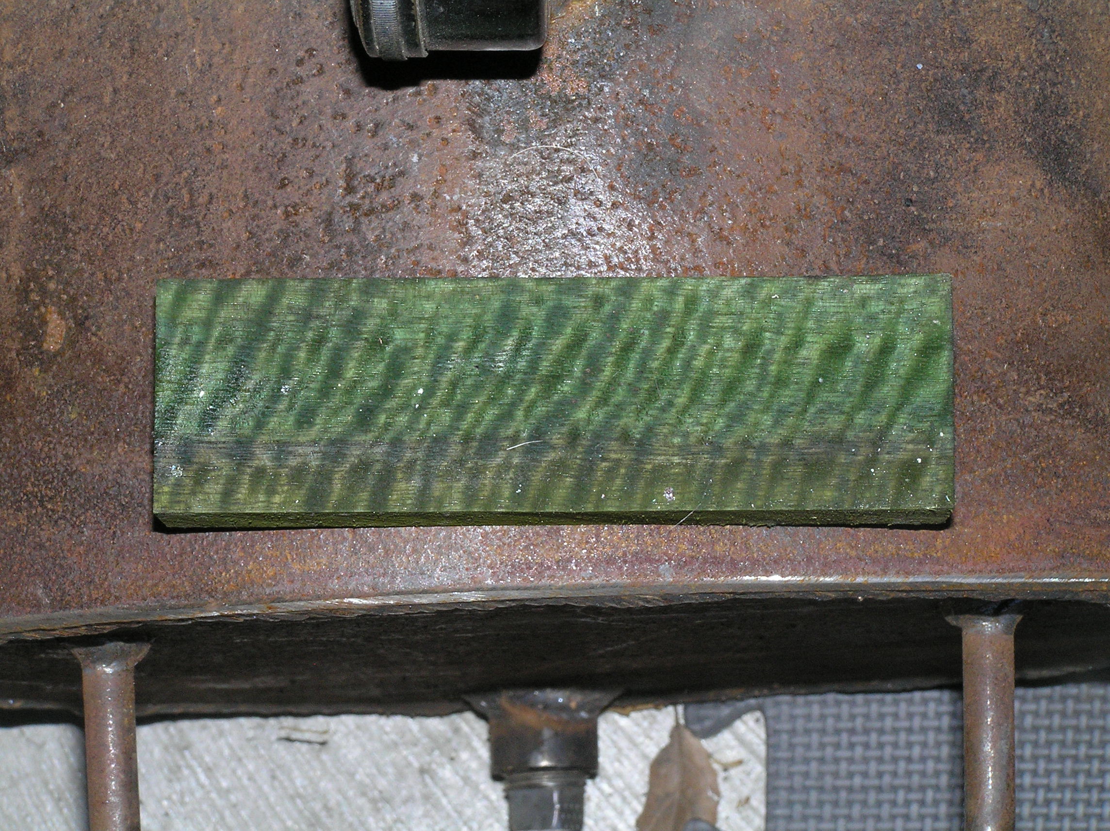

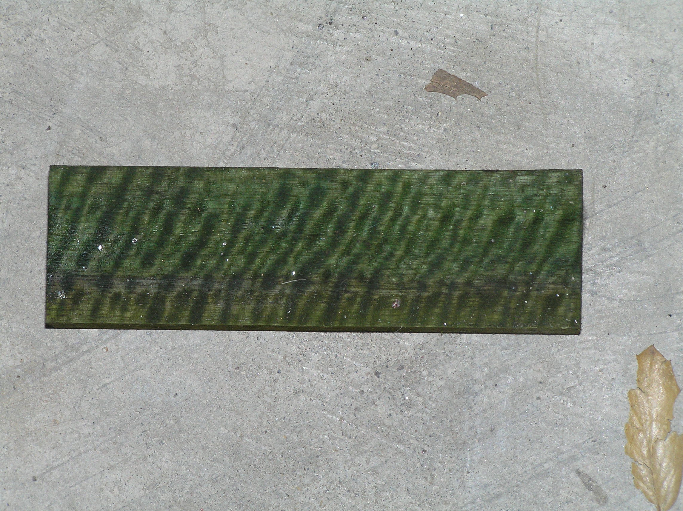

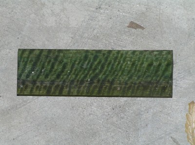

Well, this is what I broke out of the jars this morning - ONE of them anyway. It should darken a lot as it dries.
The shiney specks are pieces of glass. :roll: :roll: ::paranoid:: BUT NO RED IS GOOD! :mrgreen:
In the center picture you can see how dark it is along the bottom, the whole thing should dry that way. They've lost about 50% of their weight but have a long way to go before stabilization. They sill feel heavy.
I should take pictures of the others. I have blue Birdseye maple and yellow spalted maple also. This is the first batch.

Don't drop that one in the tall grass... :shock: ::doh::
They look good for certain. ::tu::

:lol: :lol: :lol: That's for sure, it wasn't my idea - I just had to figure out how to do it. YES, the color goes all the way through! I cut one in half and dye was running out of it. :shock: Anyhow the last 4 jars are in the chamber now. They say 28.3 inches of mercury or about 13 PSI of negative pressure or vacuum is the most you can get. I used a cheap venturi type device (for refrigeration) from Harbor Freight ($17.00) at 120 psi on the compressor and got it down to 28 inches. What I did was to heat a large plate and heated the dye and plate to 210 degrees F inside the chamber. So when I pulled the vacuum to about 13psi at over 200 degrees F inside the chamber I had well over 33 inches of Hg or nearly 17 psi of vacuum or negative pressure ONCE everything had cooled. They told me it couldn't be done without spending $1000's of dollars of specialized vacuum equipment. Well, my cost was $17 and $8 worth of parts. They made the venturi device for R12, R22 and R134 refrigerants and they have secial fittings for refrigeration (supposed to be certified for the R12 and R22 - Freon). Well, I just changed them or modified them to take standard fittings and hose barbs.
Remember Grandma's canning (actually Mom's), well it starts hot and creates a small vacuum as it cools. That's how I got the extra 4 psi of vacuum "that couldn't be done". A real simple solution and that's all I did. :mrgreen:

ok..i still don't understand a thing about how you did it...but the outcome is great...
::paranoid:: i have to admit od green is not my color...been there done that.

Well if the tank were empty and I wanted this to dry fast AND crack I could put it in an empty jar and the vacuum would suck the moisture out and it would dry quicly. Pressure could do the same thing.
The other aspect, what I did was to put the wood in a jar of liqiud dye and pull a vacuum. The piece of wood now acts just like the wick of a candle. The vacuum sucks the dye up into the wood. The wood is like a straw because there is nowhere else for the dye to go. Now if you are thinking of super high vacuum then water based dye will vaporize in both cases. Getting to -16 or -17 psi is quite high for a home environment.

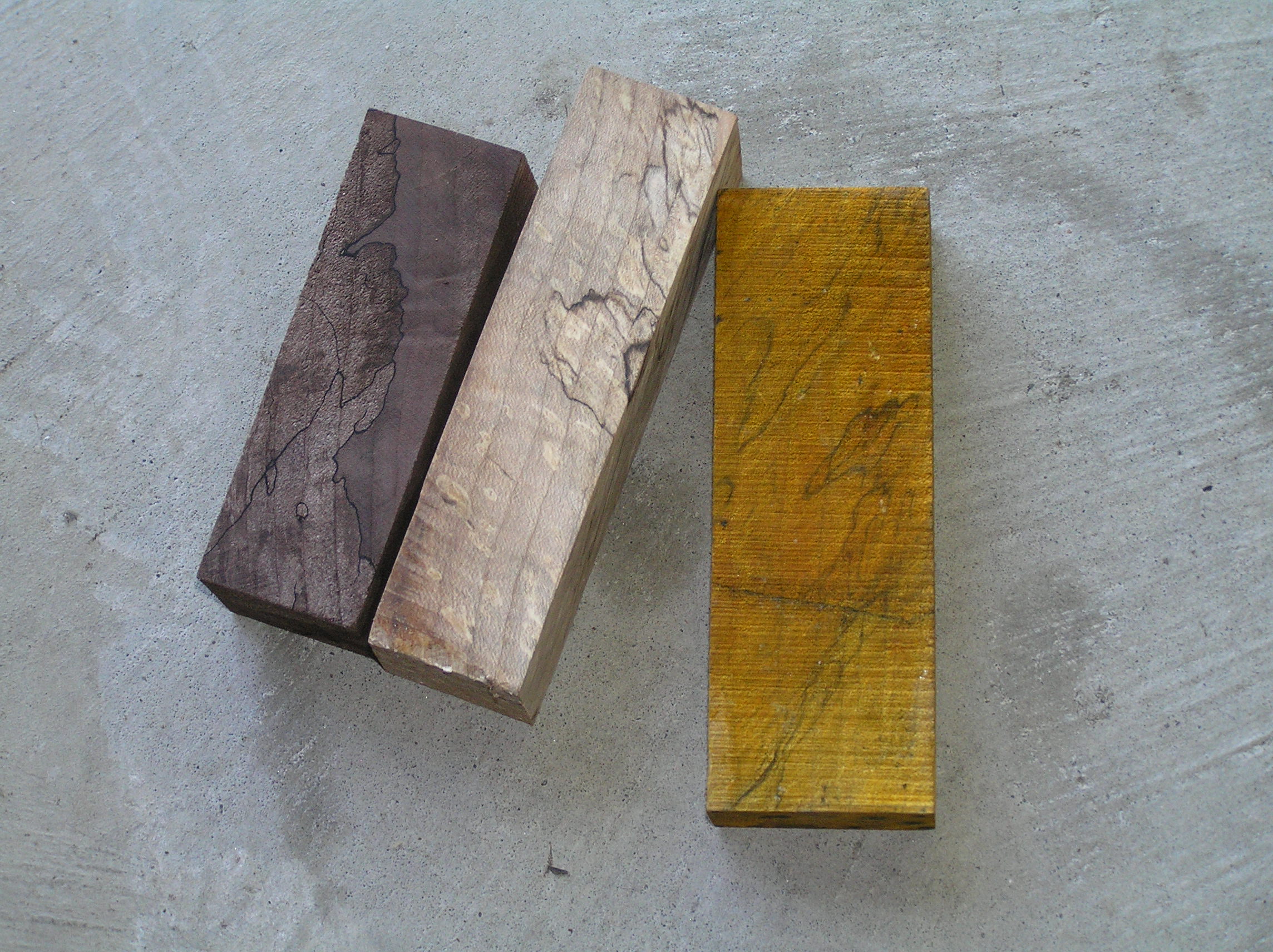

Well, here are a few more colors, I am making some modifications to the tank before I do some more.
FIRST PICTURE: Brown on the left, NATURAL in the center and Yellow on the right.

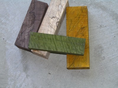

SECOND PICTURE: Brown on the left, NATURAL in the center and Yellow on the right, African Fiddleback Movingui - Green across.

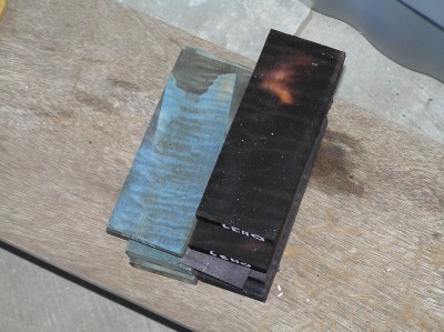

THIRD PICTURE: Blue and Brown Tiger Curl Maple
Ooops, :oops: :oops: I forgot to take a picture of the black - customer order, I'll do that tomorrow.
Same but has some African Fiddleback Movingui - Green

Thanks, I buy the wood dye at K&G and by their instuctions 1 oz. to the gallon is quite bright. I tried and indeed it is. :lol: :lol: :lol: So this green is a combination of 3 cc's blue, 3 cc's of yellow. I used an online calculator (gotta love em) to figure that 29.5 cc's is an oz so I figure on 7 cc's for a quart and I toned it down to 6 cc's for a quart. I have some that I mixed red and brown, but I need to revisit that one. I used 2 cc's red and 4 of brown, seems all I need is 5:1 to make it look better.
