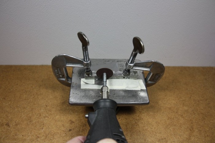

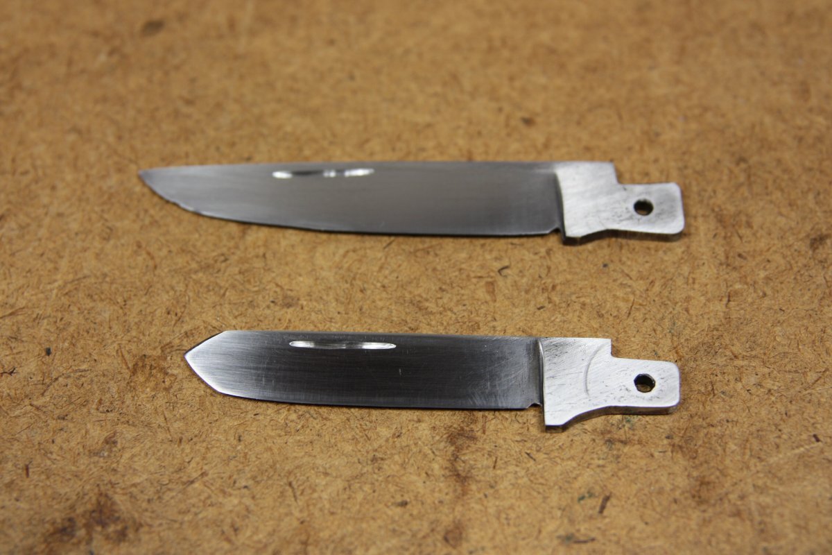

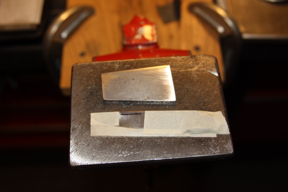

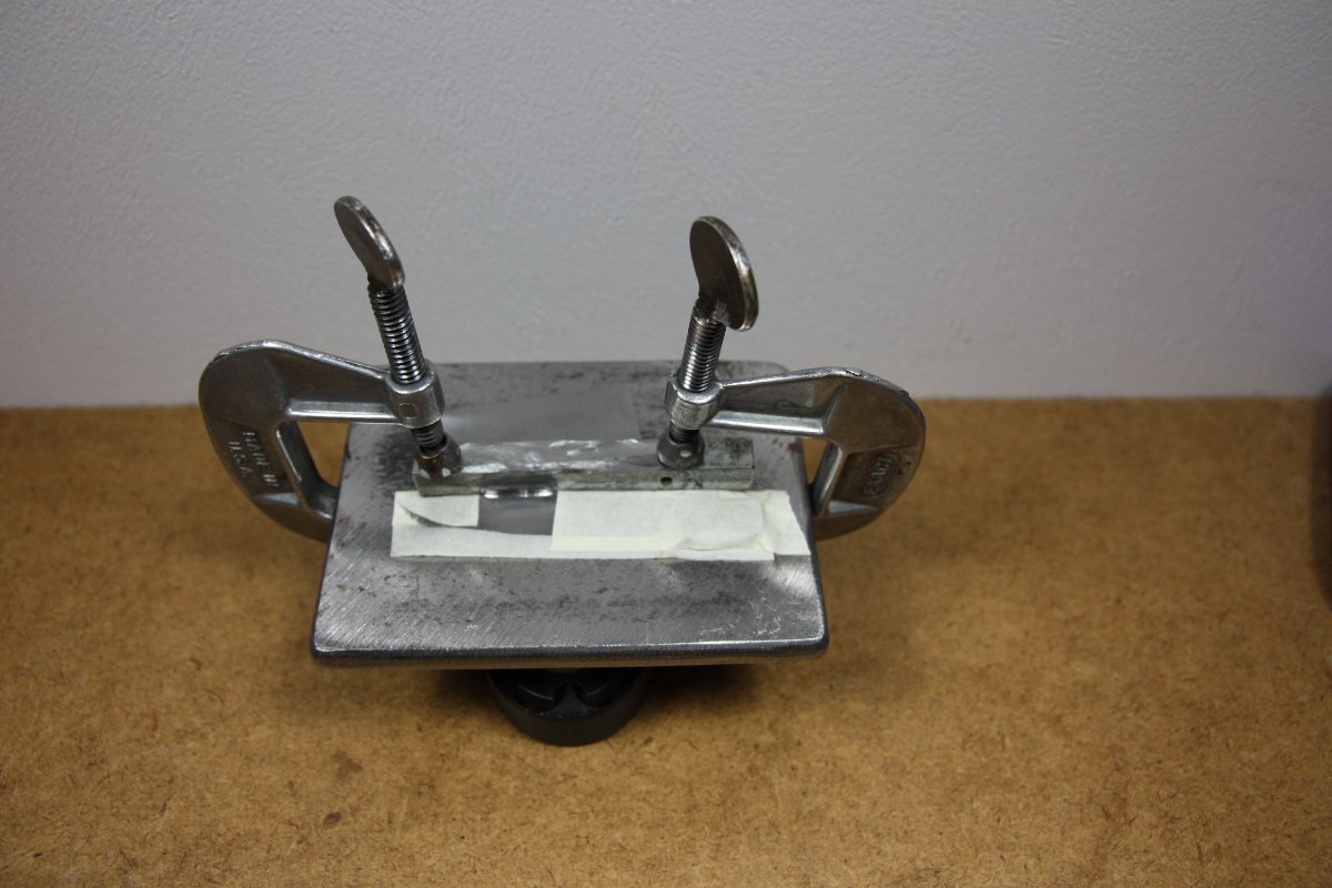

I just wanted to show a few pics of how I cut the pulls into the newly made blades on the recent rebuild of the Cattaraugus Sowbelly. I like this method because it uses a common power tool and does not require and fancy or expensive equipment.
Mark where the pull is to be cut parallel to the spine with a fine tip Sharpy. Tape the blade to avoid scratches. Use a piece of scrap the same thickness as the blade and clamp a piece of scrap metal as a guide. I had a piece of 1/4 inch keystock for this. Run the Dremel tool at max speed along the scrap metal being careful of the initial touch that the tool doesn't jump or torque. Grip with both hands. Make multiple passes to get the depth and length desired. Finished product. This makes a narrow, square cornered slot that the fingernail can easily engage. There are different thickness Dremel wheels available if a wider pull is desired.
