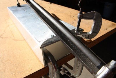

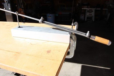

Yes I have both made replacement blades and a couple of knives entirely from scratch. First thing I have to say is it is a lot of work. Don't expect to finish it all in one day!! I don't have a belt grinder, so I use a home made file jig to put the bevels on the 1095 blade blanks cut from bar stock. I will attempt to put links for pictures I have posted here so show the jig in action.
