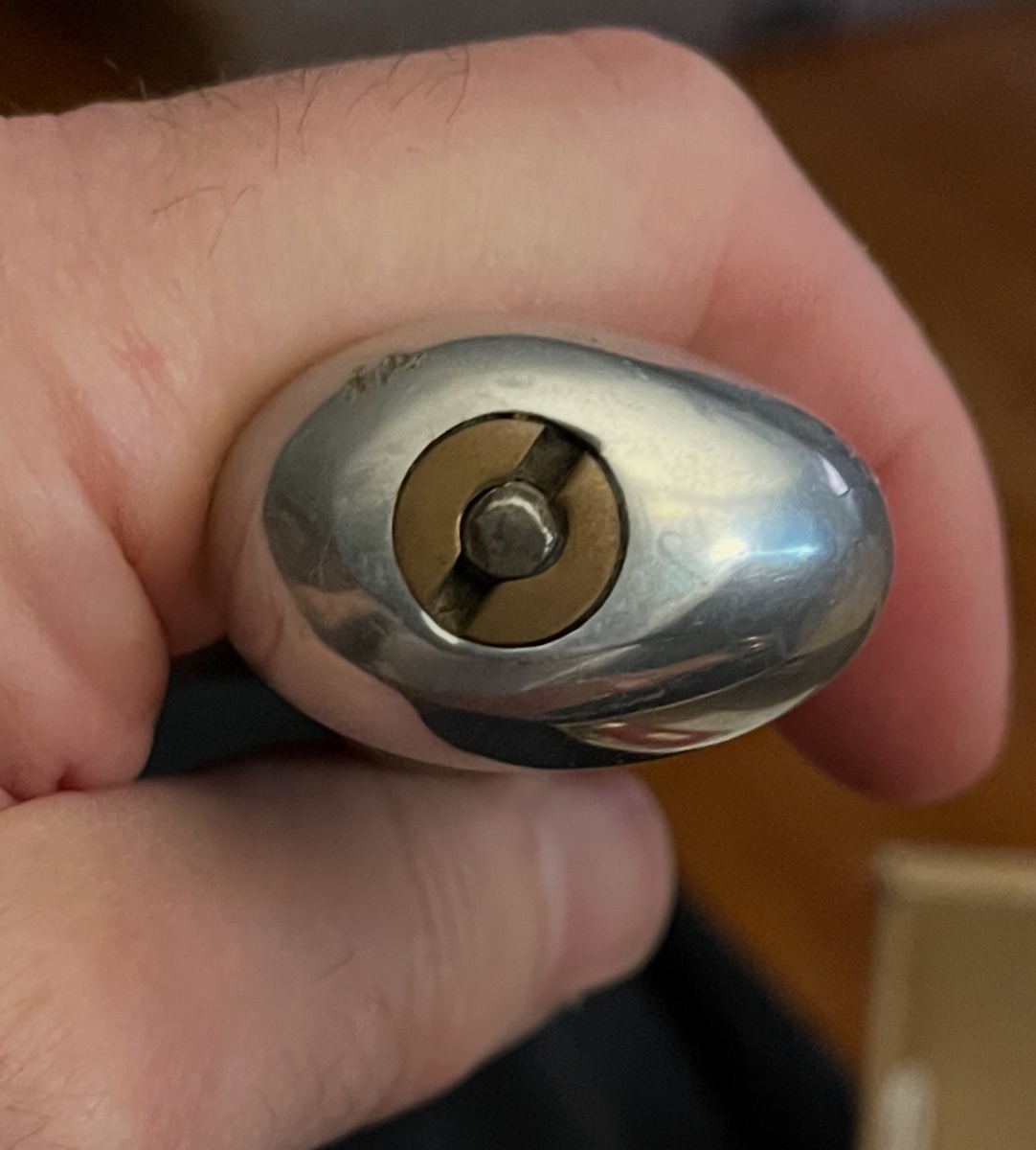

Tightening Tool
Does anyone know if they make a tool to tighten this nut on a fixed blade, or do I need to make one? I figure I can use an old straight blade screwdriver and grind the center of the tip out, then make 2 flat sides on the handle so I can put a wrench on it to snug it up.

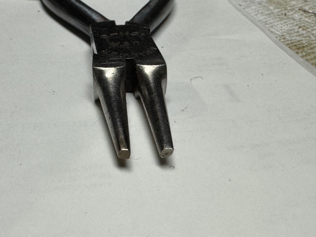

I would assume there is a tool for that purpose.CarMan wrote: ↑Sat Jun 28, 2025 12:54 am Does anyone know if they make a tool to tighten this nut on a fixed blade, or do I need to make one? I figure I can use an old straight blade screwdriver and grind the center of the tip out, then make 2 flat sides on the handle so I can put a wrench on it to snug it up.
Thanks John

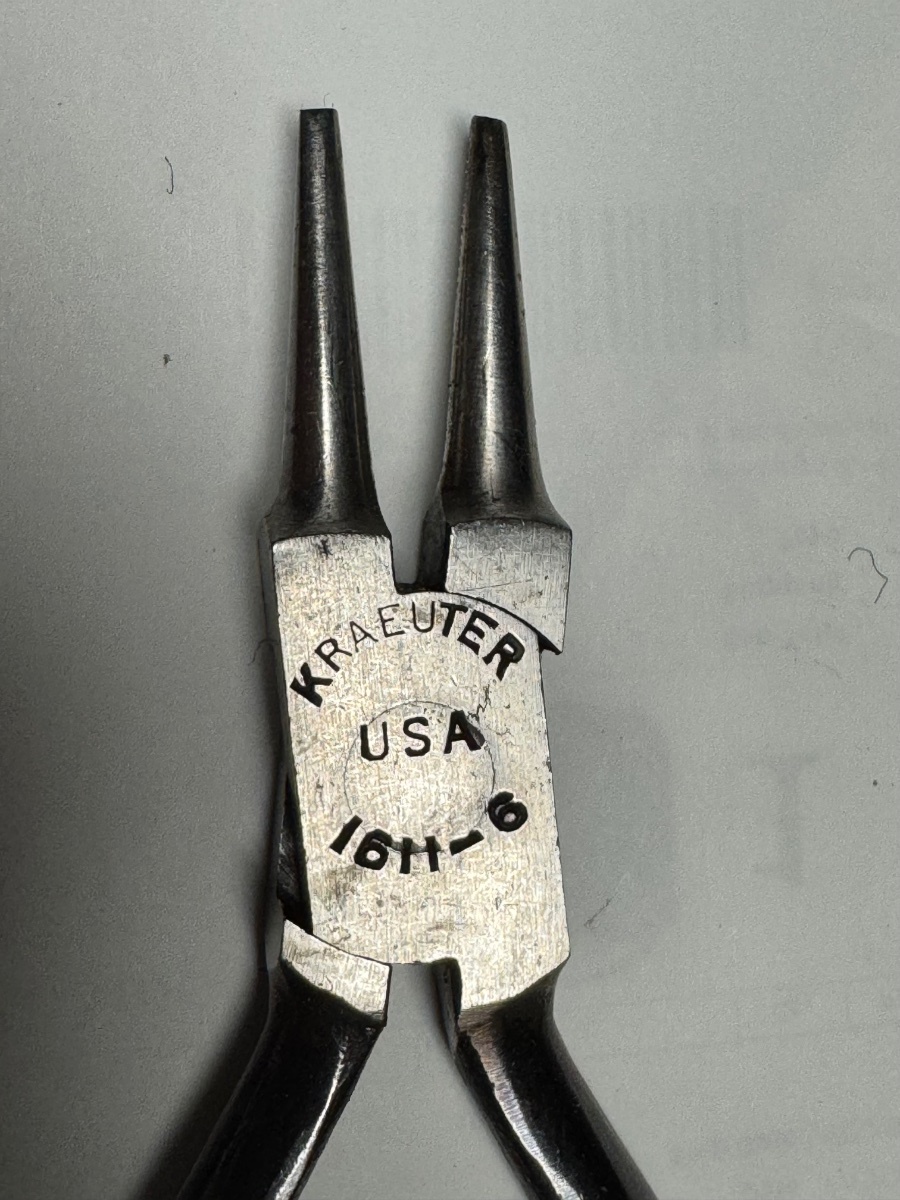

I have these round jawed pliers that would probably work in a pinch.
Searching for the brand and the model number might get you the tool if that is what you want.

Those or split ting pliers is a great idea, thank you sir.FRJ wrote: ↑Sat Jun 28, 2025 1:09 amI would assume there is a tool for that purpose.CarMan wrote: ↑Sat Jun 28, 2025 12:54 am Does anyone know if they make a tool to tighten this nut on a fixed blade, or do I need to make one? I figure I can use an old straight blade screwdriver and grind the center of the tip out, then make 2 flat sides on the handle so I can put a wrench on it to snug it up.
Thanks John

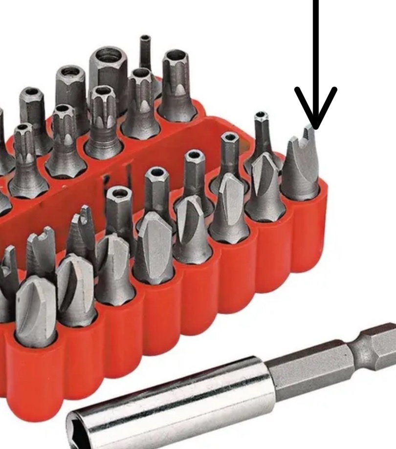

Harbor freight sells a security bit set with something that may work. It’s $5.99
