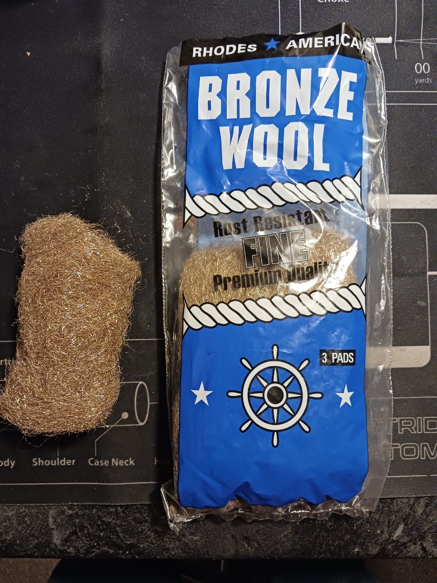

I am trying out a new (to me) product for cleaning old knives that may have some rust as well as other grunge on them. It is bronze wool and it is very similar to the more familiar steel wool, but is much less likely to scratch steel blades as bronze is a softer metal. I got this from Amazon, and is the fine grade. I used it on a 22 rifle I recently bought at a pawnshop that had a couple of spots of rust on the action and barrel. It removed those spots without affecting the bluing. I used a light wiping action rather than a high pressure approach. I have not yet had a chance to use it on blades with an etch, so if someone tries that I would like a report.

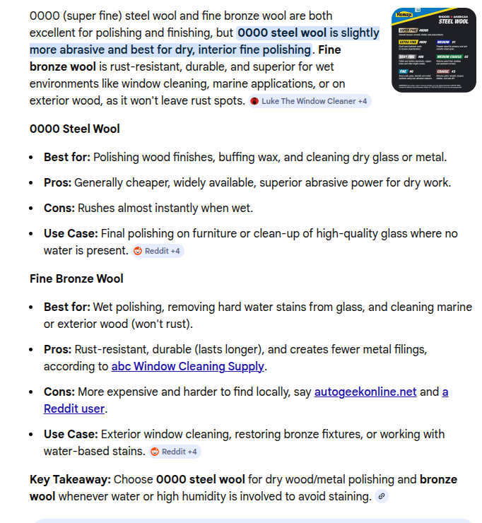

I was curious how the "Fine" grade compared to 0000 steel wool but this cleared things up, wet application seems to be a shining feature for the bronze too.

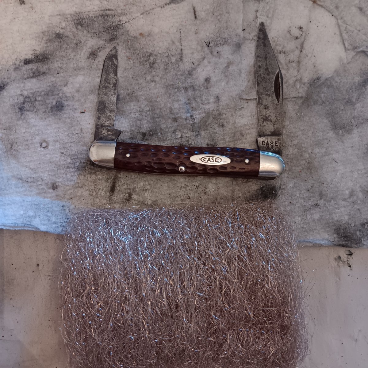

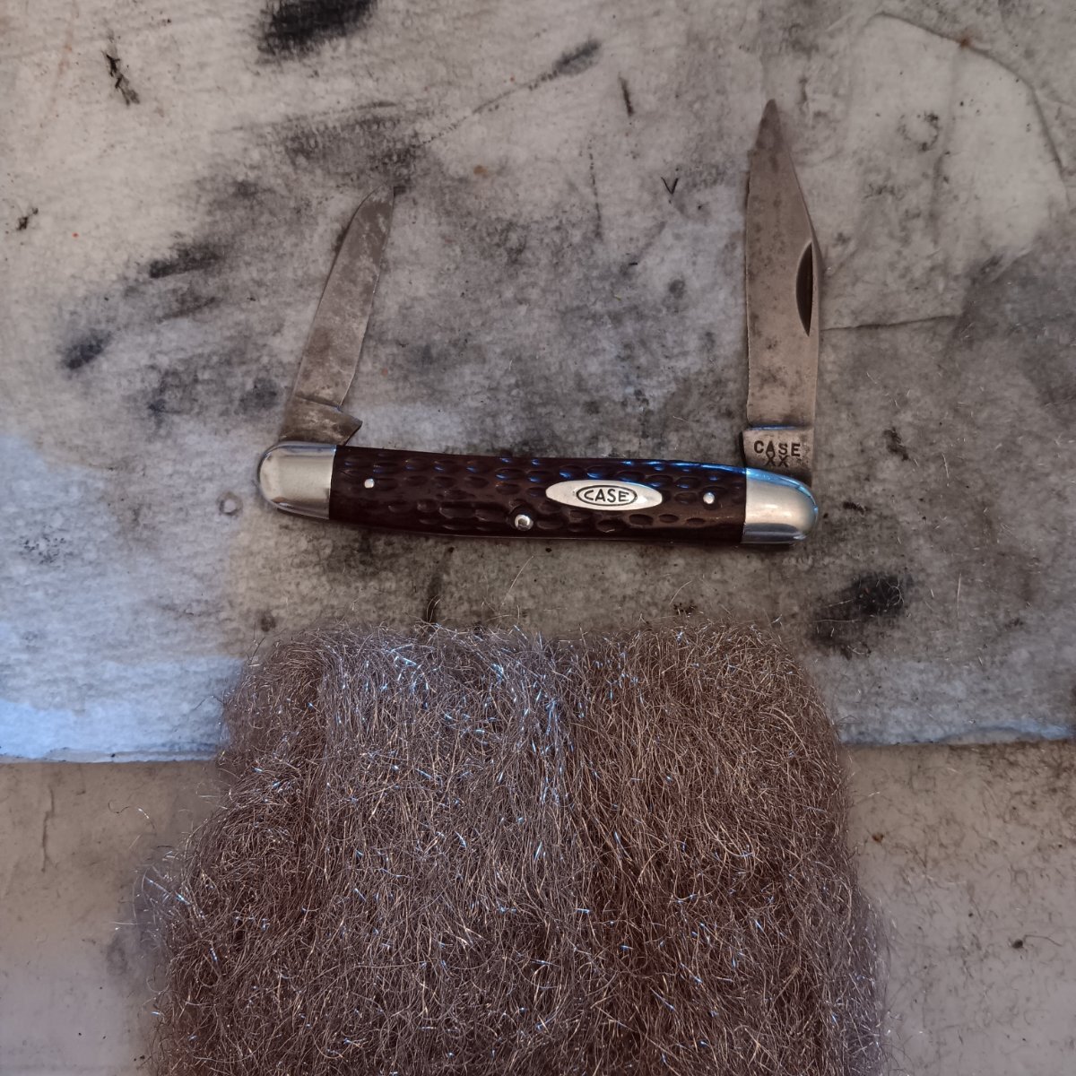

Before and after shots using bronze wool for about 5 minutes.

1967redrider wrote: ↑Mon Apr 20, 2026 11:26 pm Before and after shots using bronze wool for about 5 minutes.
- glennbad
- Posts: 8174
- Location: NH
Re: Bronze wool
That looks good. Taking off the bad stuff, but leaving the good stuff!1967redrider wrote: ↑Mon Apr 20, 2026 11:26 pm Before and after shots using bronze wool for about 5 minutes.

Re: Bronze wool
Thanks, gents, I agree.
