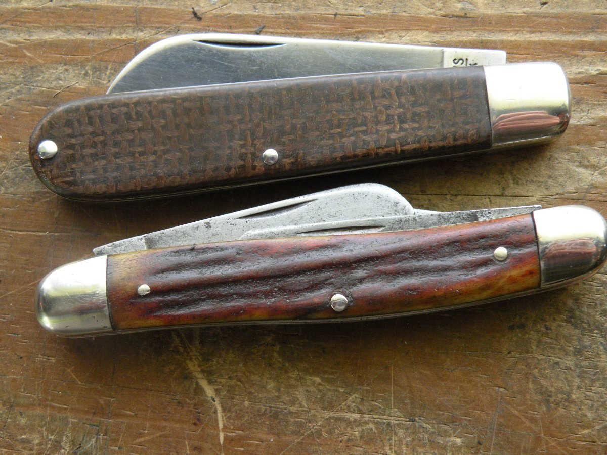

I make and use domed pins all the time and these are the only pin heads that I like to use now. Here's a pic of a couple of oldies with domed pins that I just finished restoring.

herbva wrote: Wed Apr 08, 2026 6:34 pm I make and use domed pins all the time and these are the only pin heads that I like to use now. Here's a pic of a couple of oldies with domed pins that I just finished restoring.
Ohh, those are nice herb. Which is the single blader?

herbva
Posts: 2074
Location: The Old Dominion
Re: Domed pin
Post by herbva »

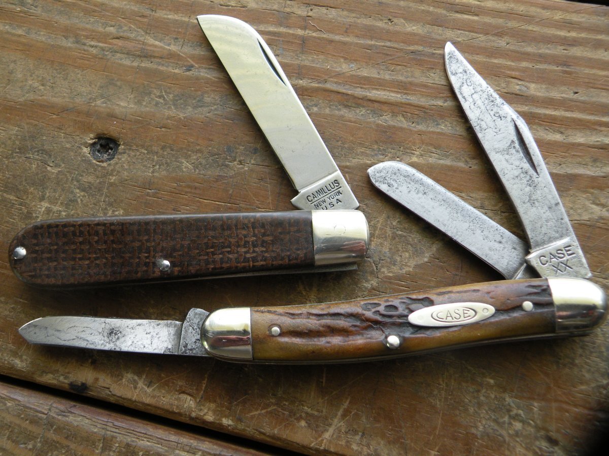

Sorry, here's a better pic of those two (from the mark side, and with clean hands). The scales on the single blade cammy were completely toast, so I replaced them with brown burlap micarta and gave the knife the full treatment and now it snaps like the devil! ::ds::

herbva wrote: Thu Apr 09, 2026 6:38 pm Sorry, here's a better pic of those two (from the mark side, and with clean hands). The scales on the single blade cammy were completely toast, so I replaced them with brown burlap micarta and gave the knife the full treatment and now it snaps like the devil! ::ds::
Thats really nice! If you ever want to sell the camillus let me know.

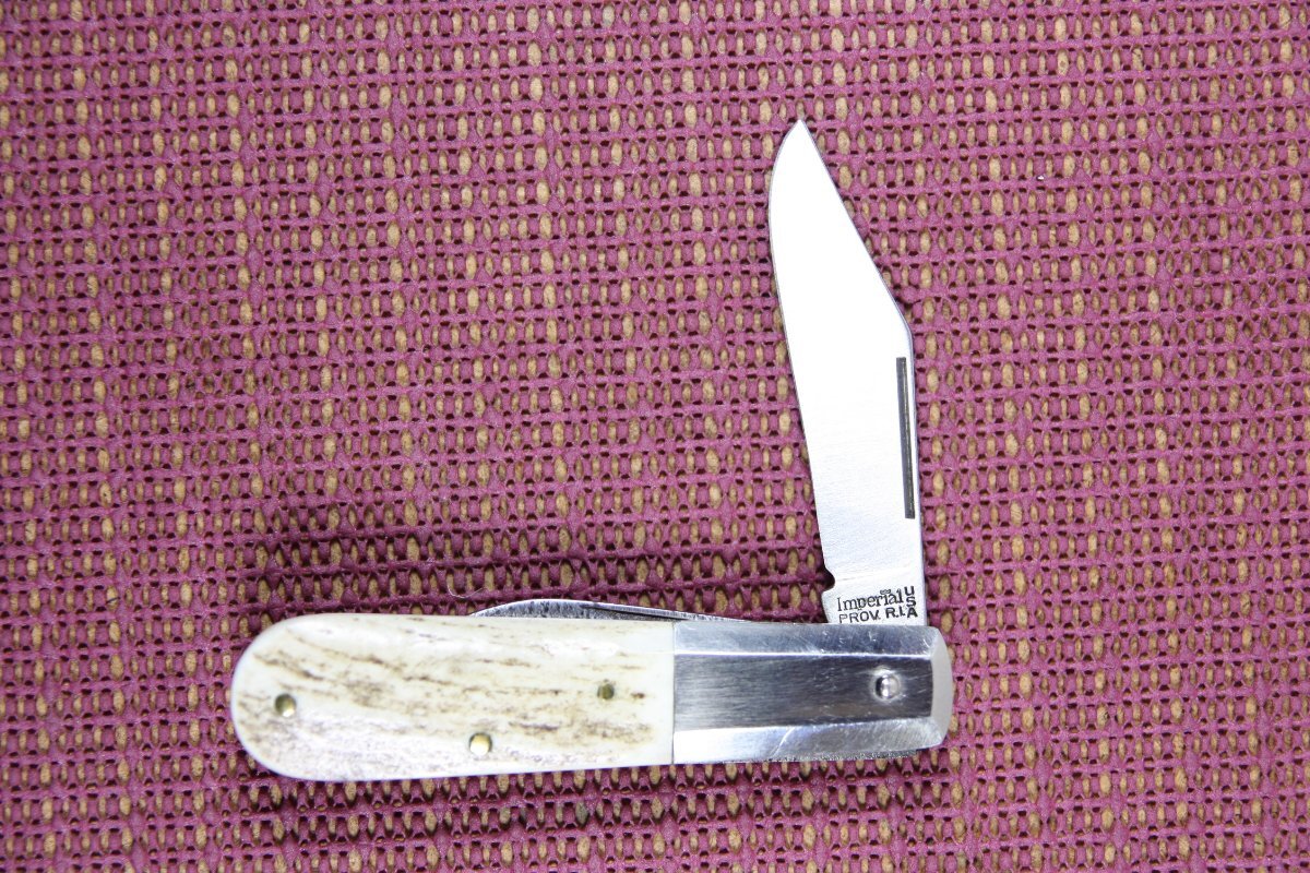

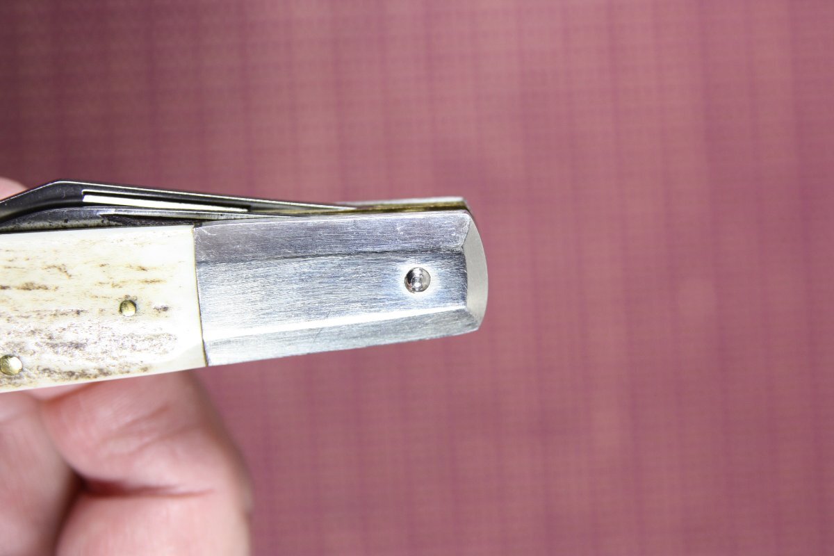

Pivot pins can also be domed, as I did on this custom Imperial Barlow.

OLDE CUTLER wrote: Fri Apr 10, 2026 5:46 pm Pivot pins can also be domed, as I did on this custom Imperial Barlow.
Sweet!!

Posts: 23928
Re: Domed pin
Great work O C
