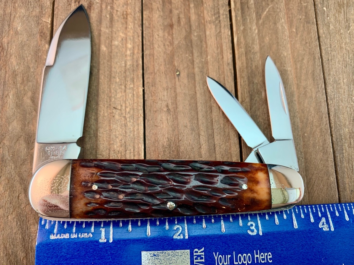

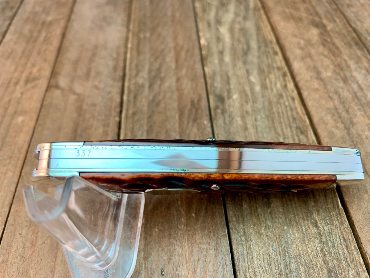

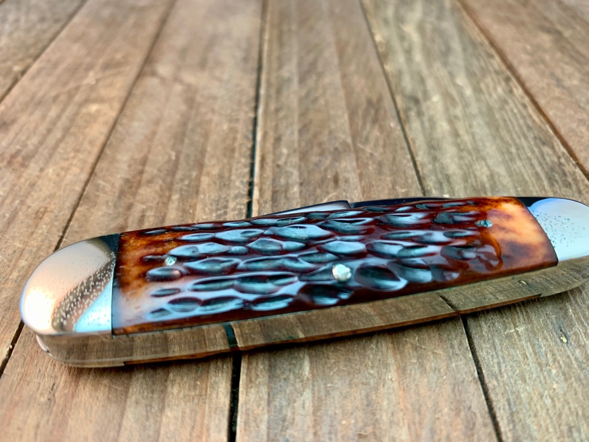

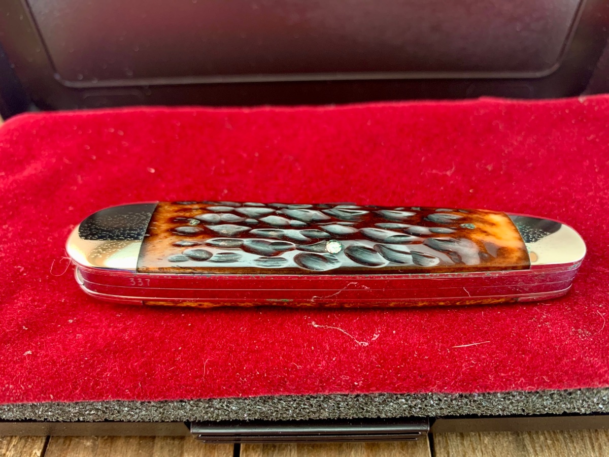

I got this Cattaraugus whittler the other day. It was listed as new but it was damaged. This knife had sat in this A.G. Russell clamshell display case for almost 30 years. There was a cutout in the red velvet for the knife and it was resting on foam rubber. As you can see in the pictures, the foam rubber is breaking down and it pitted the bolsters lying on it and pitted the liners that it was touching. I have encountered this before with A.G. Russell knives from 30 years ago but I wasn’t able to figure out what had caused it since those other knives did not have a box or clamshell case when I bought them. They must have been stored against foam rubber also.
Since this happened I went searching through my display cases to make sure there was no foam rubber in them. I discovered that the last 4 cases I bought from a collector have foam rubber that the knives rest against. You can bet I am replacing that foam rubber with something else ASAP.
Coincidentally the next day after I got this knife, I got another A.G. Russell knife in the same kind of clamshell case and the foam rubber had turned to dust, fortunately the foam rubber was not in contact with the knife.
Just a word of caution about display cases.
Any suggestions as to the best material to have in a display case would be appreciated.

Too Bad, Mark, but they should polish out ok. Good luck. J.O'.

It’s already in the hands of a new owner who has polished them out and made it look brand new. Good to know there are people around who do that. Wish I could do that myself. I wonder how bad this would look in 30 more years, or even 10 years?Ridgegrass wrote: ↑Thu Apr 16, 2026 6:46 pm Too Bad, Mark, but they should polish out ok. Good luck. J.O'.

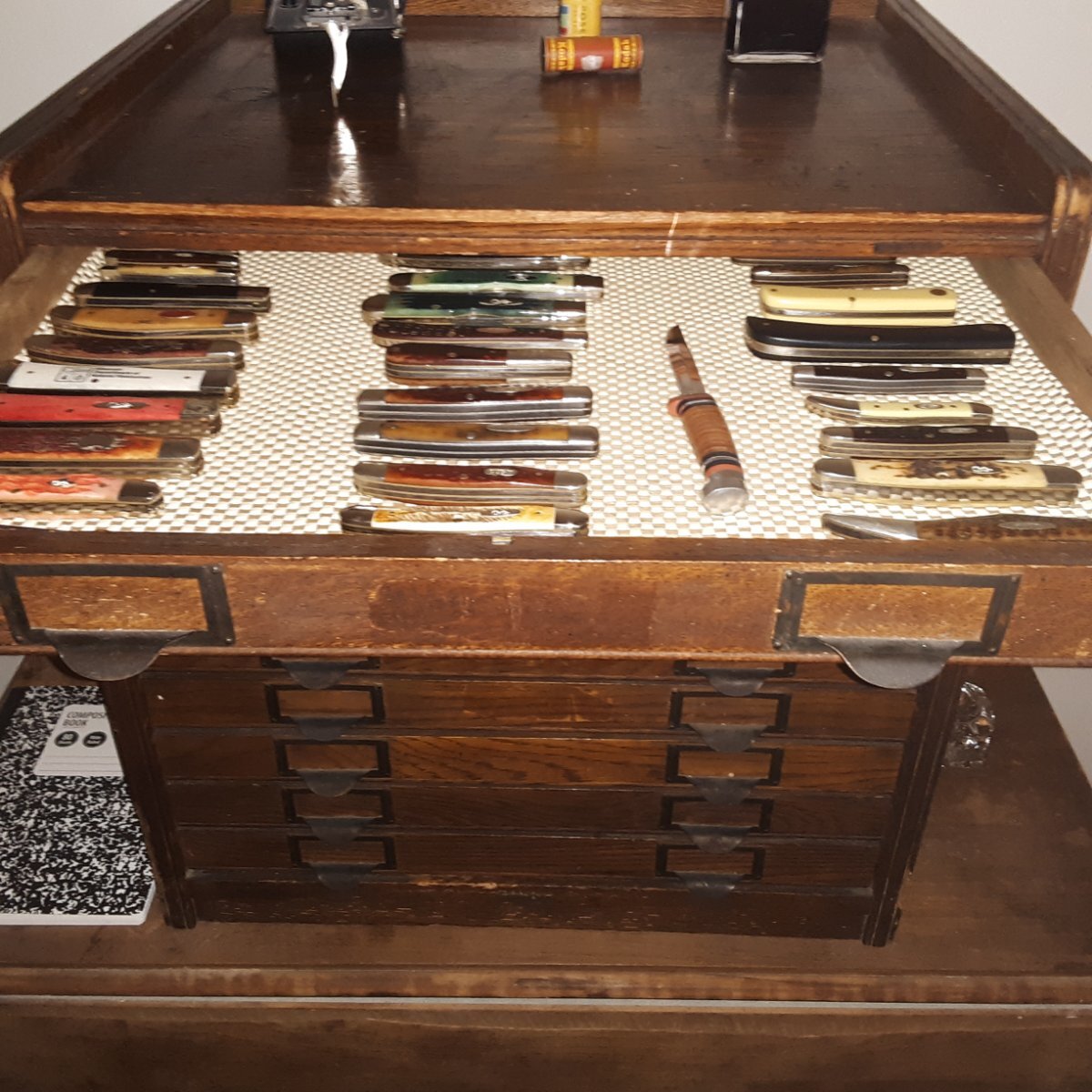

Ken, I also have an Antique Oak Typsetter Cabinet and I lined the drawers with rug backing (the stuff you buy at Menards) and so far no problems. I just got it lined though and dont really know enough yet about it. But it may be an idea for you. I'd hate to tell you wrong though.Mumbleypeg wrote: ↑Thu Apr 16, 2026 9:21 pm Mark I feel for you. I have experienced the same problem you’ve described with foam, elastic, and knife rolls (Hickory Hills which are reputed to be the best). Some of mine were even pitted to the point they could not be buffed out. As long-time collectors we learn the hard way after years of storage, when one day upon periodic inspection we find our collections have been damaged. Who knows what triggers it?

Hey Ken, the rug backing is what I used to line my drawers.Mumbleypeg wrote: ↑Fri Apr 17, 2026 3:47 am It just occurred to me that the solution depends on what is meant by “display”. I said that Sackups aren’t really displays. When in the Sackups roll the knives aren’t visible. But they aren’t visible when in a clamshell either, unless the lid is left open.
