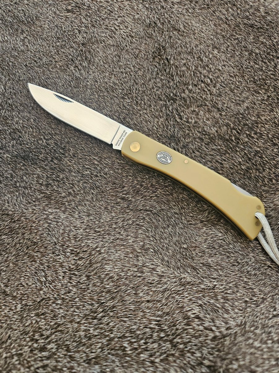

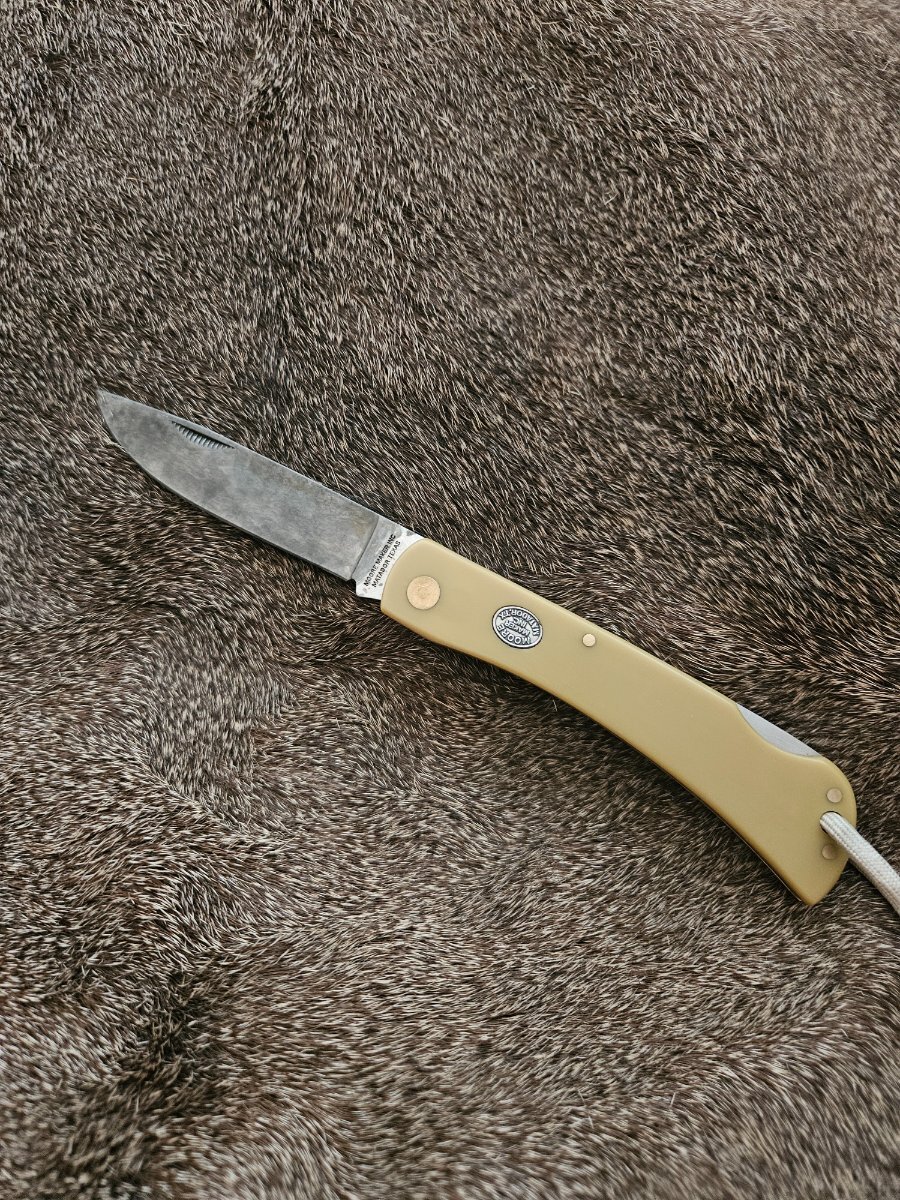

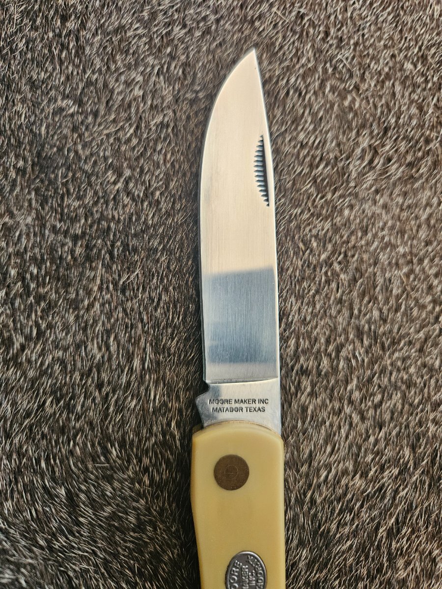

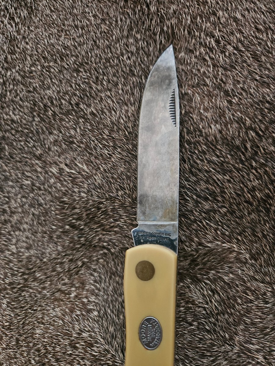

I picked up this Moore Maker 3103LBB locking Sodbuster as a working knife. I usually carry it as a secondary knife to my main pocket-clip EDC, but sometimes as a primary EDC; it's carried in a sheath most of the time.
The knife came with a 1095 blade that was sharp and shiny, but I longed for that aged look. So yesterday, I added patina to the knife. Here is the routine I used and the results.
1. Cleaned blade with alcohol to remove oils, etc.
2. Insert blade into a Blood Orange fresh off the tree.
3. Every 20 minutes, remove blade and reinsert into the blood orange.
4. Total time in the orange was 1 hour.
5. Insert blade into a lime.
6. Every 15 minutes, remove blade and reinsert into the lime.
7. Total time in the lime, 45 minutes.
8. Using a Q-Tip dipped in white vinegar, rub blade vigorously. Let sit 2-3 minutes.
9. Repeat Q-Tip dipped in white vinegar with a new Q-Tip. Let sit 2-3 minutes.
10. Rinse with water.
11. Neutralize acid by submerging the knife in a water-baking soda mix.
12. Rinse with water.
13. Recoat knife metals with Pam cooking spray.
Here are the before and after pics:

- Jeepergeo
- Posts: 431
- Joined: Mon Dec 12, 2022 2:29 pm
Re: Moore Maker 3103LBB - Before and After Patina
I'm happy with the results and the experimental process.
