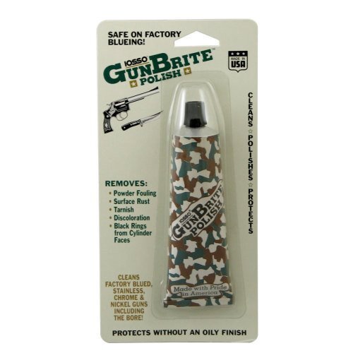

Just like the knives we collect, everyone has their brand. For the quick clean, I too use Mothers mag Wheel polish. It's inexpensive and comes in a tub.
But for my treasures, I use GunBrite. It comes in a cammo tube about the size of toothpaste, has a mild oder, but nothing offensive. Because it is formulated for guns, it removes all kinds of debris and oxidation. It cleans and protects against fingerprinting, moisture, and leaves a polished finish without an oily finish. GunBrite also does not contain silicon or waxes.
At $6.99 - $8.99 (depending on where you purchase it) It's not that expensive, unless you use it often. Then Mother's is the better value.
