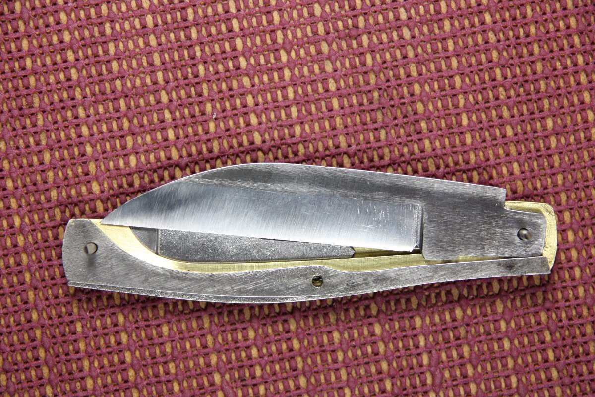

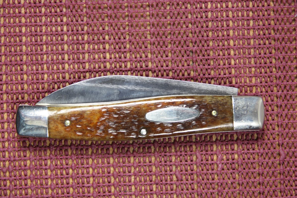

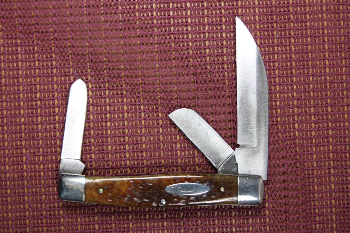

I have always had a great fondness for the Case 75 series, whether it be the large stockman or moose pattern. So when I received my POS box from Cody (cody6268) and saw that it contained a Case 6375 that had the master clip blade broken off, I started to think about what I may do with it. I considered going with an original clip blade, a spear blade made from bar stock, or the way it eventually turned out, a Wharncliffe blade made from 1095 bar stock. The knife has the most gorgeous pocket worn bone, worn and polished to the point where the shield is almost bare. I have done other stockman knives with hand made Wharncliffe replacement blades, and try to get the biggest blade in the frame as I can. This makes the blade sit up with the tip just making it into the blade well. Because the blade sits up in the frame, no nail nick is needed, just pinch and pull. It is back in my pocket now as a EDC.
Thanks Cody

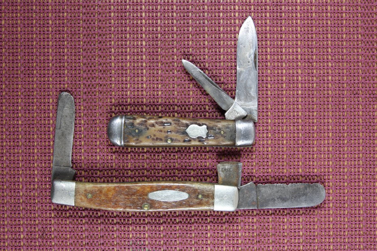

Master blade was broken, both the sheepsfoot and spay needed reprofiling (bottom knife in picture) taken before.

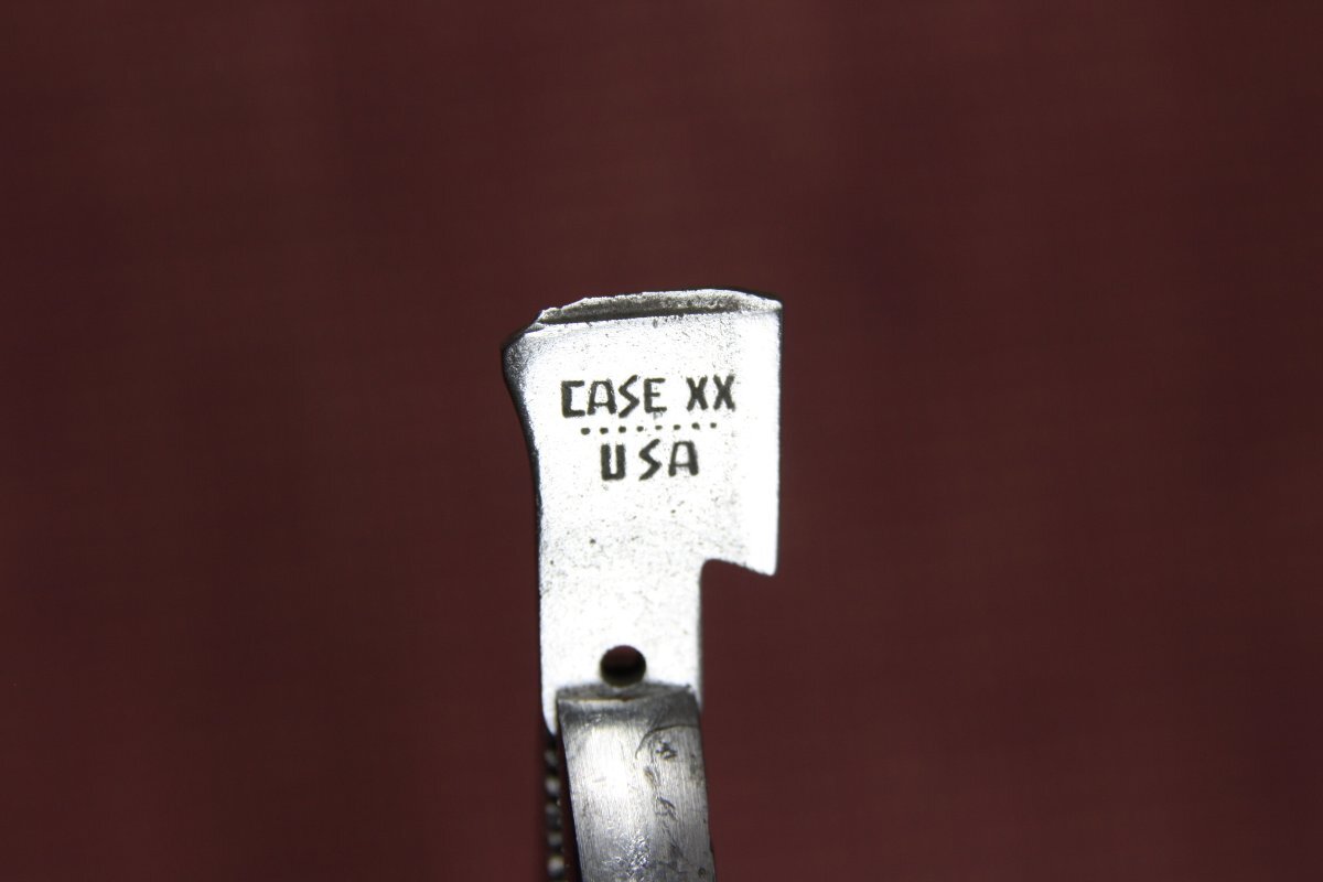

Tang shows 8 dot 1982 date.
Open view shows how Wharncliffe is fitted into blade well where a clip once lived.
