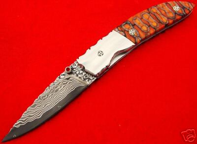

There are a bunch that buy blades assemble a knife and claim they did everything. Premium knife supply sells tha linerlock http://cgi.ebay.com/Knife-Blanks-Blade- ... m153.l1262 and one guy sold one as a custom he built for $635.00. It is the last knife on this auction. But if you look at the liner lock, he did not take it apatr. It came assembled and he did the file work through both the liner and backsping. He likely made $500.00 and spent 5 hours on it. ::td::

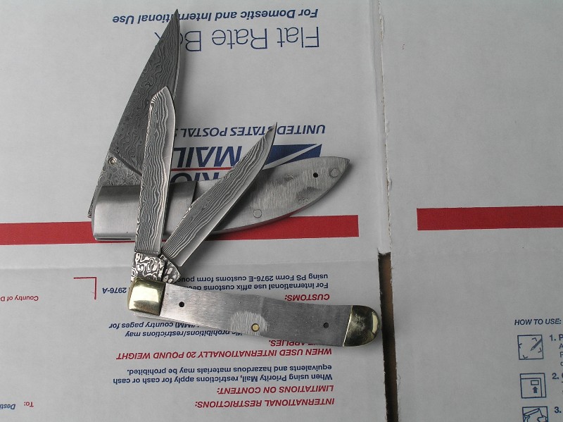

There is a whole bunch of phonies out there - be careful buying custom knives! The knife below is the example I'm speaking of. There are dozens similar to this!

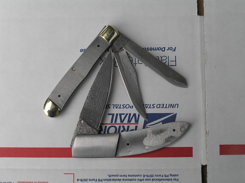

Here are a couple pictures of blades that Premium Knife Supplies sells. The buyers buy them and from what I see lately are claiming that they built the whole darn thing. One of the liner locks went for $635.00 and all he did was to do a little filework and use a lot of mammoth tooth. Not bad for an original cash outlay of about $90.00. ::disgust::
Here they are:
The liner lock has a real rough open/close.

Noticed the picture of the 2 blade. Just put some scales on one just like it and wonder your opinion of the quality. Mine seems to be just fine and happy with the result. Posted under "cordia and silver" custom factory knives forum.

The trapper is much nicer than the liner lock. The liner lock will be set aside so that when I have time, I will take it apart and modify it a lot. I like my OKAPI a whole lot better than the liner lock, I was dissapointed that it was so rough, I can't understand why some buyer would pay $635 and leave a positive. Just a piece of mammoth tooth on it and file work that went thorough both the liner and spacer - tells me someone could not take it apart. :lol: :lol:
