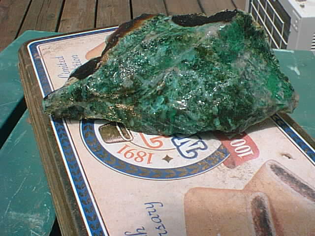

Nice! I like malachite, I have enough for several knives but it is from the Congo and CHEAP, some I have coming was $10 a LB.
That sure is a nice lump of Malachite, I also got about 4 LBS of Jet in the mail. Jet is gem grade coal and it will burn.
How much does that Malachite weigh? Looks to be a healthy chunk!

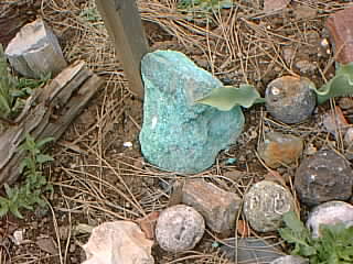

i grew up on top of a copper mine in arizona...i have to admit i am spoiled...in the winter i have this abandoned strip mine i go wander about and find some purties...
