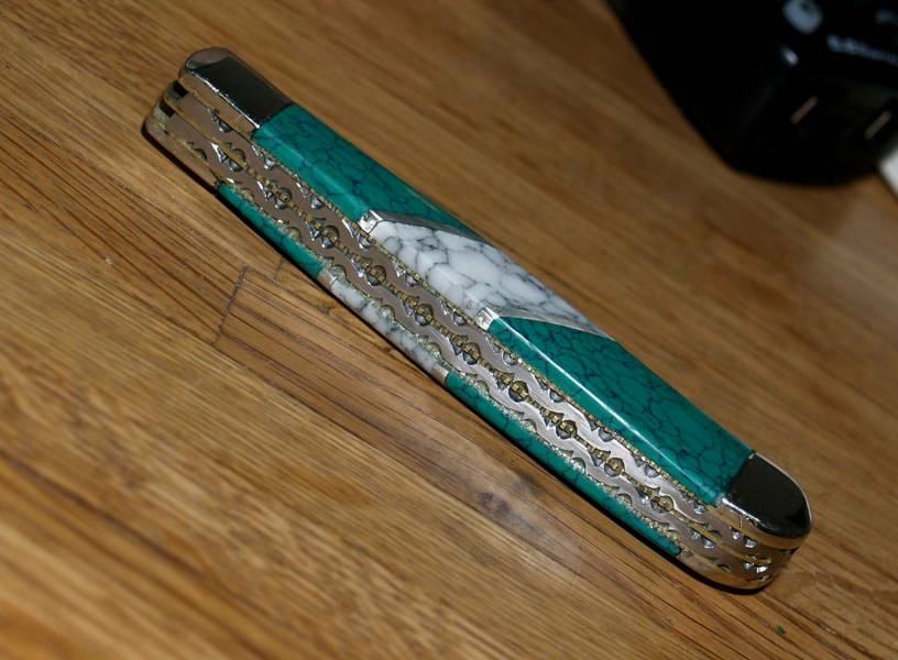

This project had me wondering if I could do anything with it. It's not so bad that I'll throw it away but I sure had to work my old wrinkled xxxx off. Probably got 30 hrs in it and still see several more to make it better.

very nice, great alignment on your file work.

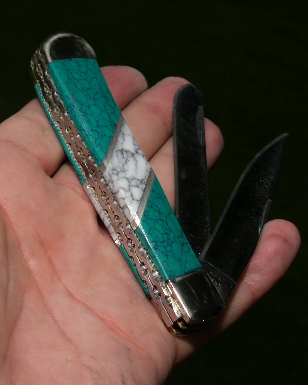

thank you Sir, better pic

Thx MM. Now comes the part I really like. Getting the thing under a scope and really getting down to the details, all scratches and spots that aren't seen at first glance. This is what makes me feel I have done a good job. Of course your compliments add to my pride. This was my hardest project to date. Can't wait to see what is in store tomorrow.
