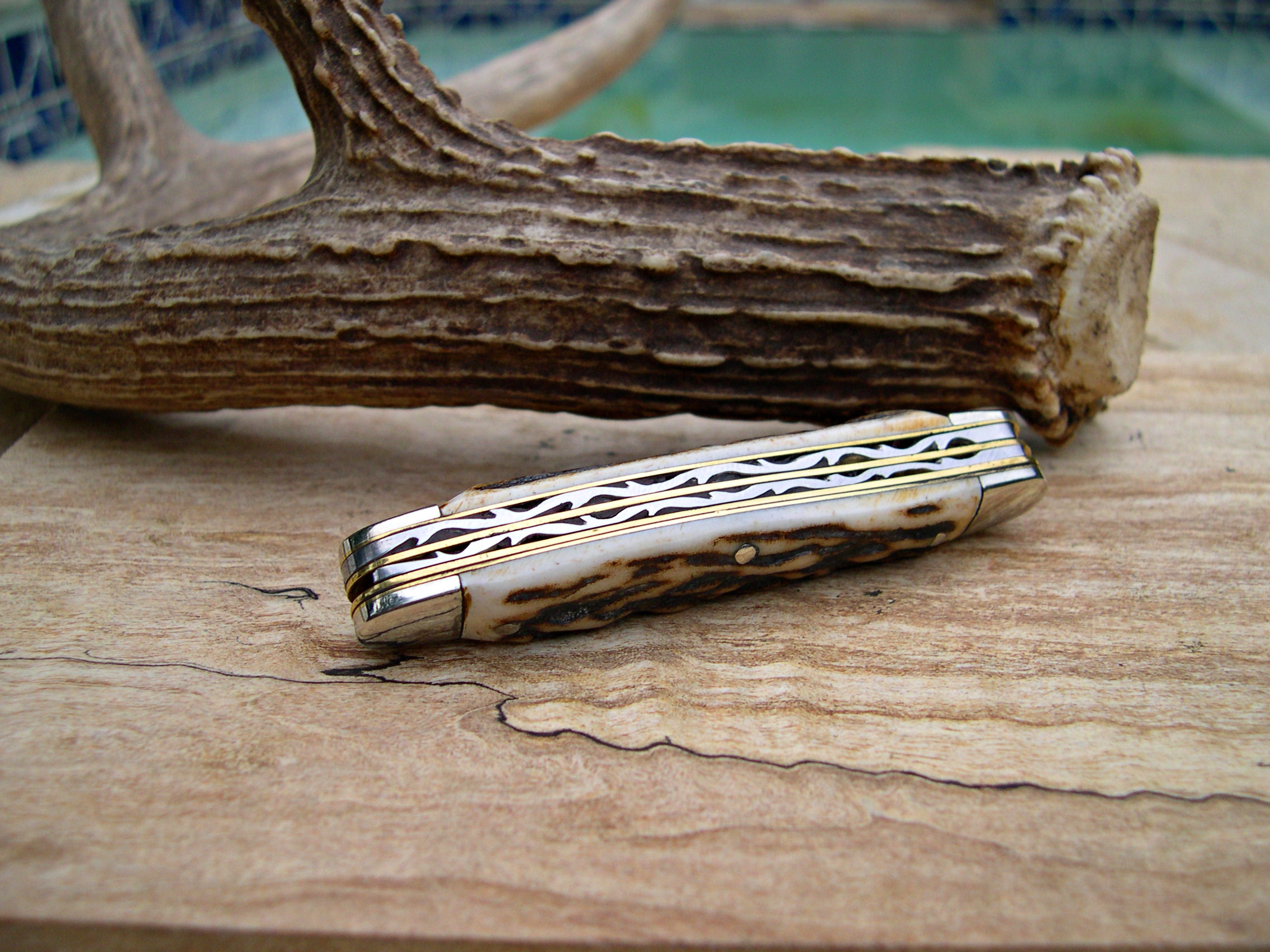

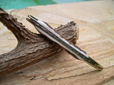

My filework still has a mind of it's own. My respect for others great fit & finish is growing with each of these.

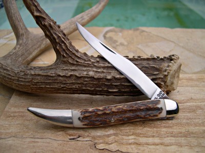

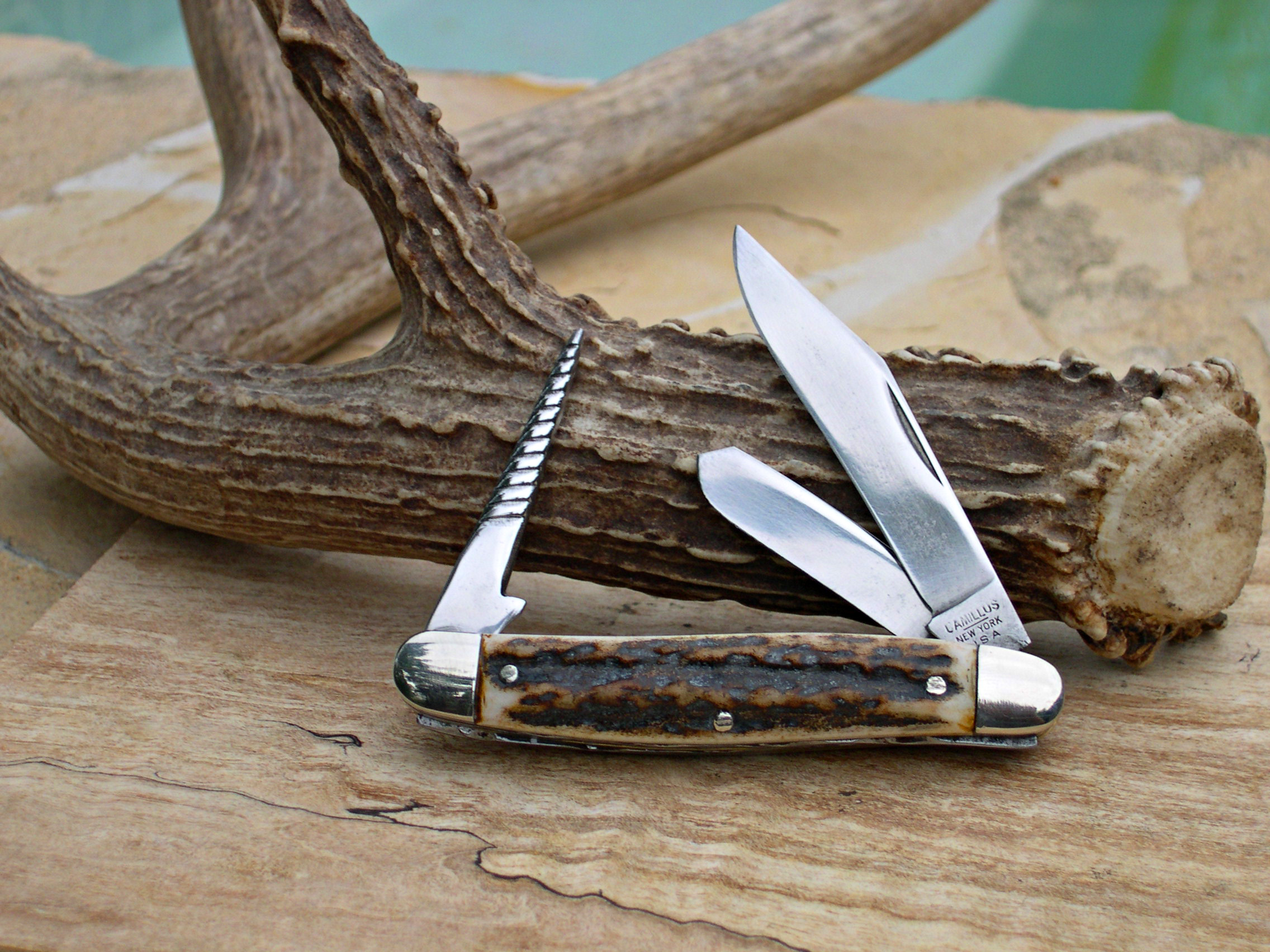

The first KutMaster I did a month ago -with carbon steel blades- is popping out all over with new corrosion spots. It was very dark with pits before I sanded and polished it up. Can that be stopped or discouraged? I didn't coat the blades with anything, however I did last use simichrome on them last. Is that just the way it is with these 50 year old carbon steel knives or how can I stop it? The stainless steel KaBar seems to be no problem, but this Camillus 2 weeks after the buffer is also starting to spot. I'm going to give these as gifts, do I need to also include lifetime buffing? Thanks again Marvin
