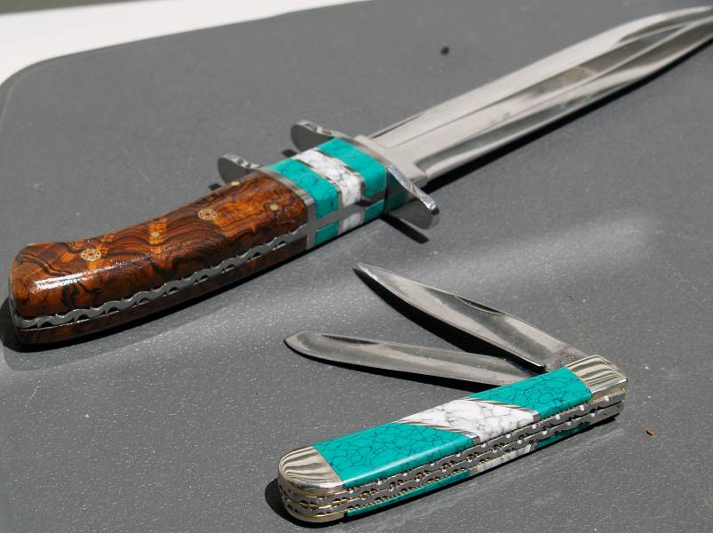

Just finished this Cheyenne booie to more or less match the trapper from last week.

Very nice, I sure like that Desert Ironwood, it does set off the inlay quite nicely.

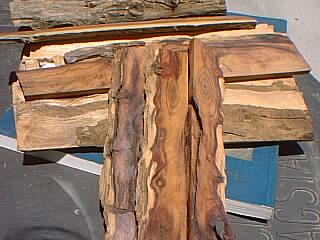

...ironwood and torquoise are an old time favorite of mine....i have a pile of ironwood slabs i just cut...mixed blond and coffee colors all intermingled....now if i can just get my shop set back up...moving is no fun.

Yes, that is recond malachite, wht turquoise, nickle silver spacers and Desert Iron wood. The blade was so rough when I got it that I almost sent it back. Foolishly, I thought I could maybe polish it and not have to spend much time doing so. I worked my old fat butt off for 7 hrs and still am not real happy. End product is acceptable but a lot of hrs. Really like that iron wood and the recond is great to work with. Oh well maybe when I see the "tutorial on mop" (hint, hint hint) I'll find another obsession. Thx for the generous comments.
