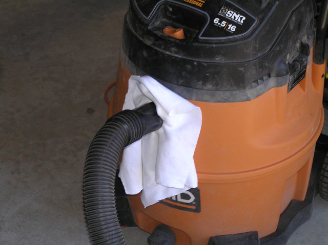

Well first I need to collect something to fill the cracks, so I will place a cloth as a filter in my vacuum line - between the exhaust port of the 4 x 36 sander and the big shop vac I have.

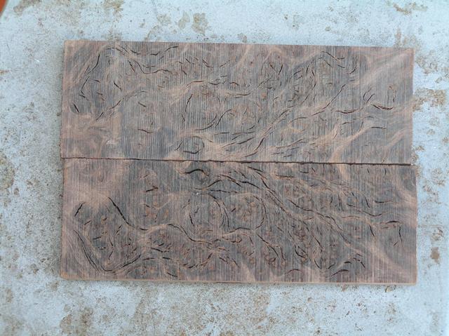

Stabilized Old Growth Redwood LACE BURL just cut by my bandsaw and of course - bookmatched!

Cloth used as a filter to catch redwood burl dust, my biggest port is at the hose input of the vacuum.
Exhaust Port of the 4 x 36 and it sure keeps the dust down if it is used! I ALWAYS use a dust collection system. I use a shop vac (boy its a big one - draws 12.5 amps) but a dust collection system can be had for as little as $200 and a little less.

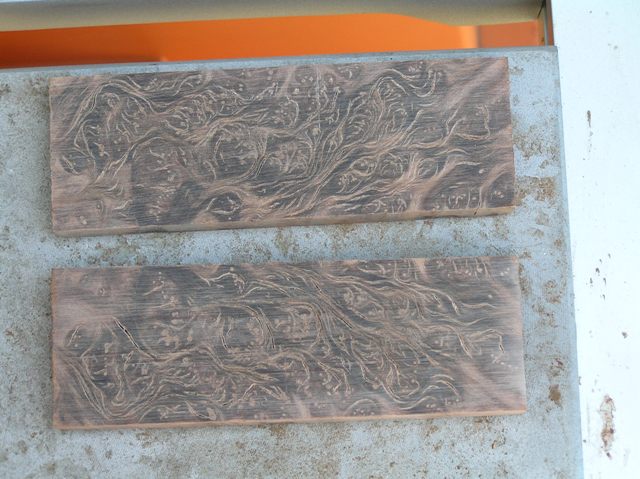

By Golly, if sanding down the saw cut marks can make it look this good I have a chance of making this look......STUNNING! Compare with the first picture!

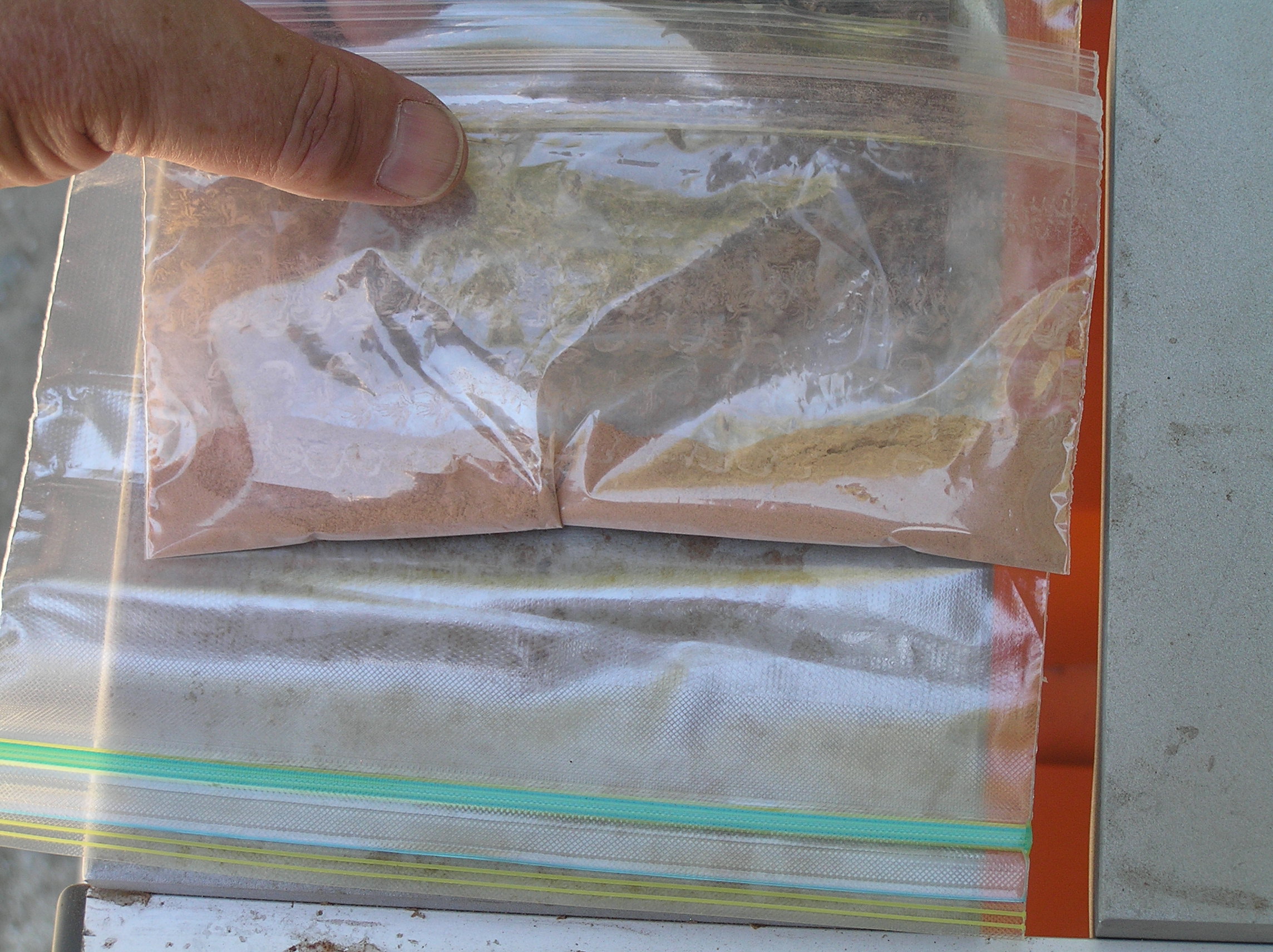

I emptied the dust cloth at the vacuum 4 times to collect enough dust to use as filler material later on. I will mix it with a thin epoxy or a Cyanoacrylate that does not dry real fast to fill all the cracks in the wood. The end result should look similar to the sanded scales.

Thanks, thats a trick I've been using for years. The T-Shirt material I have in there is a bit thick because that's a very powerful shop vac, one less powerful I would use thinner material.
What I'm trying to do is capture the finest wood dust because with that shirt in there the vacuum suction is very weak. So, I'm capturing the smallest particles - the dust particles that are fine enough to fit into the smallest cracks of that wood. The dust I'm capturing will match the wood 100% when mixed with an adhesive - years ago they used laquer and mixed it with sawdust. Primarily it's a trick from furniture makers. Well, whatever works - then try and improve it. :mrgreen:
The dust I have collected in that bag is actually very powdery - very fine particles and I know it's actually finer than I need, but thats OK! ::tu::
