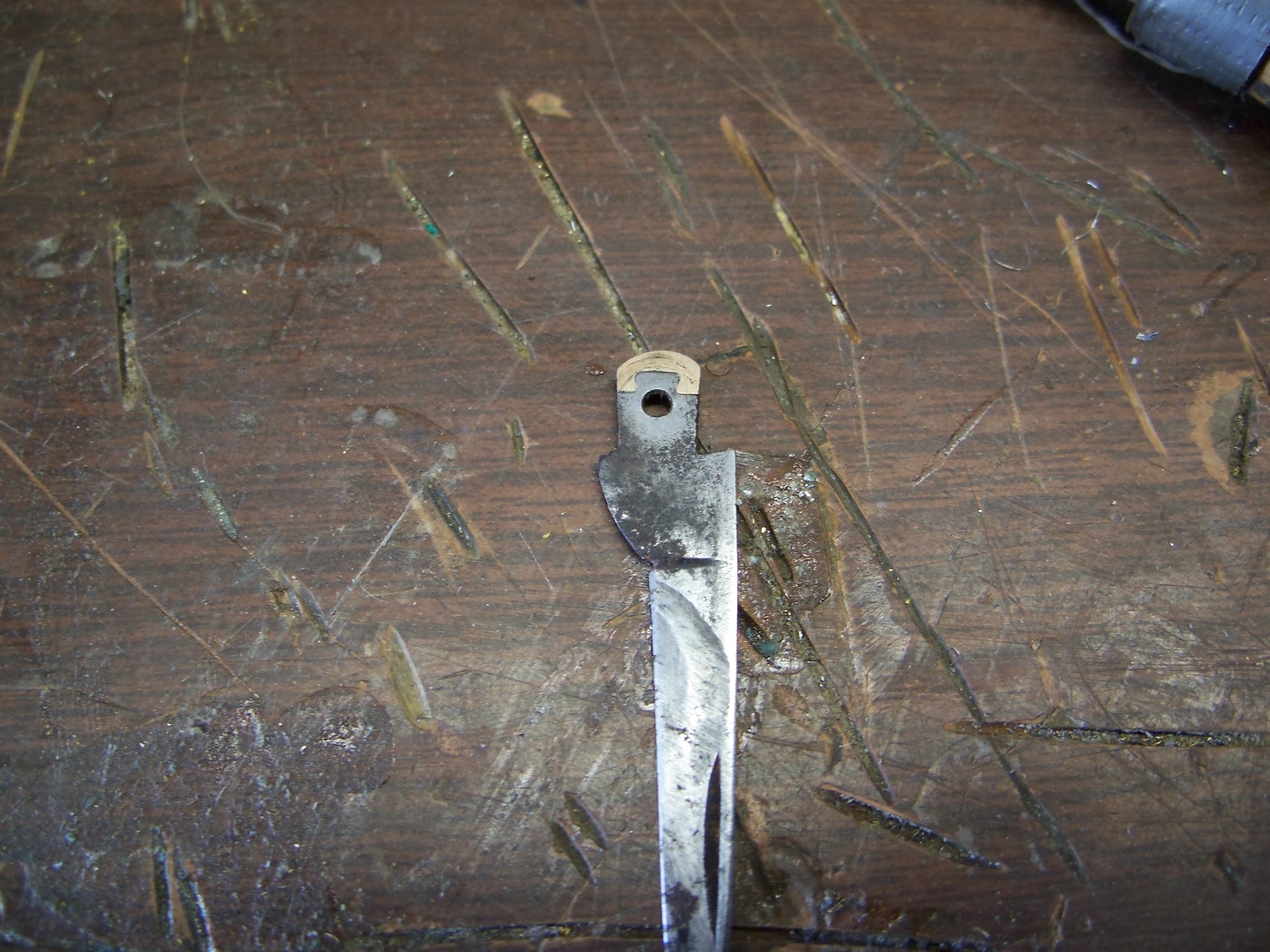

Re: Brass tang inserts?
went to that link Johnnie and found this pic along with these few words, "Detail of Bronze Bearing on the tang end of MasterCraft Knives" guess that is factory then, amazing!
- Attachments
- 25-MCBearing.jpg (37.91 KiB) Viewed 3698 times

Here is something I fond on that site about the bronze bearings;
"MasterCraft knives have a bronze bearing on the ends of the blade tangs that bear on the backsprings. They open and close easily. The master blades are usually etched, "Nev-R-Bind Oiless Bearings" in a waving banner."
Neat old stuff!
Neat old stuff!

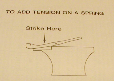

this is from adrian a. harris' "knife repair & restoration"
- Attachments
- backspring.jpg (26.42 KiB) Viewed 2866 times
johnnie f 1949

johnnie pretty much summed it up. no heat is used, and the knife must be disassembled for the procedure. a cross pein hammer is the best hammer to use so it puts a sharp bend in the spring, however I find it much easier and more effective to strike the spring just in front of the rocker hole. striking it between the rocker and butt pins shortens the sprinng too much sometimes and the pins will no longer line up. Striking it just ahead of the rocker hole will bend the spring and put more tension on the blade whilst not altering the distance between the two holes.Be especially careful with german made knives as thier springs are sometimes harder than american or english made knives and are more likely to snap, thin and/or narrow springs require special care also so you don't snap the spring by accident.
