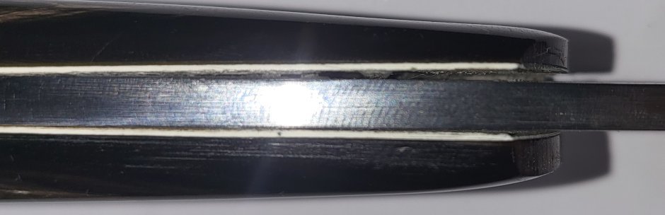

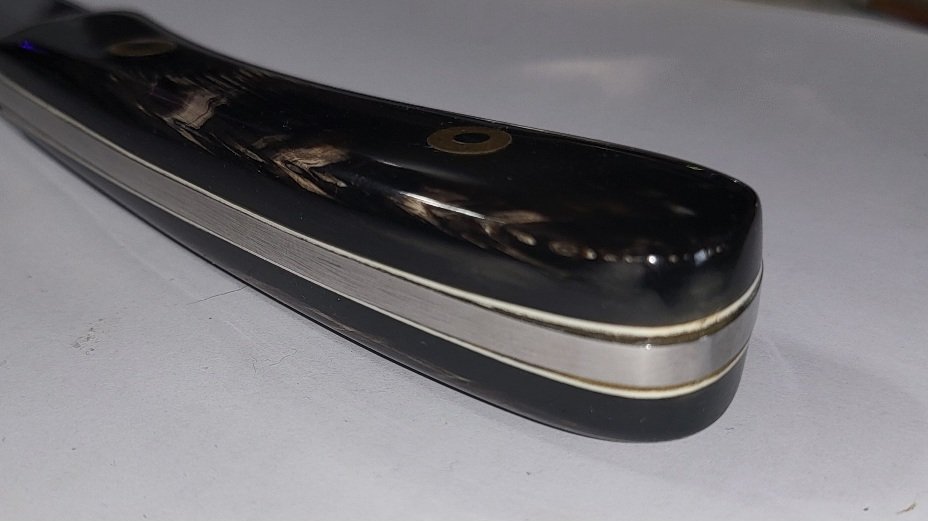

I got this knife at a gun show a year or two ago and I haven't been able to get a hold of the maker for a fix.
As shown in the photos, the scales are separating or spaced a bit from the tang. How should I go about fixing this?

What is the handle material and how is it attached to the knife?

Kolvir, from you pictures, it looks like the pivot pin needs tightening, or perhaps has pulled loose through the liner and the scale or scales. As a first step, try tightening the pivot pin by lightly re-peening the head of the pin on whatever side is loose, or both sides. But, be careful not to over tighten, or it will bind the blade tang, and then it will have no snap. If this doesn't work, you will need to replace the pivot pin. Since there are no bolsters, this is a bit more delicate, but not difficult operation.

Is that buffalo? If so it may be warping in the ends. Hard to say without a bit more info.

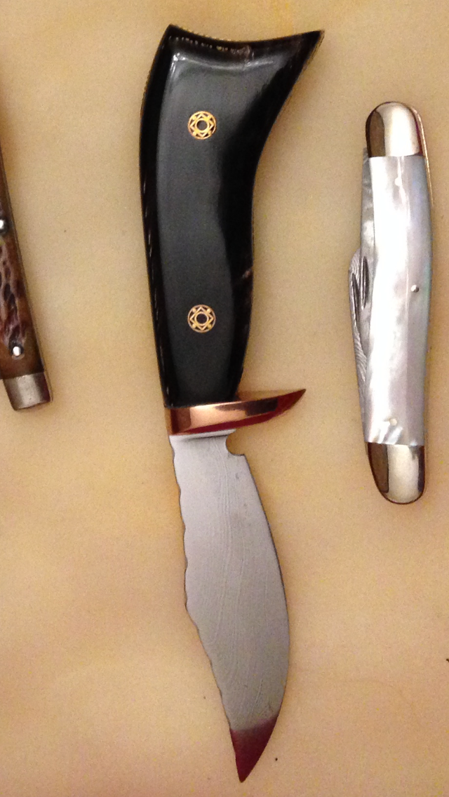

That’s what I was gonna ask Eric. I’ve had Buffalo horn warp on 1 side of a fixed blade and had to take it off, clean it up, sand and drill small holes at different angles into the horn. Then pin and glued with automotive panel bond. She ain’t budgin now by gosh!! Here is a pic after repair!

It appears to be a Micarta handle that was simply epoxied on the knife.
This is why you should always use mechanical fasteners-and I don't mean pins that are glued in.
There are many choices, including simple peened pins.

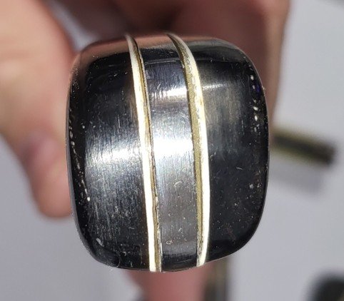

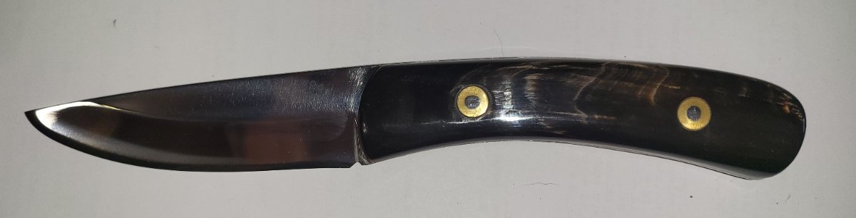

Here are some more pictures. Sorry it took so long, had a medical procedure yesterday and the anesthesia left me groggy; slept all day.
Do I need some kind of glue or epoxy to fix this?

It may very well be some kind of horn

That looks like a well made and mounted handle. I would guess that the horn is warping and that glue is probably not going to hold it down over the long term.

It is horn, and it is warping. Horn can be straightened with heat, but it tends to move again.
What I would do with it is drill it and install a lanyard loop to hold it down.

I am not Bill, but yes, horn is more prone to warping. Bone and stag are thick and normally cut into flat slabs that rarely ever warp. Horn is thin and curved, and is often heated (steamed or boiled) and pressed flat to use as knife handles. Sometimes they try to warp back to their original shape later.
