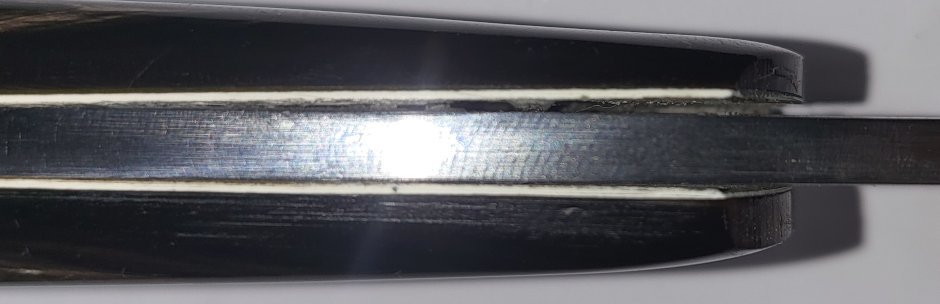

I got this knife at a gun show a year or two ago and I haven't been able to get a hold of the maker for a fix.
As shown in the photos, the scales are separating or spaced a bit from the tang. How should I go about fixing this?

What is the handle material and how is it attached to the knife?

Kolvir, from you pictures, it looks like the pivot pin needs tightening, or perhaps has pulled loose through the liner and the scale or scales. As a first step, try tightening the pivot pin by lightly re-peening the head of the pin on whatever side is loose, or both sides. But, be careful not to over tighten, or it will bind the blade tang, and then it will have no snap. If this doesn't work, you will need to replace the pivot pin. Since there are no bolsters, this is a bit more delicate, but not difficult operation.

Is that buffalo? If so it may be warping in the ends. Hard to say without a bit more info.

That’s what I was gonna ask Eric. I’ve had Buffalo horn warp on 1 side of a fixed blade and had to take it off, clean it up, sand and drill small holes at different angles into the horn. Then pin and glued with automotive panel bond. She ain’t budgin now by gosh!! Here is a pic after repair!

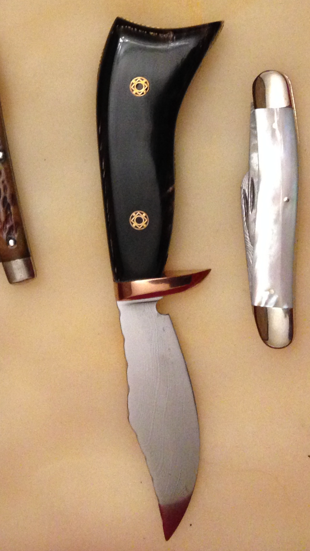

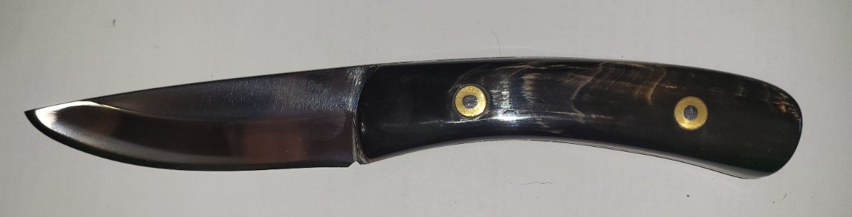

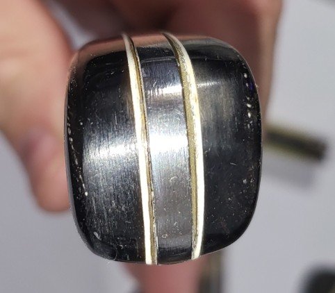

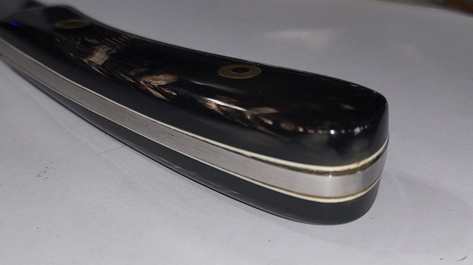

Here are some more pictures. Sorry it took so long, had a medical procedure yesterday and the anesthesia left me groggy; slept all day.
Do I need some kind of glue or epoxy to fix this?

That looks like a well made and mounted handle. I would guess that the horn is warping and that glue is probably not going to hold it down over the long term.

It is horn, and it is warping. Horn can be straightened with heat, but it tends to move again.
What I would do with it is drill it and install a lanyard loop to hold it down.

I am not Bill, but yes, horn is more prone to warping. Bone and stag are thick and normally cut into flat slabs that rarely ever warp. Horn is thin and curved, and is often heated (steamed or boiled) and pressed flat to use as knife handles. Sometimes they try to warp back to their original shape later.Dinadan wrote: ↑Wed Mar 15, 2023 11:30 pmI do not want to derail the OP's thread, but since I know you are an expert. Bill, I have a question. Is horn more prone to warping than bone or stag? I only have a couple of horn handled knives so I have not baseline of knowledge.Bill DeShivs wrote: ↑Wed Mar 15, 2023 10:40 pm It is horn, and it is warping. Horn can be straightened with heat, but it tends to move again.

Can you push it closed? How much force is required? If it is fairly easy to push it back, I’d dribble superglue in and clamp it over night.
Are those pins? Or decorations?
Was this a high dollar purchase from an established maker? Or just some guy at a show? For a bargain ? He may not have even made it. Obviously if he really made it and is still around he should see it and repair it. Its not like its frim 20 years ago
