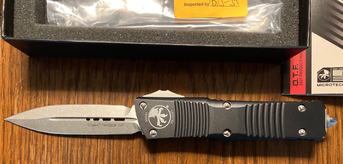

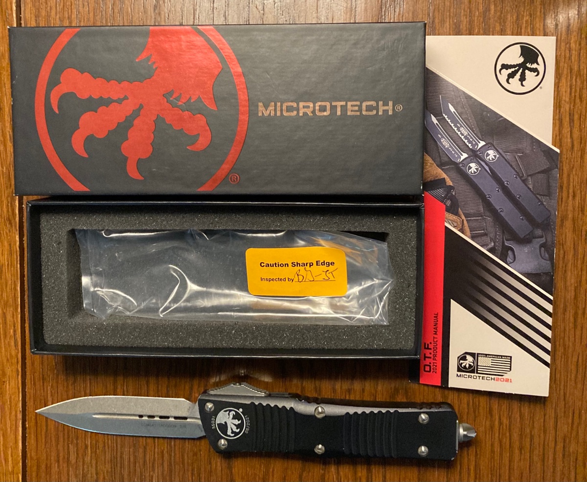

Should have posted pictures. I feel certain it's Microtech. Bought it from someone I have bought from before, retired military man, have no reason to doubt him
