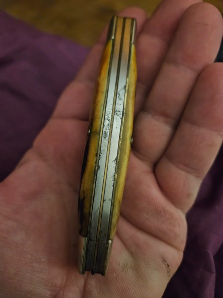

See my edited post - I’m unsure that it’s authentic. Would be good to get some others opinions. All of the stag large stockmans are high value but the 75s are the most valued. Sure tempting for a counterfeiter to put stag on one. Too bad they didn’t stamp pattern numbers on most Tested knives - that makes it easier for someone to put stag on a knife that originally had something else for covers. The inletting around the shield is a little sloppier than I’d expect to see. It doesn’t look like Tested era stag - looks like Sambar but hard to say from the pictures. Can you get a picture from top down showing the thickness of the handle covers?

Thanks. That’s what I was afraid of seeing. Tested stag is typically thin. Sambar is thicker, but in my experience Sambar was not used until around 1960s, in any case well after the Tested stamp was discontinued.
Sorry to say I think it’s not original, but that’s just my opinion. Would be good to get some other opinions. Maybe Steve Pfeiffer and Tom McCandless or other knowledgeable collectors will see this and give their thoughts.

Aside from what people have already shared about the shield and the stag, the contrast between the backs of the blades when in close position compared to the view of the knife showing the backsprings... the blades look brand new, while the springs look like an older knife? How about a close up of the tang stamp, that should reveal quite a bit. Its hard to see the stamp in your photos.
