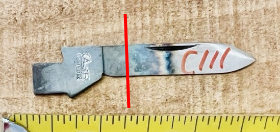

Could the temper line be a warning sign as well? I recently re-watched a video from the Case factory, they used an inductor to temper the tang, but the temper line was closer to the tang than on these fake blades (about the red line if I remember correctly)

Good question. I watched the process during a Case factory tour. I suspect what the video showed is the “de-tempering” of the tangs. Blades (tang stamps already applied) are tempered/hardened in batches, in ovens (as Case has done for decades). The blades are then placed into a fixture, where the tangs only are reheated to remove some of that hardening. The tang area of the blade needs the same approximate hardness as the spring, which it rubs against when operating in the assembled knife. (If the blade is harder than the spring it will wear the spring prematurely). That’s the current process - I don’t know how it was done during the TESTED XX era. Maybe similar, or not, but I doubt they used induction heating back then.desert.snake wrote: ↑Fri Mar 14, 2025 1:28 pm Could the temper line be a warning sign as well? I recently re-watched a video from the Case factory, they used an inductor to temper the tang, but the temper line was closer to the tang than on these fake blades (about the red line if I remember correctly)
As for the blades pictured in the seller’s eBay auctions, my thoughts on first seeing them, with the blue heat-lines, is that the blades were heated as part of the process of applying the stamps, in an attempt to soften the steel in the tang area before stamping them. That’s just a guess. Either way I question whether those are even Case blades. And as you’ve pointed out the heating appears to have been at least halfway up the blades, and well into the “using edge” area. Which pretty much ruins it for it’s intended purposes. Pretty far fetched that they would do that at a legitimate cutlery.

In the intro to Case's catalog #60 - about 1949 - first catalog after WWII - they highlighted their "new" induction annealer for annealing blade tangs.

Cool information! Thank youknifeaholic wrote: ↑Fri Mar 14, 2025 6:02 pm In the intro to Case's catalog #60 - about 1949 - first catalog after WWII - they highlighted their "new" induction annealer for annealing blade tangs.
I also wondered why they anneal the tails. The information about the wear of the spring is very interesting, thank you very much!Mumbleypeg wrote: ↑Fri Mar 14, 2025 2:36 pm
The blades are then placed into a fixture, where the tangs only are reheated to remove some of that hardening. The tang area of the blade needs the same approximate hardness as the spring, which it rubs against when operating in the assembled knife. (If the blade is harder than the spring it will wear the spring prematurely). That’s the current process - I don’t know how it was done during the TESTED XX era. Maybe similar, or not, but I doubt they used induction heating back then.![]()
As for the blades pictured in the seller’s eBay auctions, my thoughts on first seeing them, with the blue heat-lines, is that the blades were heated as part of the process of applying the stamps, in an attempt to soften the steel in the tang area before stamping them. That’s just a guess. Either way I question whether those are even Case blades. And as you’ve pointed out the heating appears to have been at least halfway up the blades, and well into the “using edge” area. Which pretty much ruins it for it’s intended purposes. Pretty far fetched that they would do that at a legitimate cutlery.![]()
I just looked on the internet, high frequency induction hardening is almost 100 years old, so it is likely that Case started using it because it is so effective. I see in the automotive industry it was used everywhere

I'm a big Landers, Frary & Clark collector and found this description from 1907 on hardening and tempering. "Hardening is effected by bringing it to a red heat and dipping it in water up to the choil. The tang is left soft so it may be readily filed, drilled, stamped, and fitted in the handle. Tempering is often accomplished by bringing the blades to a purple heat on a thin copper plate. The tempering room at LF&C was screened so the light was evenly diffused in daylight in order that the operators could easily judge the color of the metal. After the blades are hardened and tempered, they are tested and straightened. To test the blades for flaws, each one is thrown against a block of steel. Blades which do not ring true were rejected."desert.snake wrote: ↑Fri Mar 14, 2025 6:31 pmI just looked on the internet, high frequency induction hardening is almost 100 years old...
