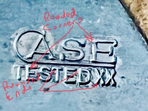

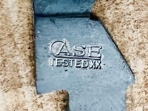

This ebay seller has listed a bunch of blades “for repair or replacement” which appear to be freshly cold stamped. Here is one of the listings - there are several more https://www.ebay.com/itm/116514305730?_ ... p_homepage
These are not legitimate original authentic Tested era blades. Note the rounded corners of the letters, the “mushy” appearance not found on authentic Tested stamps. Authentic stamps should appear “crisp” with sharply squared corners, and squared (not rounded) ends of letters.

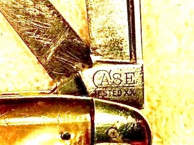

See bottom photo of an authentic stamp, for comparison.
Authentic Tested era stamp

This is worse fake Rolex’s and Hermes handbags because an accomplice is going to cobble these blades into a used knife frame and an unsuspecting buyer will start the circulation cycle. I say send them all to OLDE CUTLER to have their tangs drilled ::dang::

Yes, big potential for extended fraud. Same seller also has listed blades having supposed stamps from several other cutleries. I’m not as familiar with those companies’ stamps but in general the same principles apply to other stamps from that era.

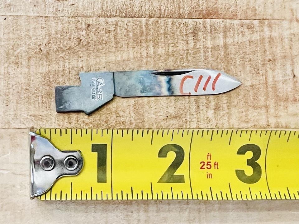

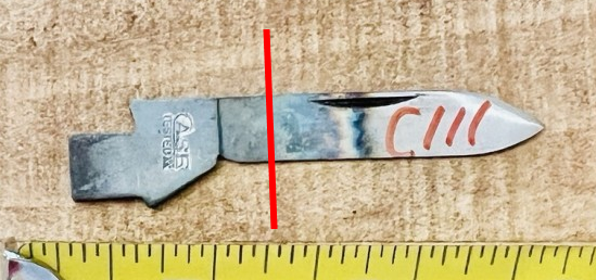

Could the temper line be a warning sign as well? I recently re-watched a video from the Case factory, they used an inductor to temper the tang, but the temper line was closer to the tang than on these fake blades (about the red line if I remember correctly)

Good question. I watched the process during a Case factory tour. I suspect what the video showed is the “de-tempering” of the tangs. Blades (tang stamps already applied) are tempered/hardened in batches, in ovens (as Case has done for decades). The blades are then placed into a fixture, where the tangs only are reheated to remove some of that hardening. The tang area of the blade needs the same approximate hardness as the spring, which it rubs against when operating in the assembled knife. (If the blade is harder than the spring it will wear the spring prematurely). That’s the current process - I don’t know how it was done during the TESTED XX era. Maybe similar, or not, but I doubt they used induction heating back then. ::shrug::
As for the blades pictured in the seller’s eBay auctions, my thoughts on first seeing them, with the blue heat-lines, is that the blades were heated as part of the process of applying the stamps, in an attempt to soften the steel in the tang area before stamping them. That’s just a guess. Either way I question whether those are even Case blades. And as you’ve pointed out the heating appears to have been at least halfway up the blades, and well into the “using edge” area. Which pretty much ruins it for it’s intended purposes. Pretty far fetched that they would do that at a legitimate cutlery. ::dang::

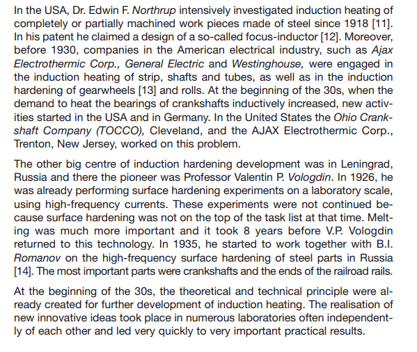

I just looked on the internet, high frequency induction hardening is almost 100 years old, so it is likely that Case started using it because it is so effective. I see in the automotive industry it was used everywhere
