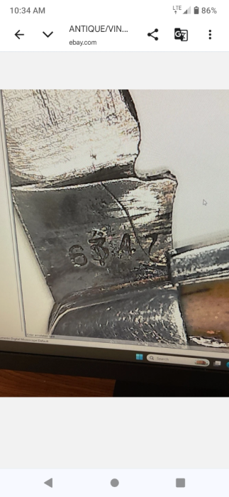

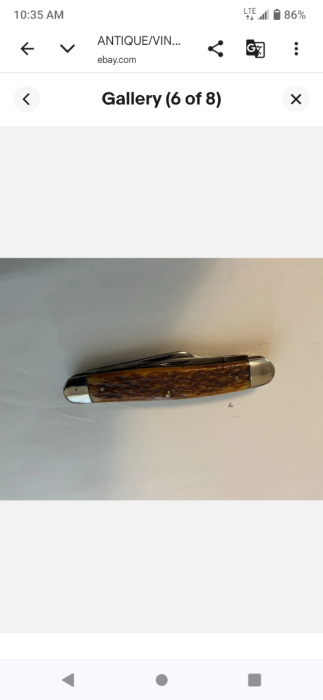

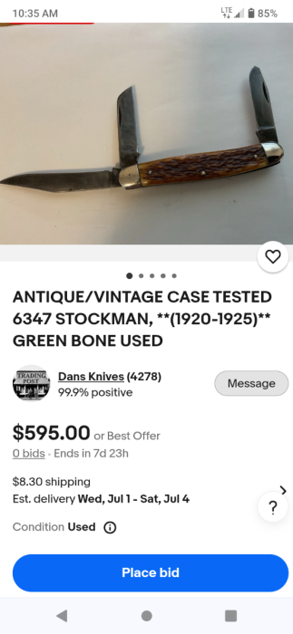

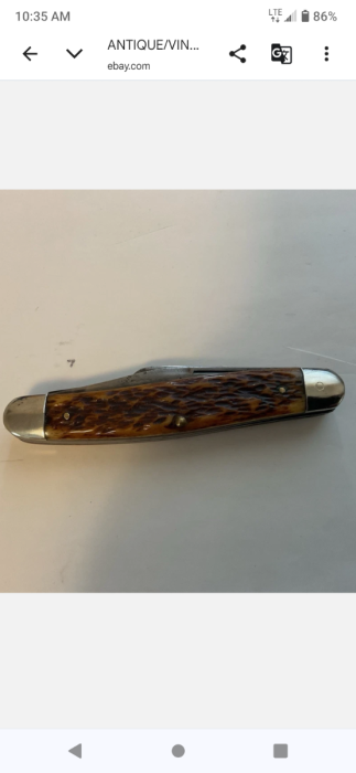

Watch out for this pos. I sent the store owner a message telling him it was counterfeit.

Good eye. Looks like another Kutmaster turned into a fake Case. Note the “humpbacked” spey blade. Not Case jigging. Case rarely put pattern numbers on Tested era knives - looks like someone stamped it one individual number at a time.

That "broken typewriter" tang stamping doesn't work on any knife except for an old Russell.

Yes sir, you're absolutely rightMumbleypeg wrote: ↑Sun Jun 21, 2026 8:25 pm Good eye. Looks like another Kutmaster turned into a fake Case. Note the “humpbacked” spey blade. Not Case jigging. Case rarely put pattern numbers on Tested era knives - looks like someone stamped it one individual number at a time.![]()

Right!1967redrider wrote: ↑Sun Jun 21, 2026 11:02 pm That "broken typewriter" tang stamping doesn't work on any knife except for an old Russell.![]()

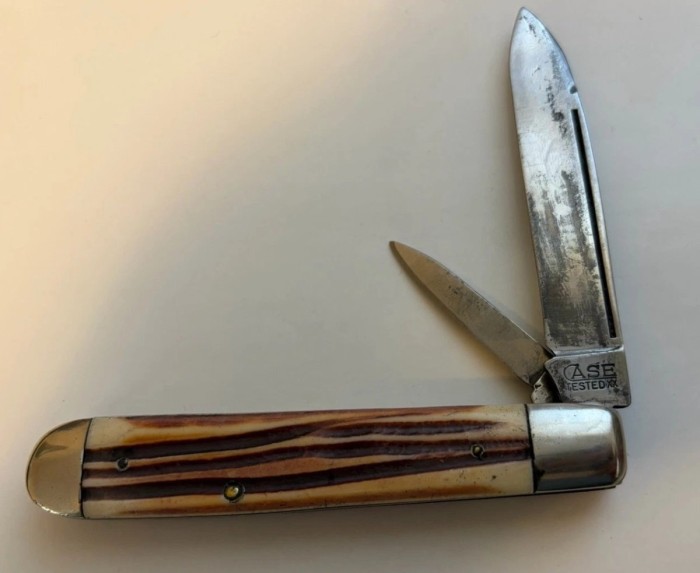

I'm afraid this is one of many eBay knife sellers that doesn't know a lot about knives. This same seller had this terrible, newer Queen #28 pattern jack with imitation winterbottom bone and a fake Case tested blade installed. The knife was priced at $800. Seller said he had the knife verified by two other individuals. I wrote the seller and told him the knife was a fake and he took it down pending "more research".
Note that the #28 frame has had the head bolster squared off from its original rounded profile.

Now that is something to behold!btrwtr wrote: ↑Mon Jun 22, 2026 1:58 pm I'm afraid this is one of many eBay knife sellers that doesn't know a lot about knives. This same seller had this terrible, newer Queen #28 pattern jack with imitation winterbottom bone and a fake Case tested blade installed. The knife was priced at $800. Seller said he had the knife verified by two other individuals. I wrote the seller and told him the knife was a fake and he took it down pending "more research".
