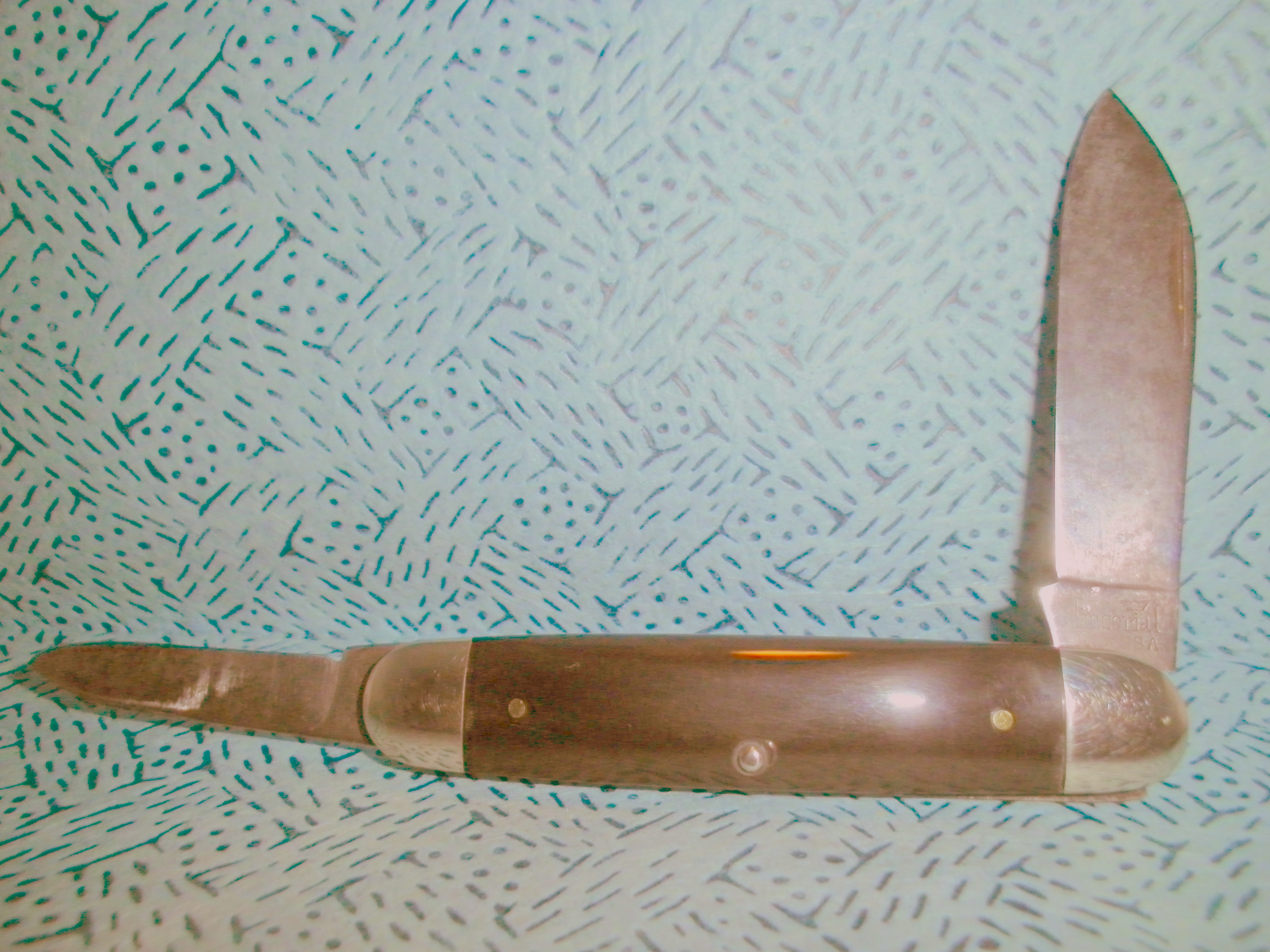

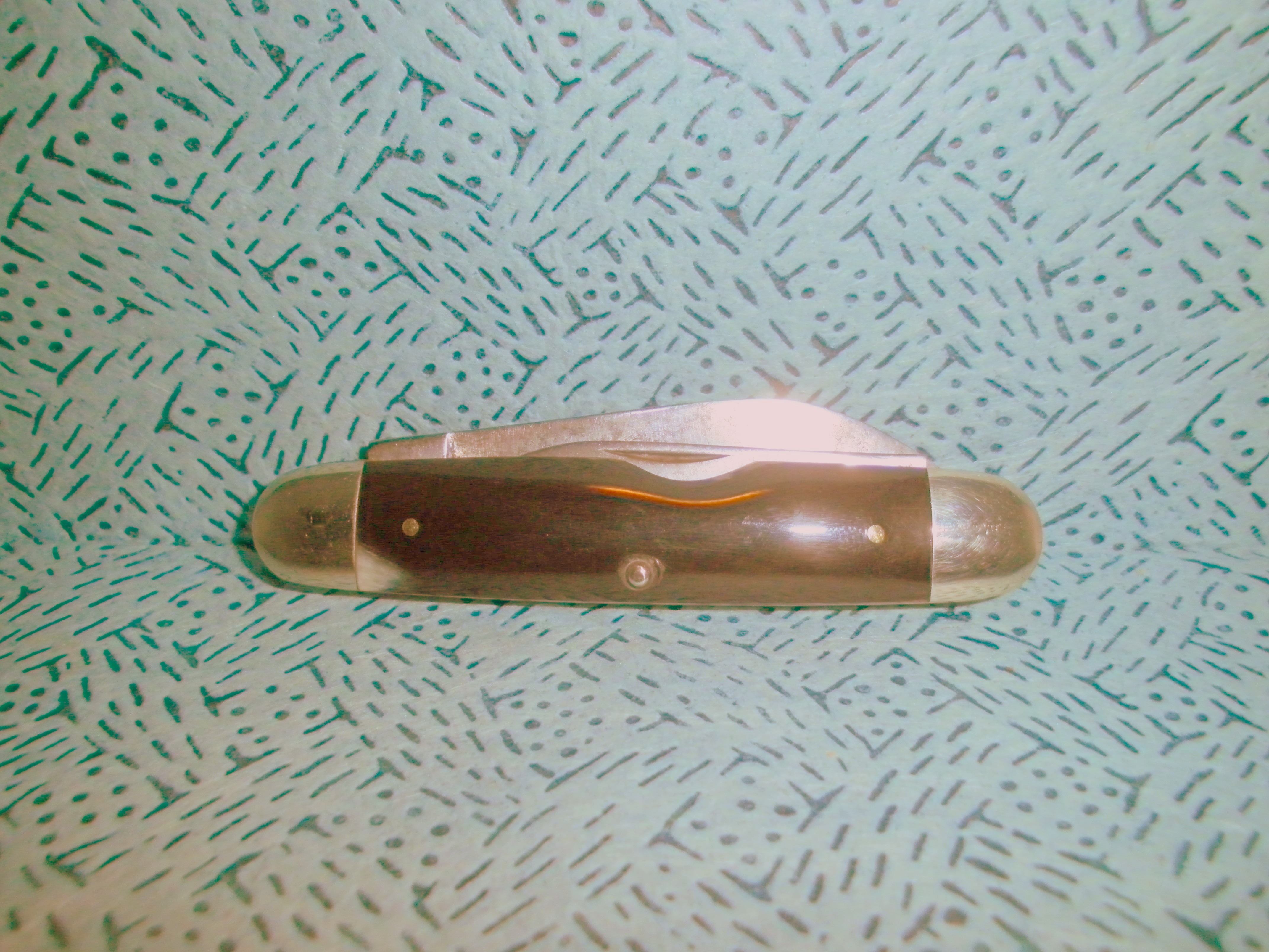

I'm saving back most of the high end parts like Case, Queen, Cattaraugus, etc..., even a few from Sheffield and Solingen, in hopes of restoring them to their true forms. But, some of these lower end parts are just fun to see what can be created from 'em. Some are kinda strange, but others like this equal end cigar pattern, actually make pretty decent EDC knives.
It's built with liners/bolsters from a Camillus utility/scout. The spear blade and backspring are from an Imperial scout and the pen blade, I think, is from an Ulster jack. The handles are domestic cow horn. The Imperial spear has a somewhat rare italics stamp and I wanted to use it in somehing a bit more traditional.
