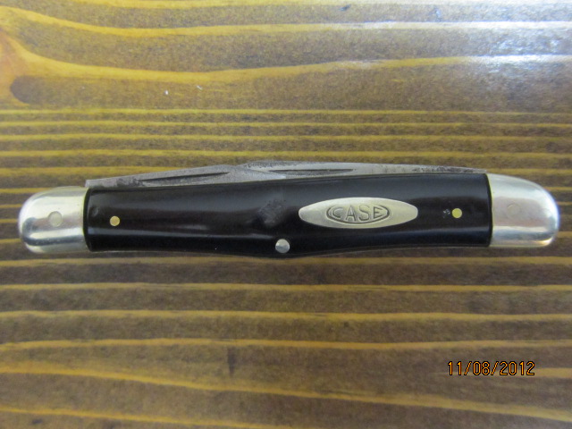

To begin, I will post some before shots of the knife in question.

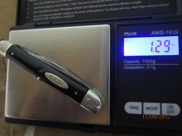

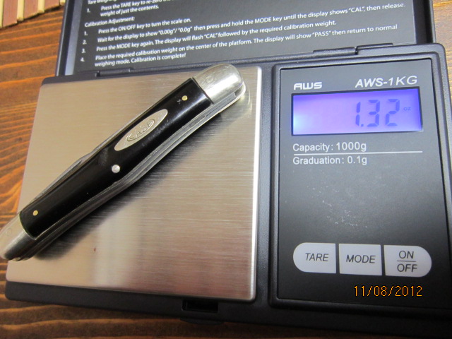

On the digital scale...pre-work, it weighs 1.32 oz
side shot. this knife has been taken apart before by me, to replace the pivot pins awhile back. I wasn't happy with the way it went back together. So, I will now get a chance to correct my mistakes...

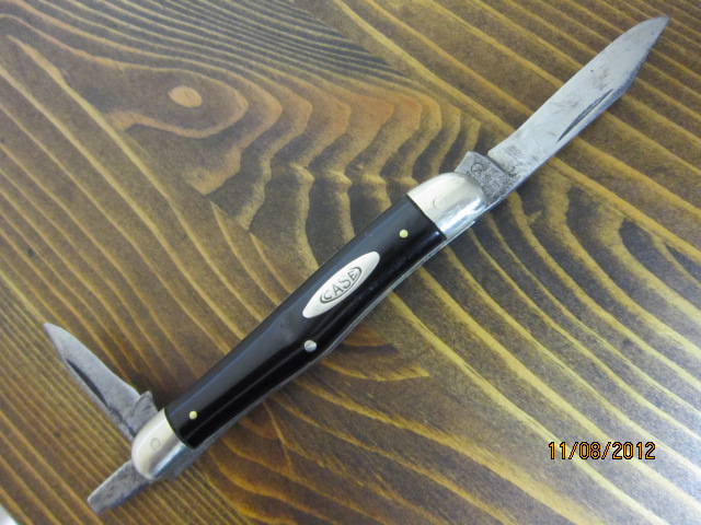

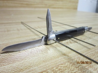

note one secondary blade is broken, however, there is enough of a nail nick to still open it. In effort to keep this customization as "original" as possible, I will opt to keep this blade intact.

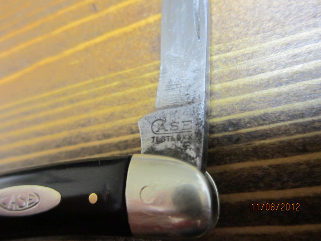

yeah, its a Case Tested, alright...

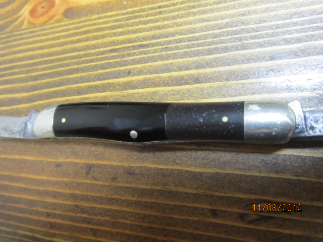

a somewhat cheesy epoxy handle patch I did. I added ebony sanding dust to epoxy and did this patch. When I got the knife off ebay, someone had used a cream colored epoxy to do a prior patch, which I removed. I don't really like my patch job, but in person it is much less noticeable than it is here.

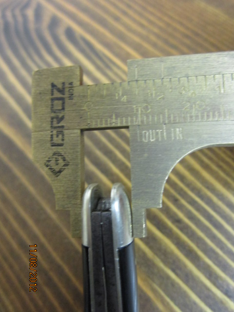

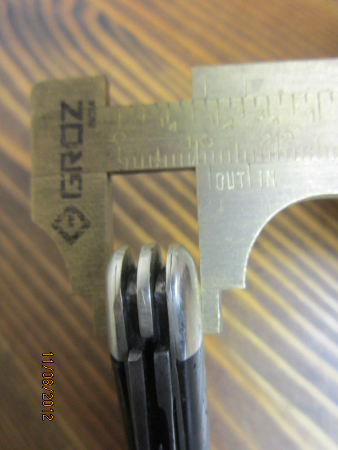

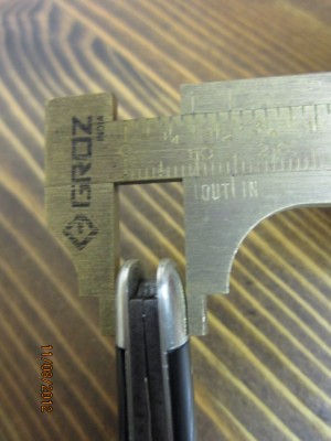

tipping the micrometer at roughly 3/8" on the master blade end
...and about 1/16" thicker or .4375 on the secondary end

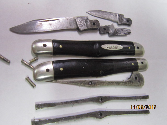

dis-assembly went OK...

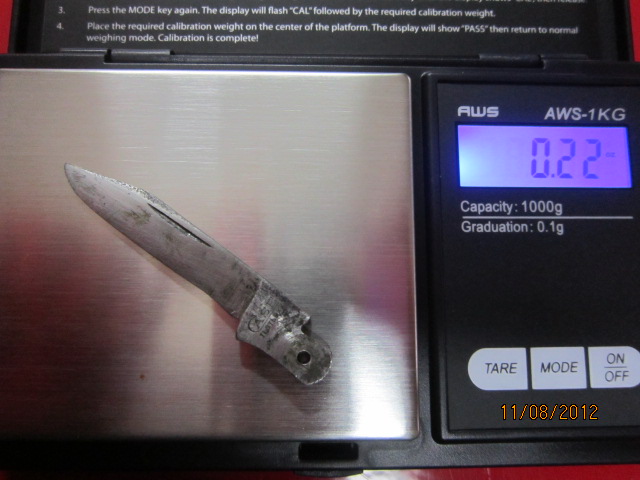

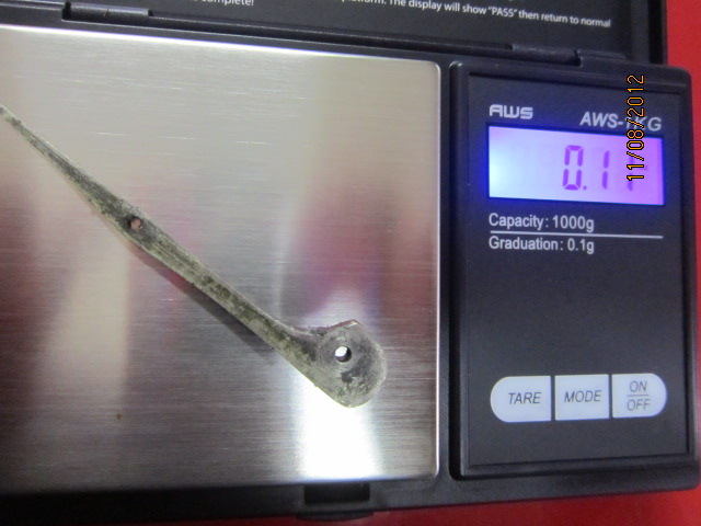

weighing in the blade, pre-grinding .22 oz
the tapered liner, this will be replaced with a full length NS liner cut flush with springs

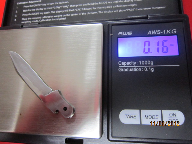

with most of the rough grinding done. all the stock was taken off the pile side of the blade so as not to damage the tang stamp. weighing in a .16 oz and dropping...

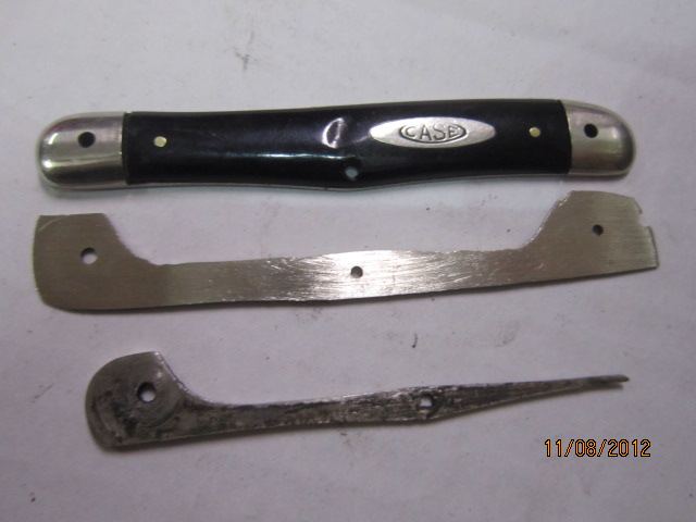

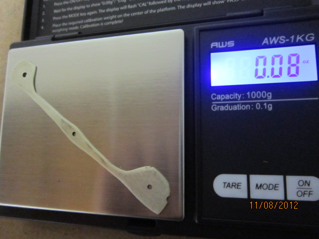

the beginnings of the new liner. this was cut from an older German corkscrew knife's liners I had laying around.

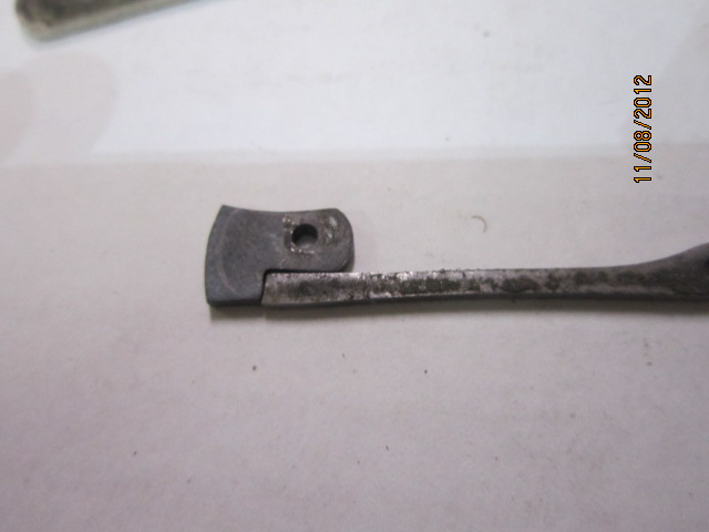

a cheap solution to "finish" the open end of the master blade's spring...this was an old blade I had lying around. It will remain in the open position and be ground flush with the end of the bolsters. I heated the blade red hot prior to grinding to soften the metal. I opted for this solution so that I would not modify the original frame or springs in any way. If I ever come across some really nice Tested blades with a bad frame I want the option to swap out at some point in the future.
the almost fully profiled new liner weighs in at .08 oz

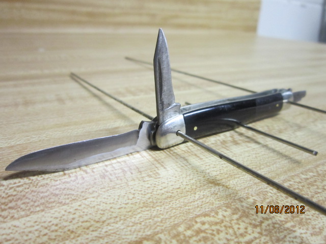

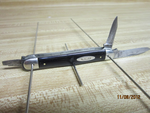

initial test fitting: the blades all open and close fine, with a little snap. however, this old knife has seen better days and both the blade tangs and the springs are pretty well worn.
another pre-assembly mock up.

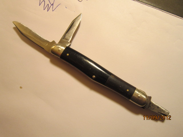

I did get the knife predominantly pinned back together and was preparing for final finishing and grinding the excess stock left on the new liner I made flush with the rest of the frame. However - I decided to put the brakes on this, photo-graph it as is, and then set the project aside. Here is why:
1. The knife when closed has too much "open space" in the frame as I alluded to last night. In the pocket this thing will fill up with dust, sand and everything else.
2. The blades, being as they are, contribute greatly to this open space in the frame. I don't have any extra blades for this pattern, and as such I think it is an exercise in futility to actually pin this together with a broken blade in it.
3. While I was doing my preliminary fit-ups, I tested it as a two blade, with one spring and the new center liner / spacer. That is the way I am going to end up finishing this. Then I will set the original center liner, extra spring and blade tang aside for future projects.
This old knife was just too far gone to really rely on for EDC in this current 72-style configuration, which is what I wanted to do. I always have my eye out for 08 pattern whittlers and I feel that someday I will find another, more complete and tight donor knife and try this project again.

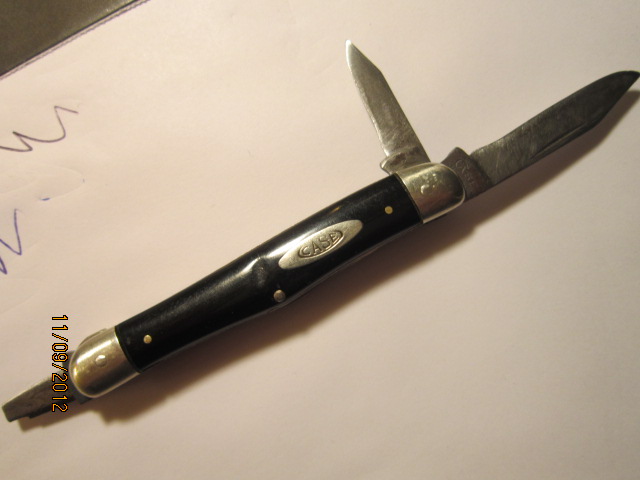

In the meantime, I will post for history's sake my "Camillus 72-style Case 08 whittler" - FWIW
In my opinion, this knife pattern would be a great candidate for manufacture as a 72-style stockman/whittler. Preliminary measures show it coming in slightly lighter than the original configuration, and def. a little thinner and sleeker in the pocket.
If anyone has any project 08's for sale let me know what condition and how much. I would like to try this project again with a better knife to start with.
Thanks.

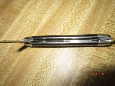

tipping the scales about .05 of an oz lighter than the original. I think I would have ended up shaving another .02 off by the time I got it to a final finish state

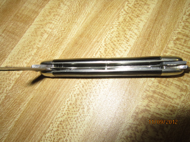

a shot of the inside, with new liner and blades reconfigured.
The 72-style config of a Case 08 pattern, mark side, blades open
same, pile side
same, pile side
