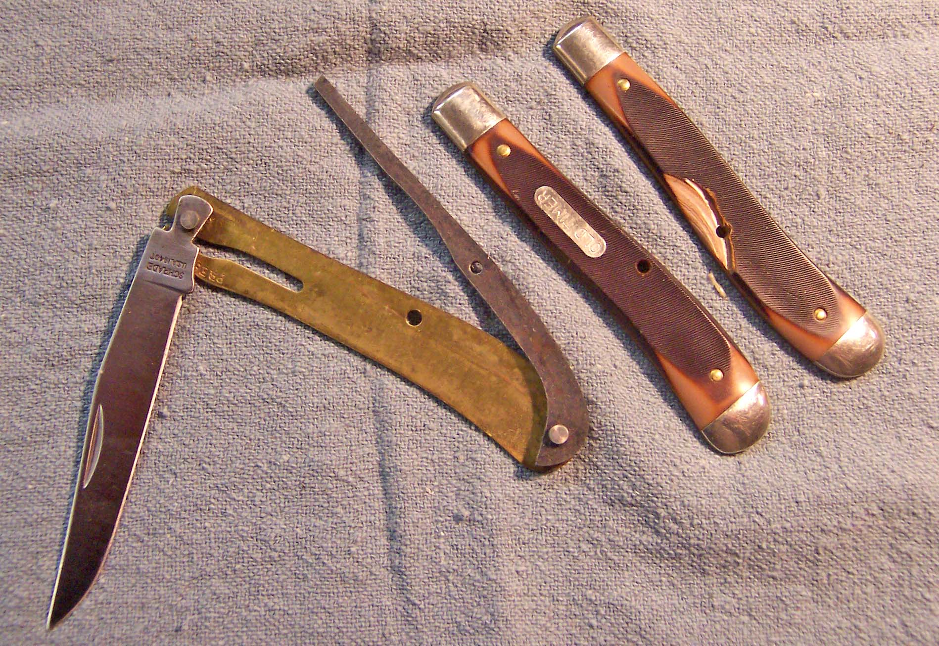

I believe that Muskrat Man is right, it was made by Schrade.
That means it most likely is made with the Swinden Key. If you look in the Knife Related Tutorials forum there is a thread that show how to take a knife apart: http://allaboutpocketknives.com/knife_f ... php?t=5236
However, if your knife is of the Swinden construction, you can cut the center pin (rocker pin) and remove the pieces, and twist the knife apart with about a 5º turn counterclockwise. If you get a new 8OT and take it apart, you can probably just put your old handles on the new inner assembly, as they will be held together with the Swinden Keys.
I am posting a picture of a single blade Old Timer that has been taken apart and the assembly left intact. It has the liner lock, blade and back spring all together in one assembly. Your knife will have 3 blades, a center liner & 2 back springs held together by the Swinden Keys on each end. If the keys are set to the same depth, it is a simple matter to put the old handles on the new assembly.
Of course the tang stamps will be what ever is on the new blades, but I doubt if you can find an Old Crafty with new blades.
Feel free to send me a PM or email if you have any further questions.
