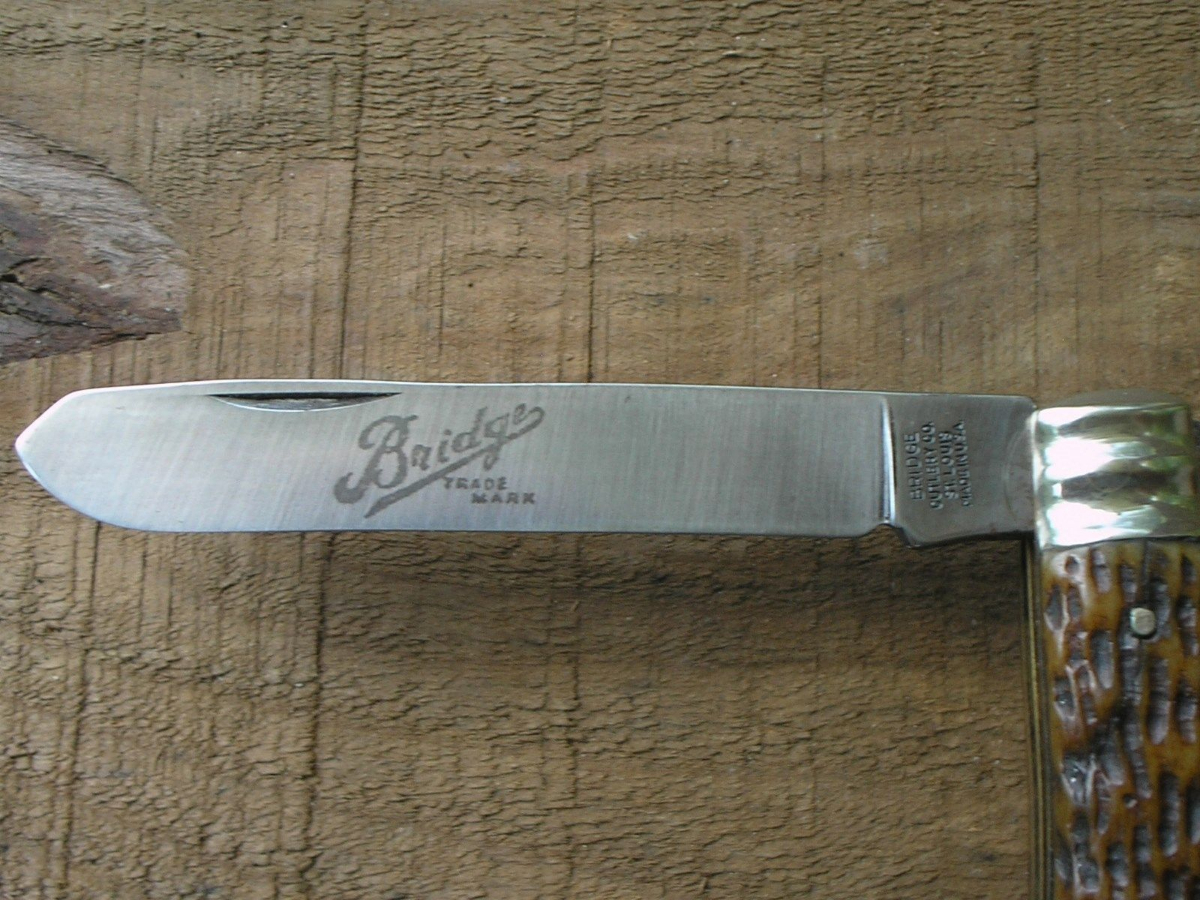

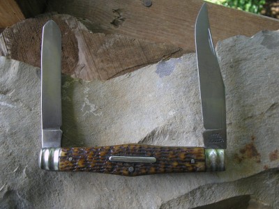

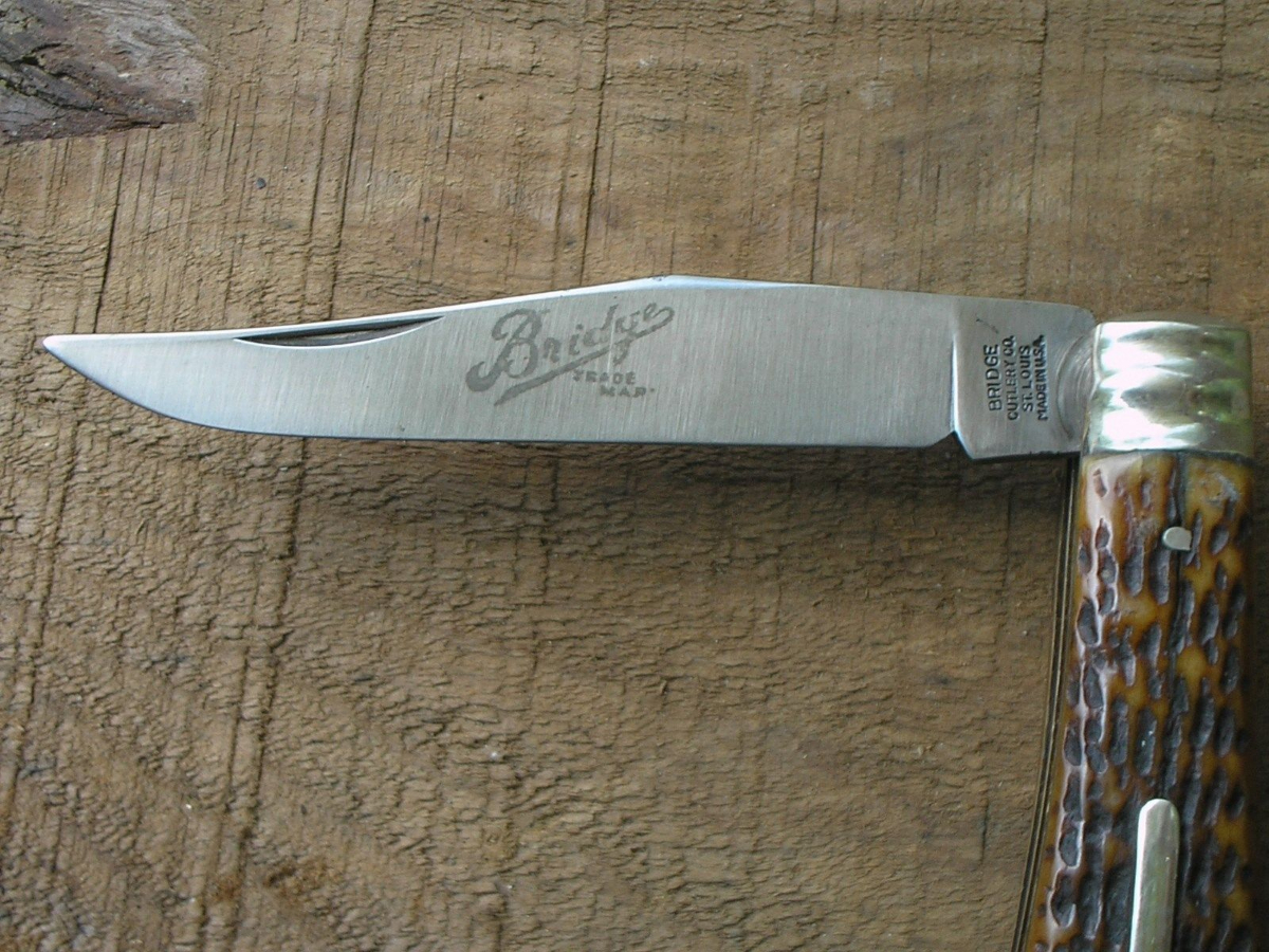

Here is a knife that does not look right to me.
Appears to be a very nice old original Bridge Cutlery Co. frame with new blades installed. The combination of glaze finished blades with an etch is very unusual. I believe this knife should have crocus polish on the etch side of the blades and a glaze polish on the pile sides. The edges of the blade tangs look very rounded with a modern tumbled finish look to them. This knife looks bad to me long before looking at the tang stamps.
Not the first questionable knife to be listed by this seller and not the only bad looking knife currently listed. $330 bid with a day to go in the sale.

Odd indeed. What I dislike is the lack of any nice top grinds on the blades which I would expect to see on a knife with that gorgeous handle. I know etches on glaze finish is uncommon but not unknown, I had a mint NYK Co 4" coke bottle with wood scales and it had the Hammer Brand etch in perfect condition and both sides of the blade were glaze finish. I would stay away from this one myself.

Looks fishy to me too......

Exactlypeanut740 wrote:Those blades don't belong in that frame.
