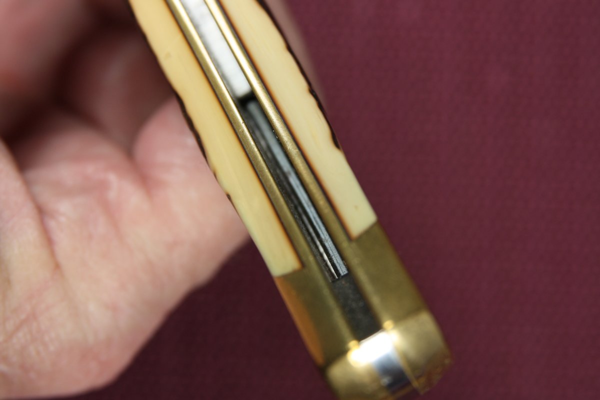

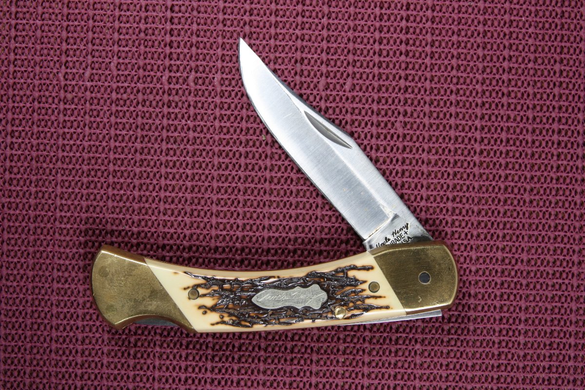

You don't necessarily need a round piece of spring pin steel. I have fixed more than one of the big lock blade Schrades using an Allen wrench for a replacement spring. After you take out the pivot pin, take the small end of the L shaped Allen wrench to test to see what size will fit into the spring recess slot. After this is determined, cut off the short end of the L with a Dremel cut off wheel. Slip the Allen wrench piece down into the slot, compress the new "spring to re assemble the rocker pin. Done. Show is an Uncle Henry LB8 that I fixed this way.

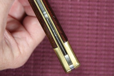

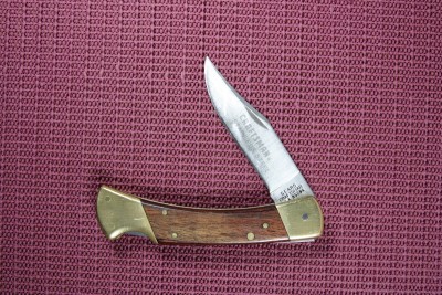

Here is another one, a Craftsman 95206 that is probably identical to a Schrade that I fixed with an Allen wrench for a spring.

Now that is just too cool.
I didn't know an allen key had any spring to it...
I am going to have to file that knowledge away for future use!

Allen wrenches have to be hardened or they would round off the corners too easily. I cut them with a Dremel cutoff wheel because they are too hard for a hacksaw blade to cut.Meridian_Mike wrote: ↑Thu Mar 19, 2020 7:46 pm Now that is just too cool.
