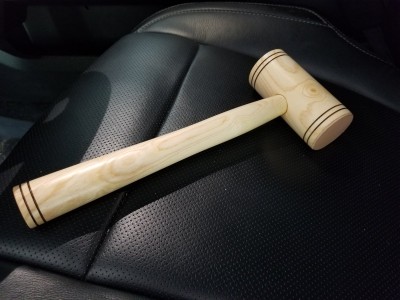

Here's 3 of the little wooden mallets I made earlier this year. The top one is just made from scraps of oak, ash, and walnut, with no lathe work. The last one I made for a friend. He asked for one to use in his gunsmithing. One side has a leather face, then other is wood on each of them. My design improved from my first one (background in middle pic), to the one I made for him.

Those wooden mallets are so cool! Again, it's a shame I lack the skill and equipment necessary to take on such a project.

Exactly, they are cool and i wish i had the skill and space to do some woodwork.

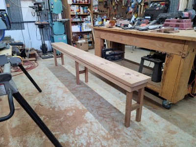

The wife had several plant stands across our dining room windows. She asked me to build a bench to replace all the plant stands - the specs she gave me was 9 foot long, 23" high, and 12" wide. We had a patio cover built this summer, and had some leftover pieces of 6x6 rough cedar - about 5 ft long. I cut the cedar into 2x6s, and ran them through the planer, then bookended a couple of sets together. I used lap joints to make the top pieces and skirt 9 foot long. I then built the skirt and some legs for it. Finished it with some walnut stain and a few coats of poly.

Well Mike, that turned out beautifully. Congratulations. Your wife must be very pleased that she married such a talented husband.

That’s a fine looking piece of furniture you’ve made .

Turned out great Mike!
Well done!

D) All of the above
Looks great, Mike!!
As has been said, that's a piece of furniture, not just a plant stand.

Thank you, guys. I didn't cost me anything (if you don't include the cost of the patio cover!
), and the posts were taking up room in my shop. I was getting splinters every time I had to move them around. That rough cedar is rough!

Beautiful Mike! And you have one heck of a shop there...Unk wrote: ↑Wed Jan 05, 2022 5:35 am The wife had several plant stands across our dining room windows. She asked me to build a bench to replace all the plant stands - the specs she gave me was 9 foot long, 23" high, and 12" wide. We had a patio cover built this summer, and had some leftover pieces of 6x6 rough cedar - about 5 ft long. I cut the cedar into 2x6s, and ran them through the planer, then bookended a couple of sets together. I used lap joints to make the top pieces and skirt 9 foot long. I then built the skirt and some legs for it. Finished it with some walnut stain and a few coats of poly.

Thank you, Willy. We moved into the house in 2020 and I sure have enjoyed having a shop, instead of crammed into a 1/2 of a garage.

Great work on the plant stand and axe!
