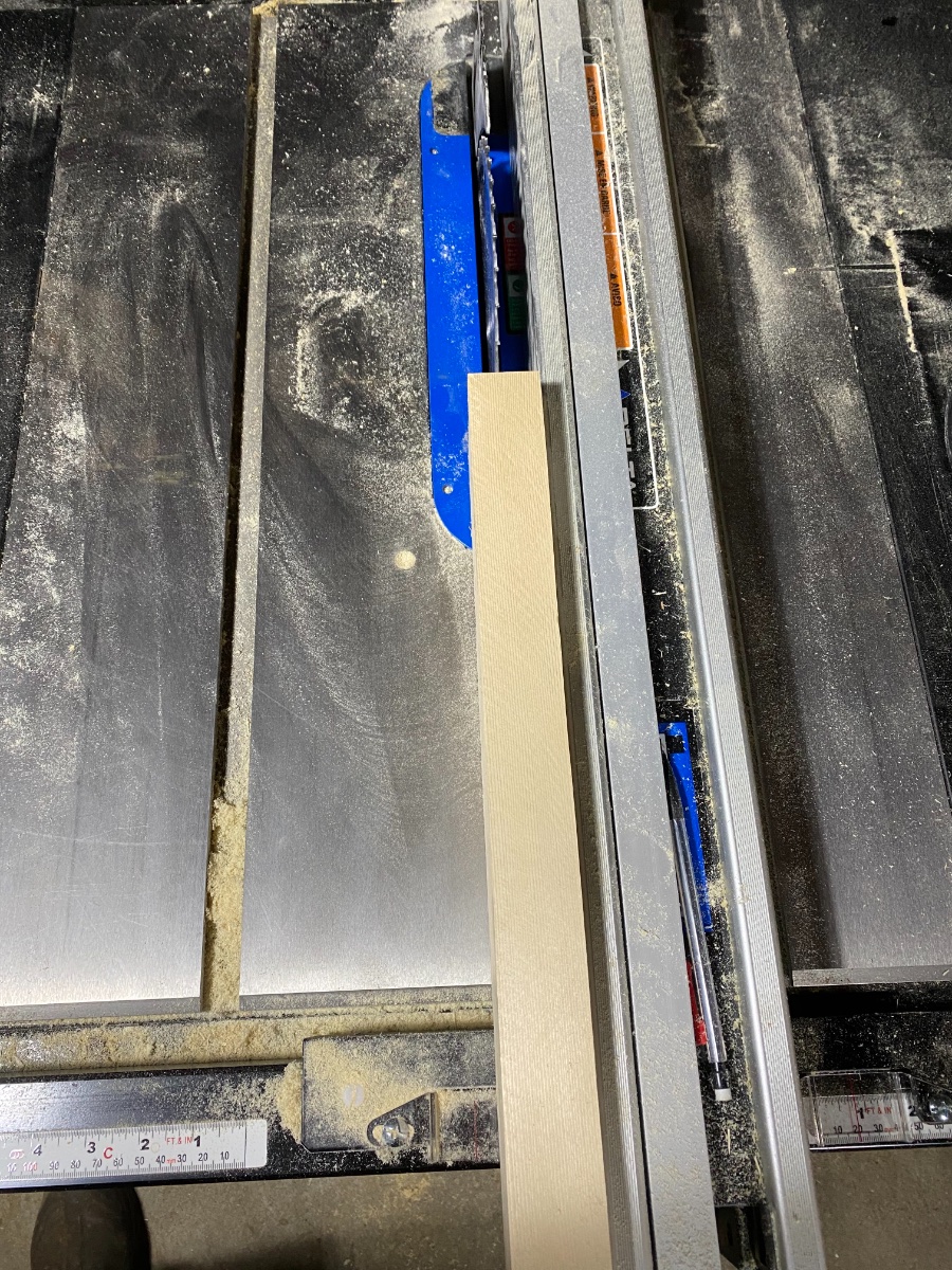

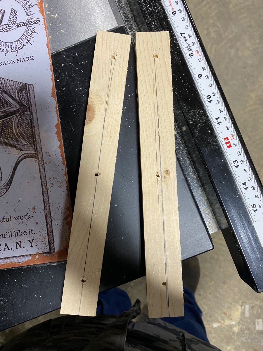

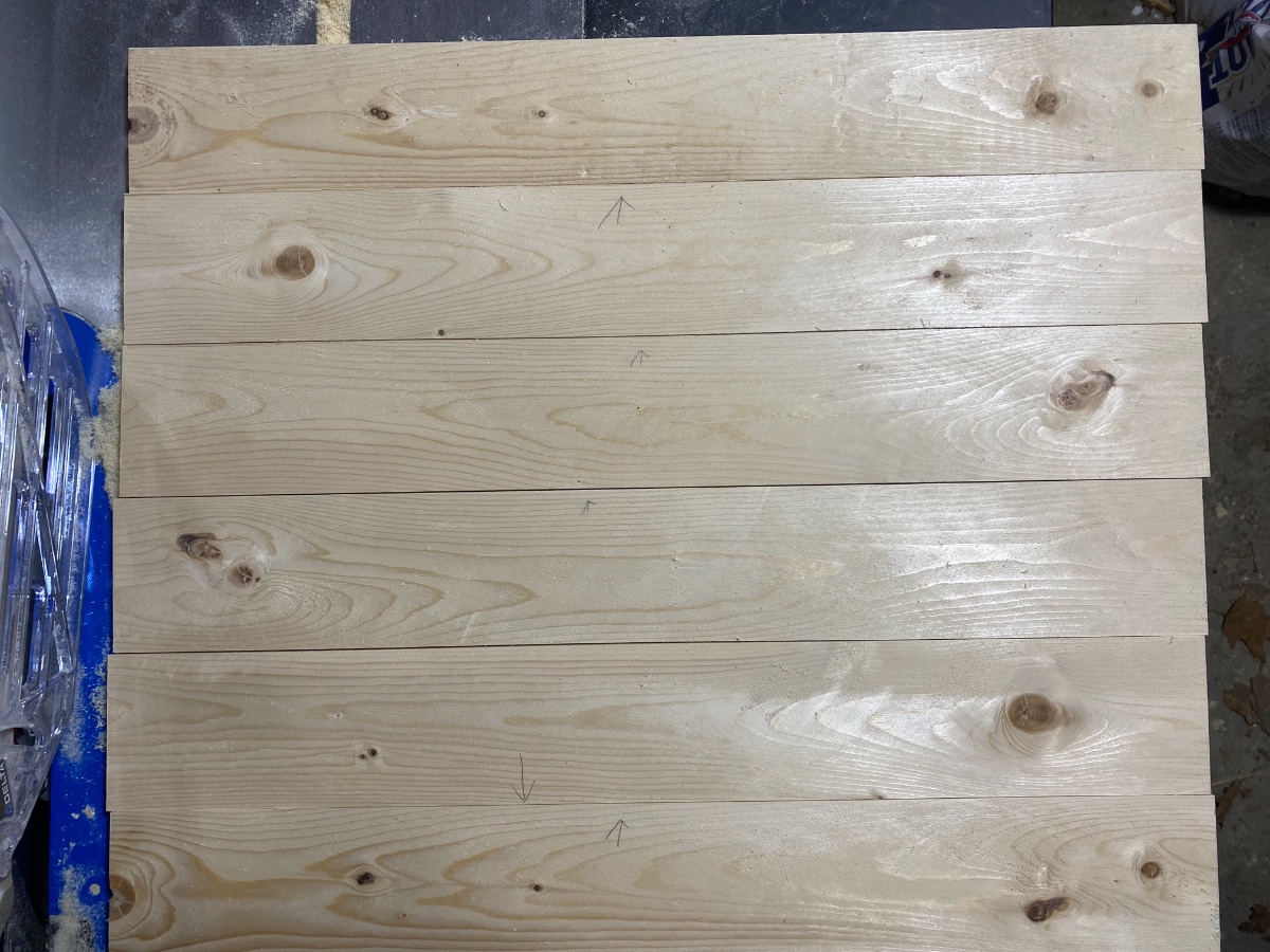

I’m no Norm Abrams or Roy Underhill by any means, but I’ve recently started a bit of woodworking and have really been enjoying it. My wife got me this repro Ithaca shotgun advertising sign for Christmas and I decided to make a display for it. I found some ideas on line where folks were making these “crate side” looking displays for pictures and signs and thought I’d try one.
The boards are 3/4’ thick and the whole thing was made from one 2x4 pine stud that had been sitting on my shop floor for about a year. Here are some pictures of the process and the final product. Thanks for looking!

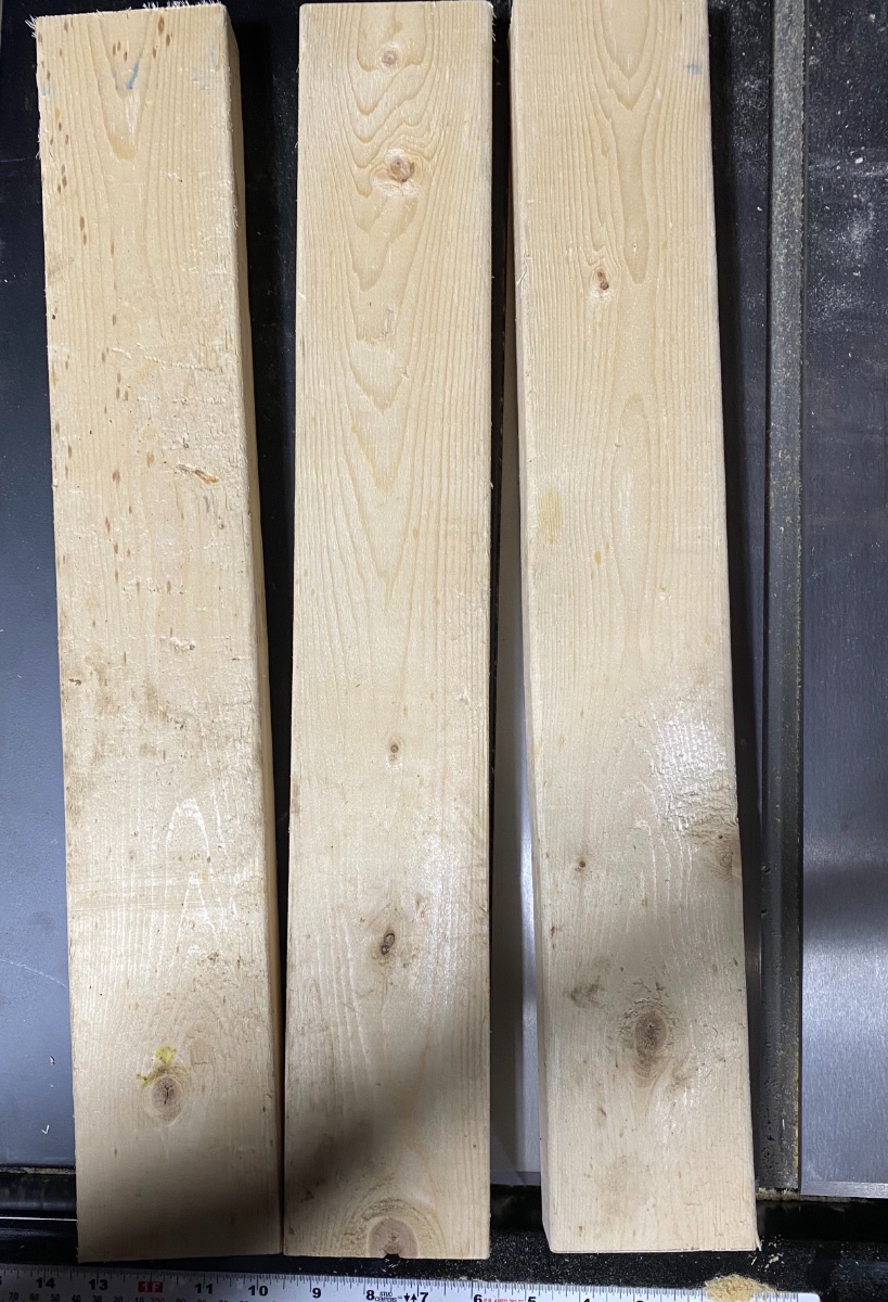

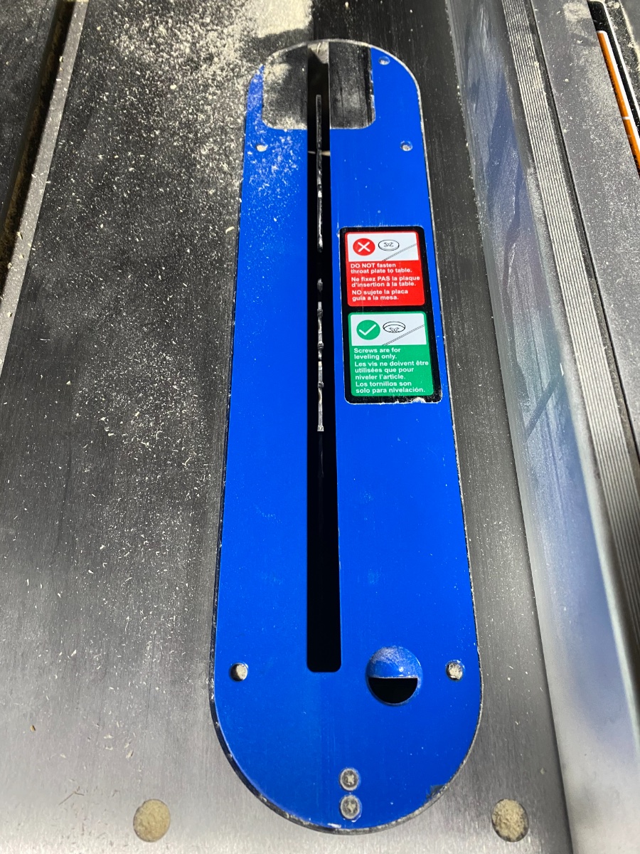

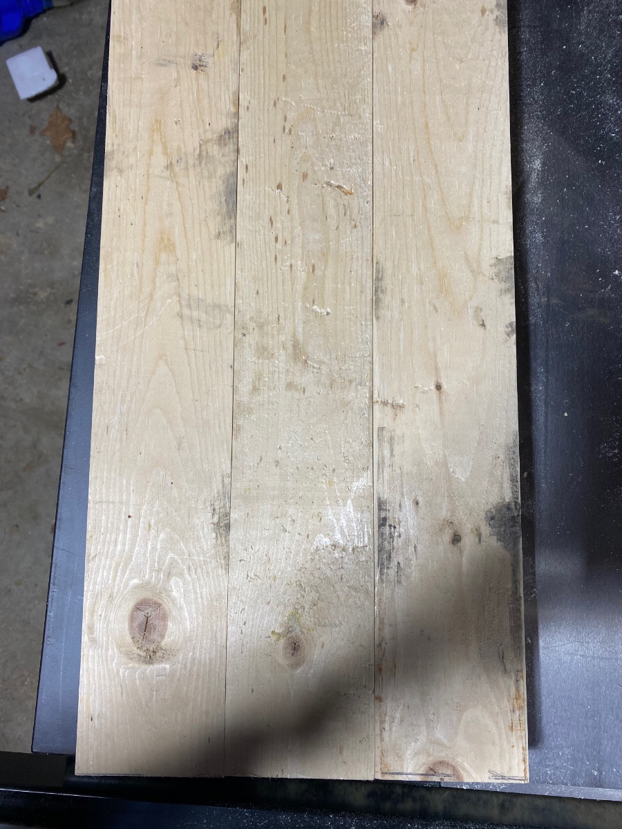

First I used the table saw to cross cut the 2x4 into three pieces the length that I needed they ripping the rounded edge off them to help with the resawing.

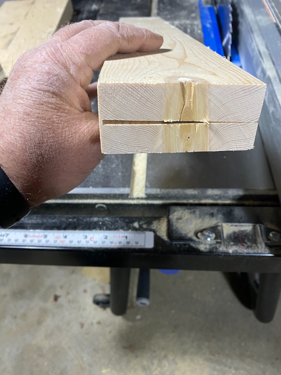

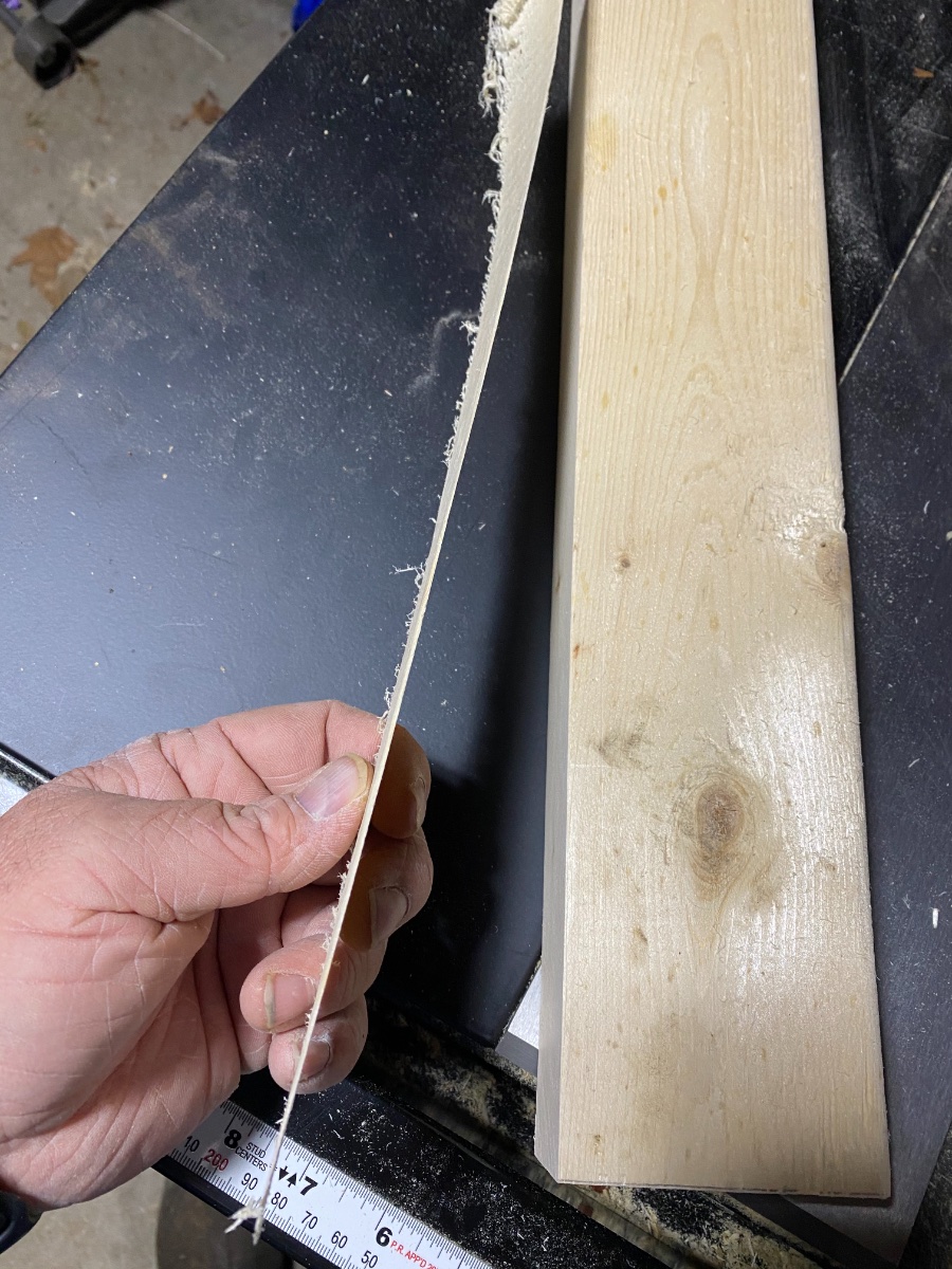

Then I resawed the 2x4 pieces to make them thinner and checked my lay out.

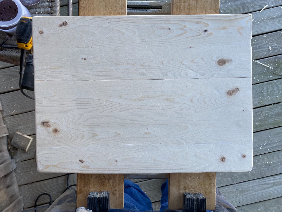

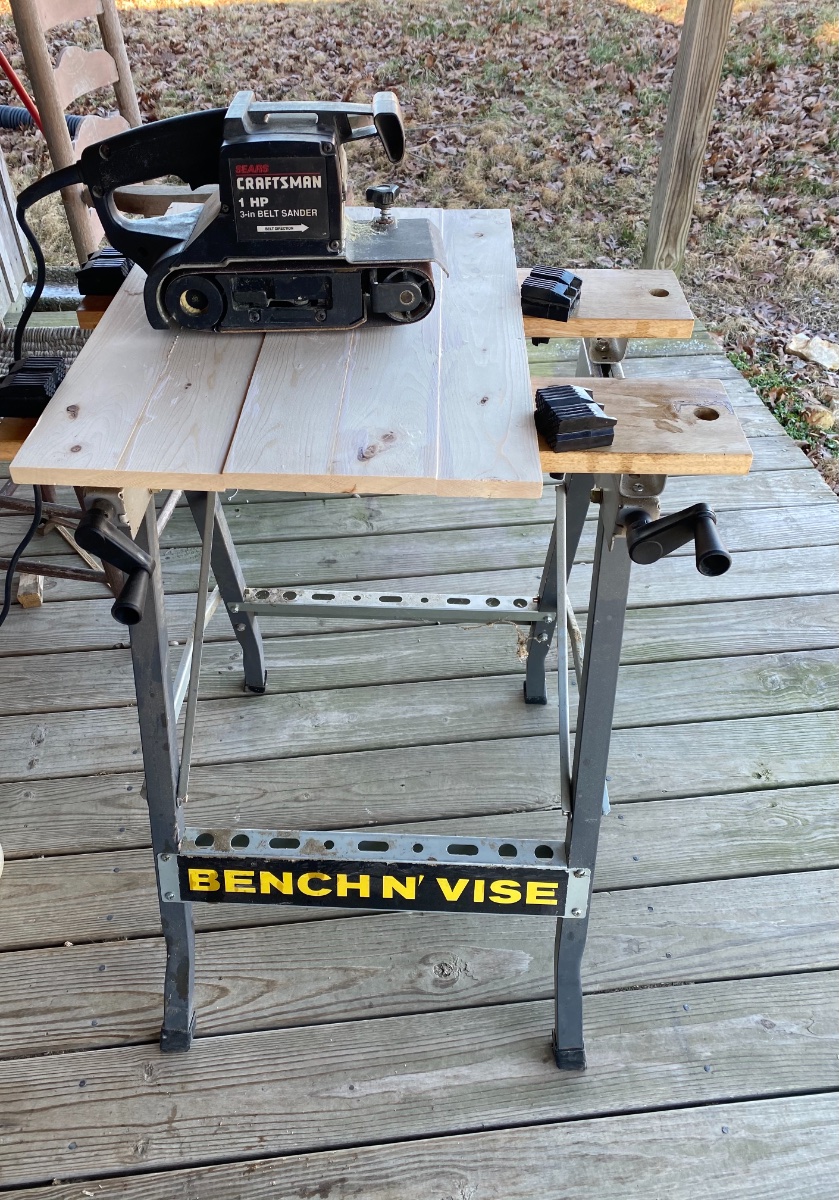

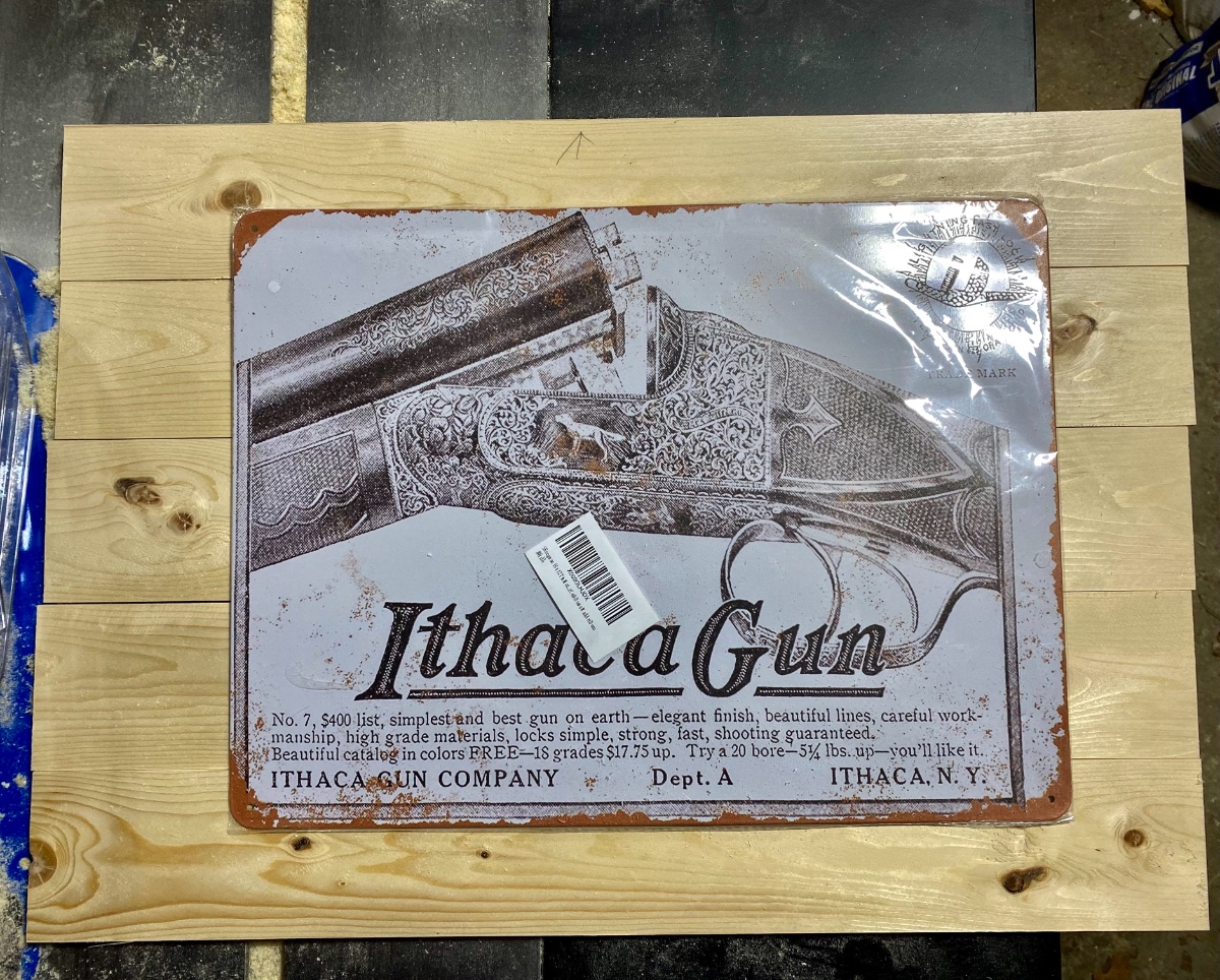

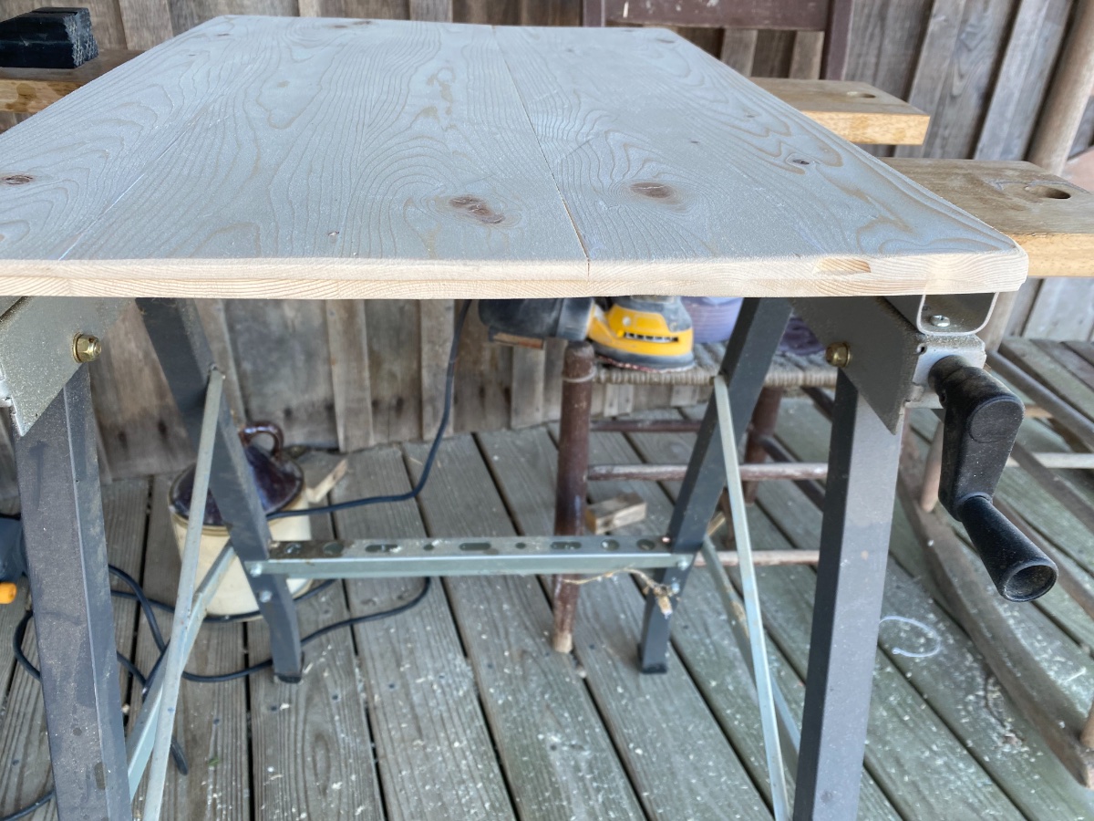

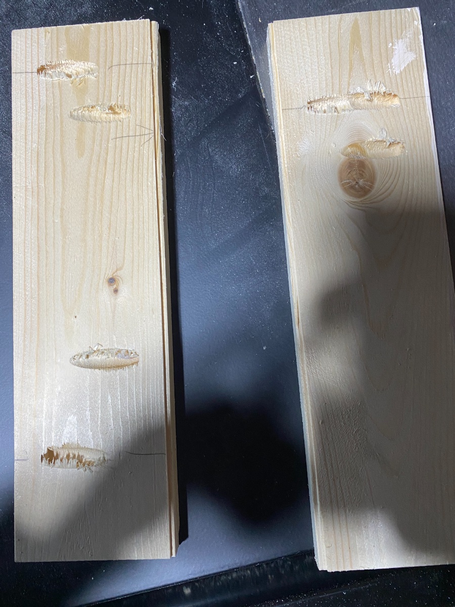

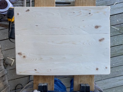

Then I glued everything up, flattened and distressed with a belt sander, used a router to round ove the edge and make some more distressed places on the edge, then sanded with the random orbital sander.
To attach the sign and make it look something like a crate side I made these styles and cut a rabbet in them the heights of the sign thickness so it could slide in and out, then drilled some “nail holes” in them.

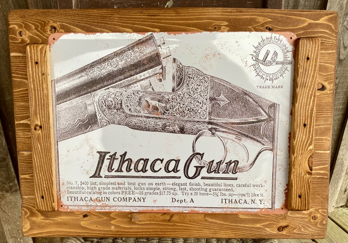

After staining and final assembly, here’s the finished product.
