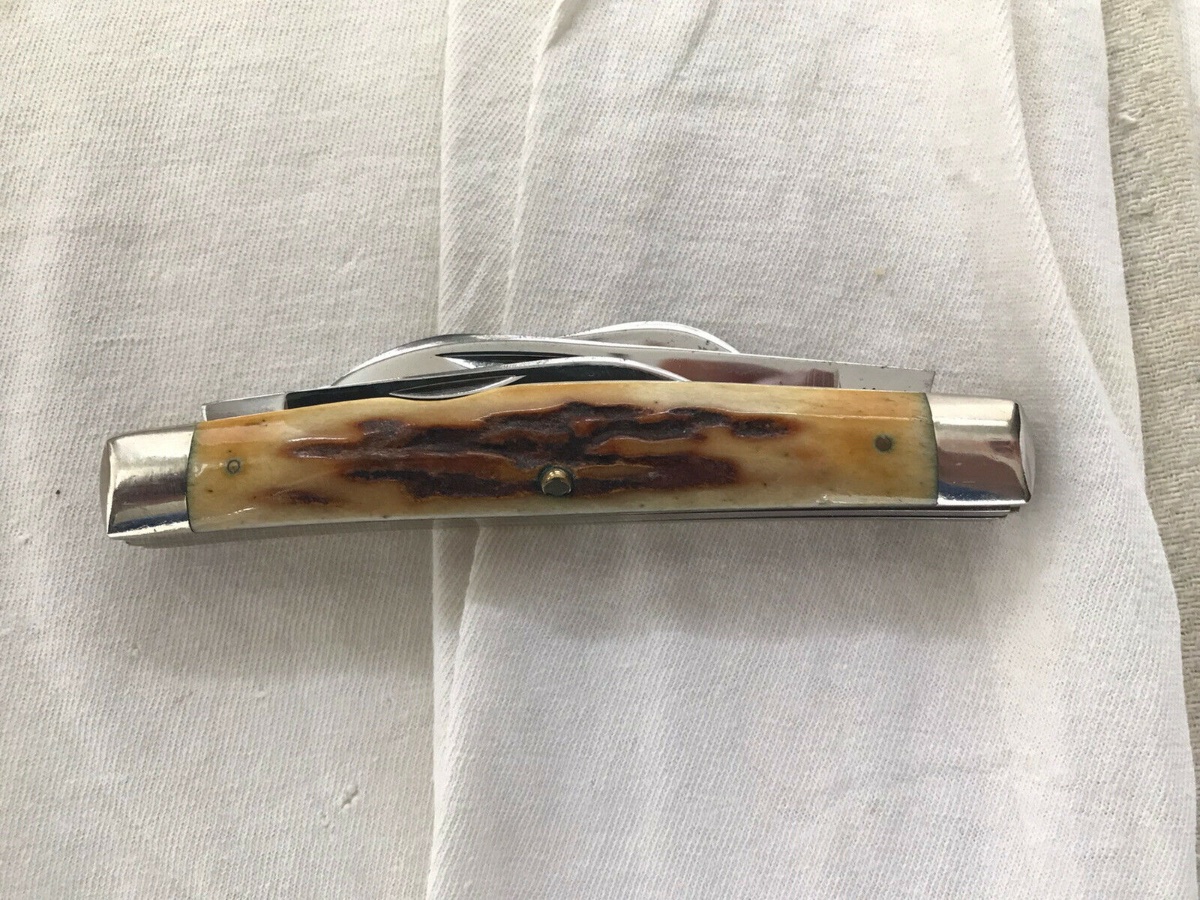

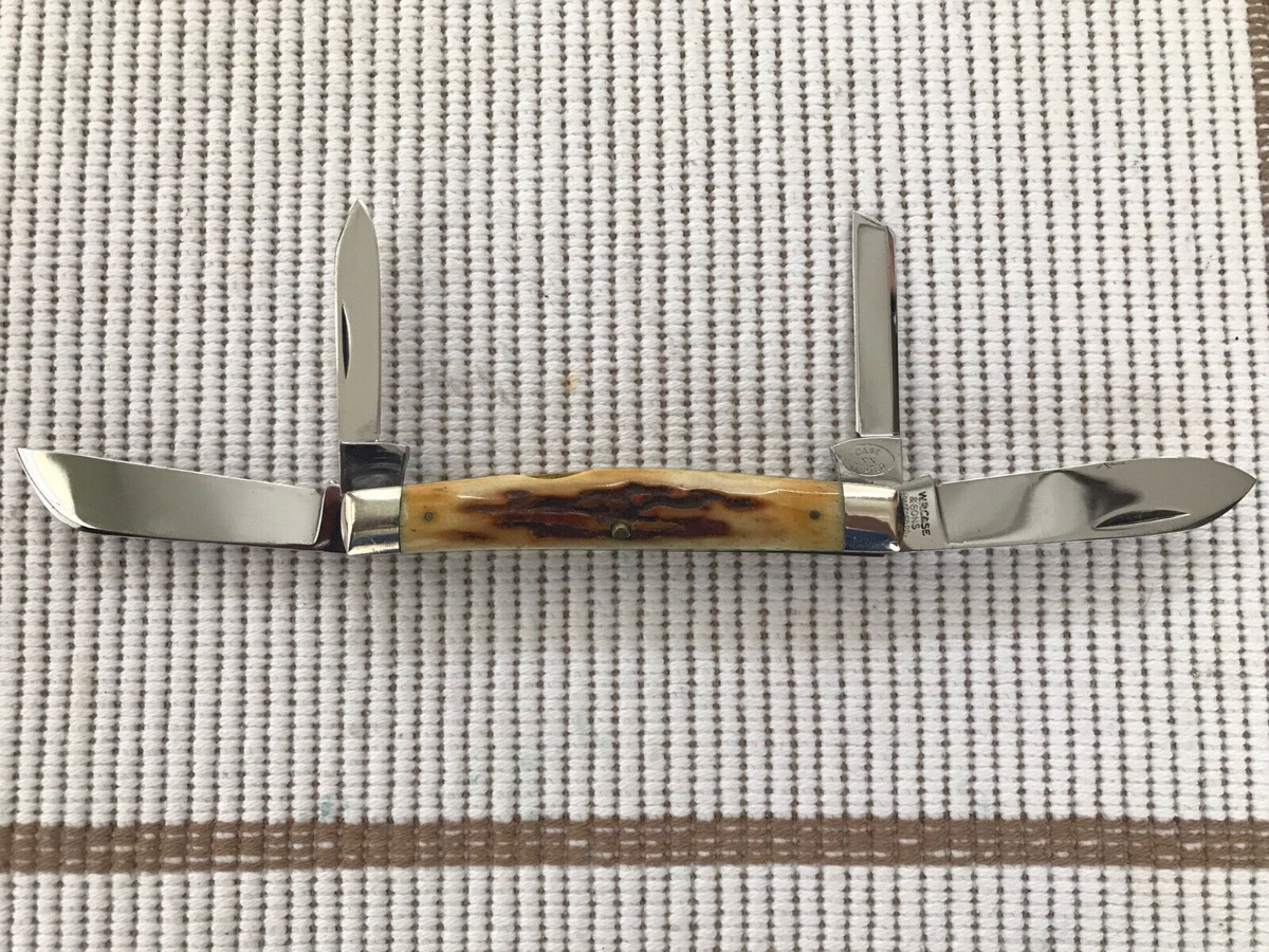

Somebody is mighty proud of this one
https://www.ebay.com/itm/353906269752?h ... Swi0diBrIV

Definitely not legit. Looks like someone took a USA 65-69 Frame and restamped the blades, nothing right about it at all.

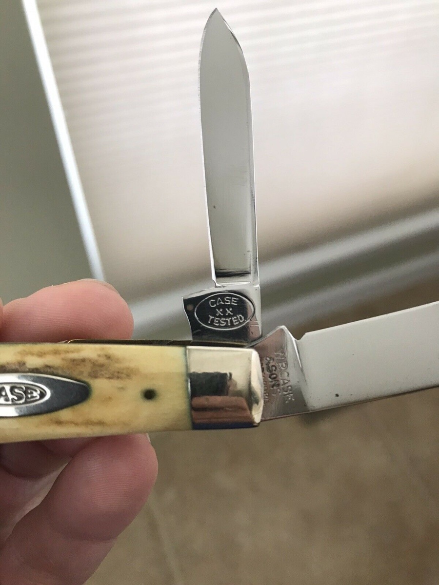

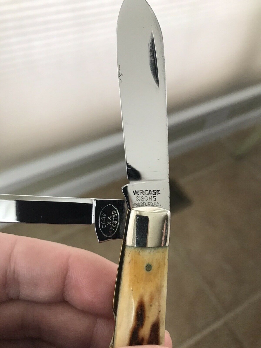

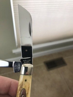

Am I wrong or is one tang stamp from 1905-1914 and the other from 1914-1920?

dlr110 wrote: Sat Feb 12, 2022 9:54 pm Am I wrong or is one tang stamp from 1905-1914 and the other from 1914-1920?
Yes, that’s correct. W R Case & Sons never had rights to the Tested XX trademark until 1915 when they purchased it from Case Bros. But, as I said before, nothing about this knife is correct. ::td::

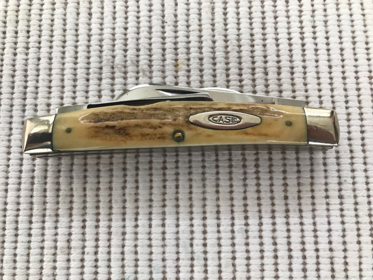

Looks like a Dremel tool was used to put the "Bradford.Pa" marking on the tang. He deserves a finger cut after typing that price in. :roll: However, he has ended the listing.

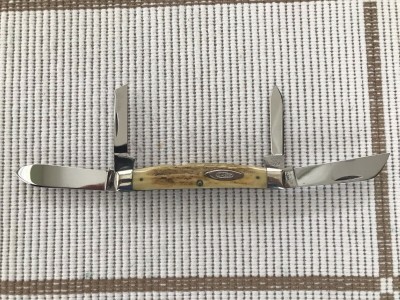

I am thinking that shield came from a Case Classic.

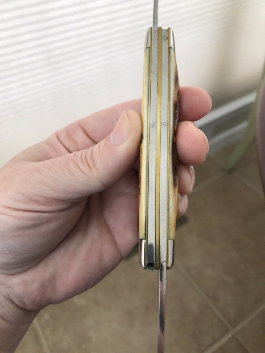

The auction pictures

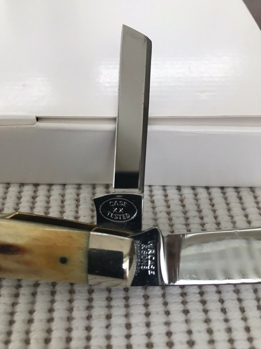

danno50
Posts: 3773
Re: This can't be legit
Post by danno50 »
The rest of them
