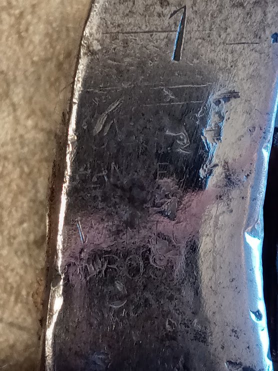

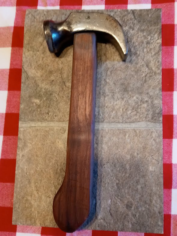

I bought this cobblers hammer missing the handle. I used furniture grade mahogany that I had knowing that it is not a striking hammer mainly shoe tacks and smoothing leather. There is part of a name but cannot make it out and a 1"one." The head has seen abuse. Band saw and one inch belt sander.

Nice work, and a handy tool to have, are you going to or have you oiled the mahogany? ::tu:: ::tu:: ::tu::

A light coat of boiled lindseed oil. The head, I will leave the dings and dents. I took a picture to try to read the letters.

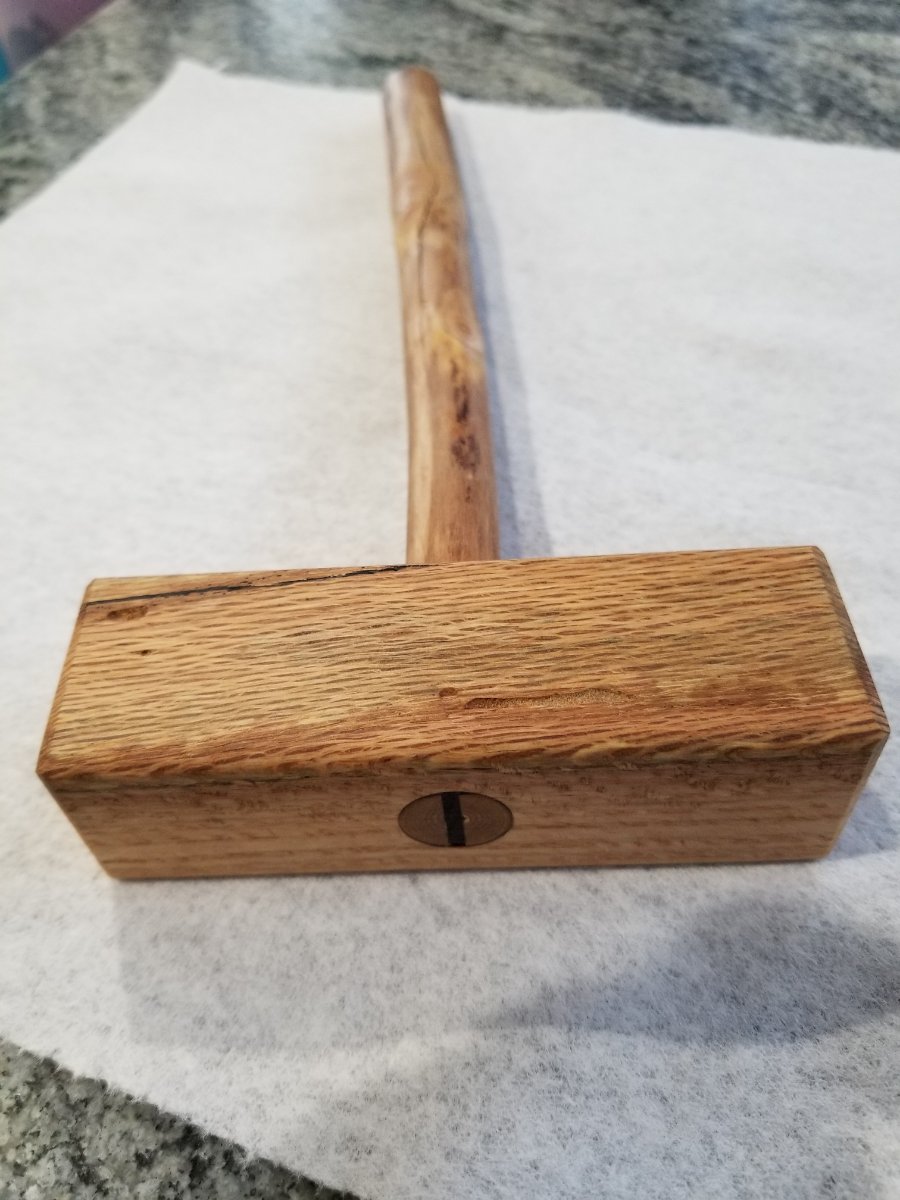

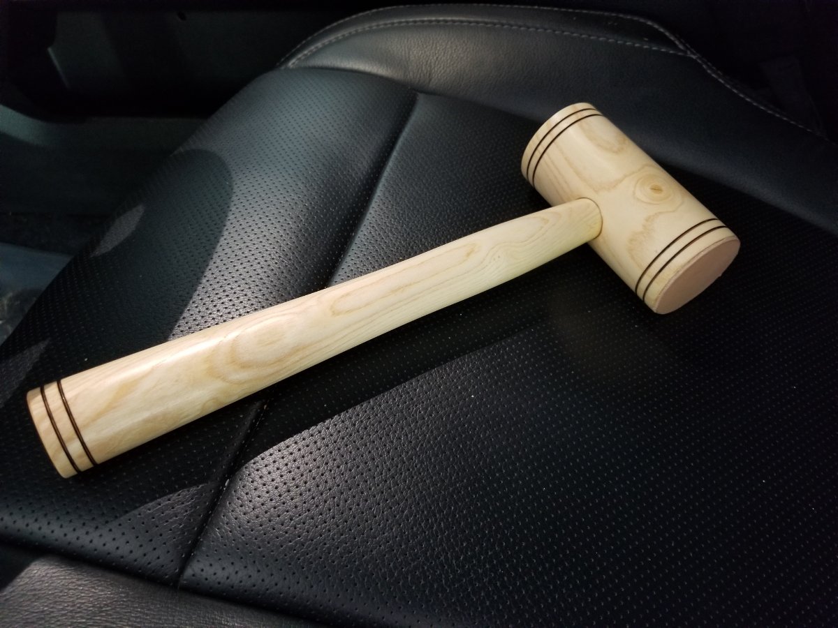

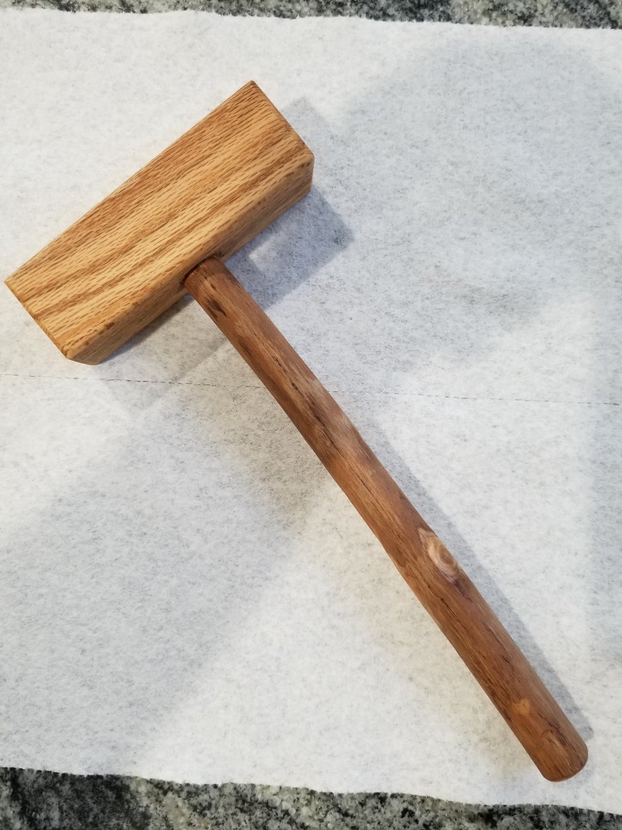

Nice work, Mr. Watch. I love refurbishing these old tools and putting them back to work.

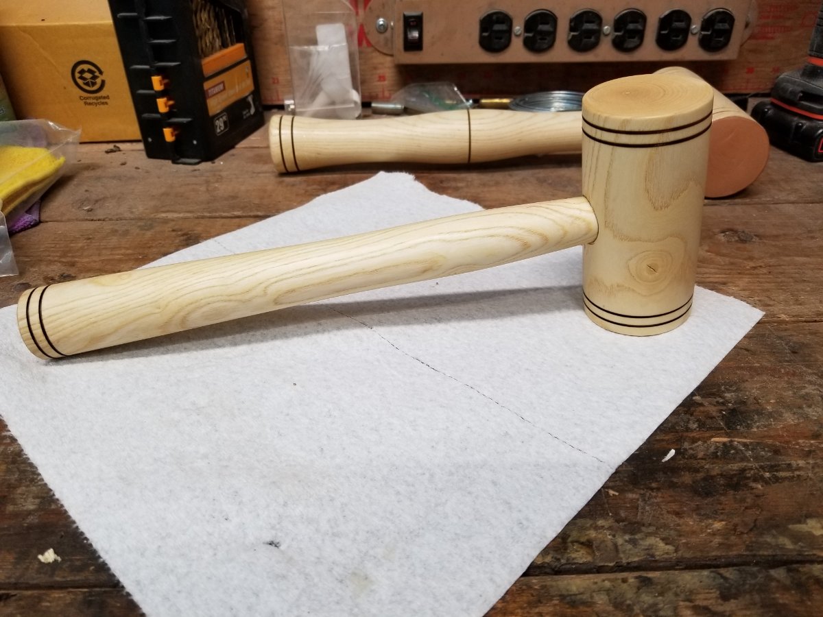

Here's 3 of the little wooden mallets I made earlier this year. The top one is just made from scraps of oak, ash, and walnut, with no lathe work. The last one I made for a friend. He asked for one to use in his gunsmithing. One side has a leather face, then other is wood on each of them. My design improved from my first one (background in middle pic), to the one I made for him.

Those wooden mallets are so cool! Again, it's a shame I lack the skill and equipment necessary to take on such a project.

Exactly, they are cool and i wish i had the skill and space to do some woodwork. 8) 8) 8)

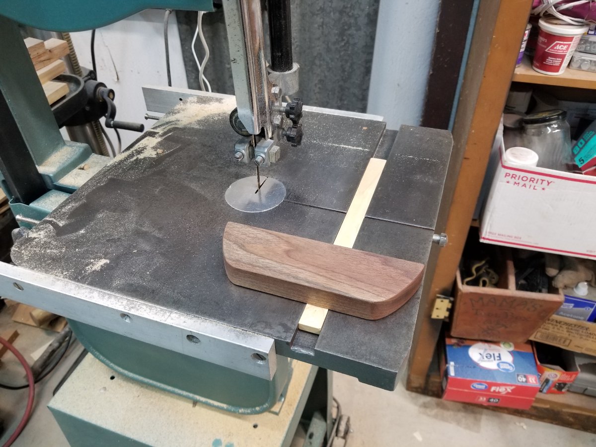

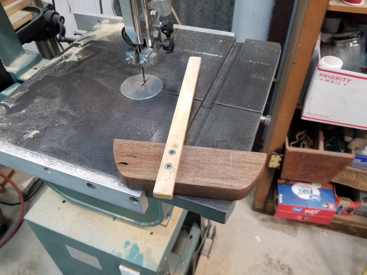

Just puttering around in the shop today, and made several little projects I have been needing to do. My old bandsaw has a weird sized miter channel (18 mm?), so none of the many miter gauges I have will fit. So I made a simple one out of ash and walnut. It will only do 90 degrees, but anything else I will cut along the line - or used a rip fence - anyway.

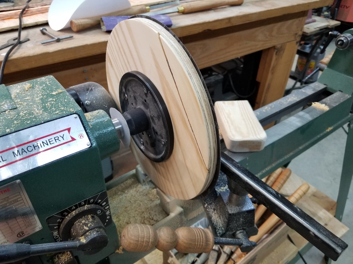

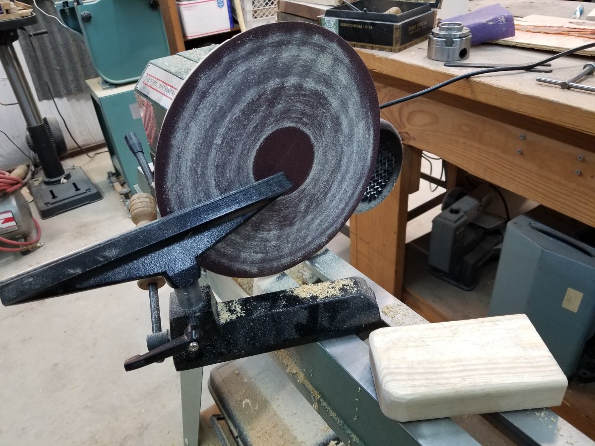

I also have been wanting a 12 inch sanding disc. So I cut a 12 inch disc out of some scrap plywood on the bandsaw and mounted it to a 1/2 hp motor with a flange. It was so out of balance the workbench was jumping dancing around the shop! :lol: So that was a failure. So I mounted the disc to another flange and put it on the lathe, and turned it down until I finally got it balanced. It works tolerably well on the lathe.

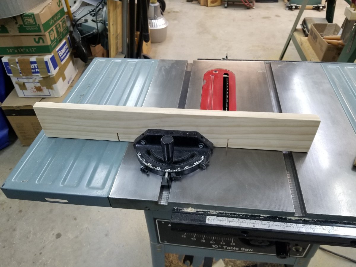

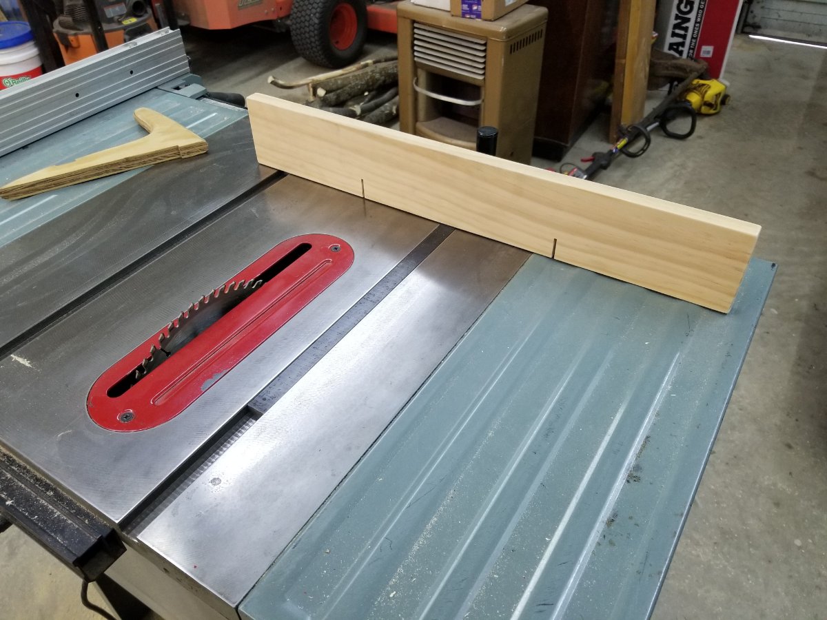

Last was I added a length of board to the miter gauge on my new / old table saw. That only took a few minutes.

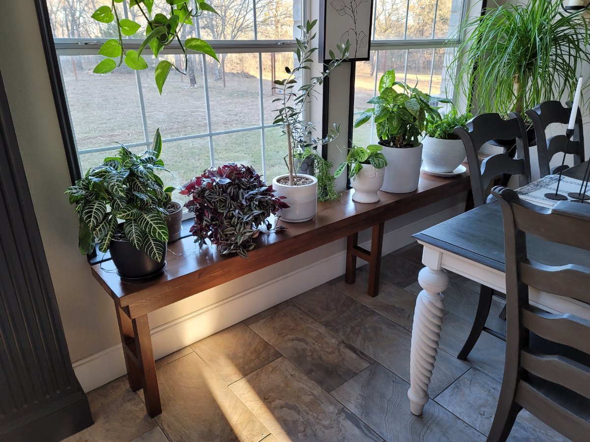

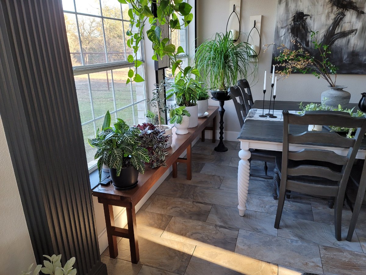

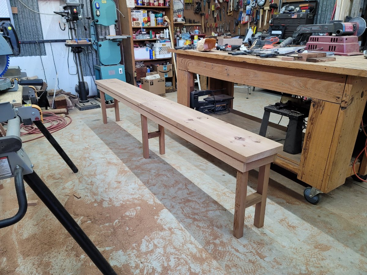

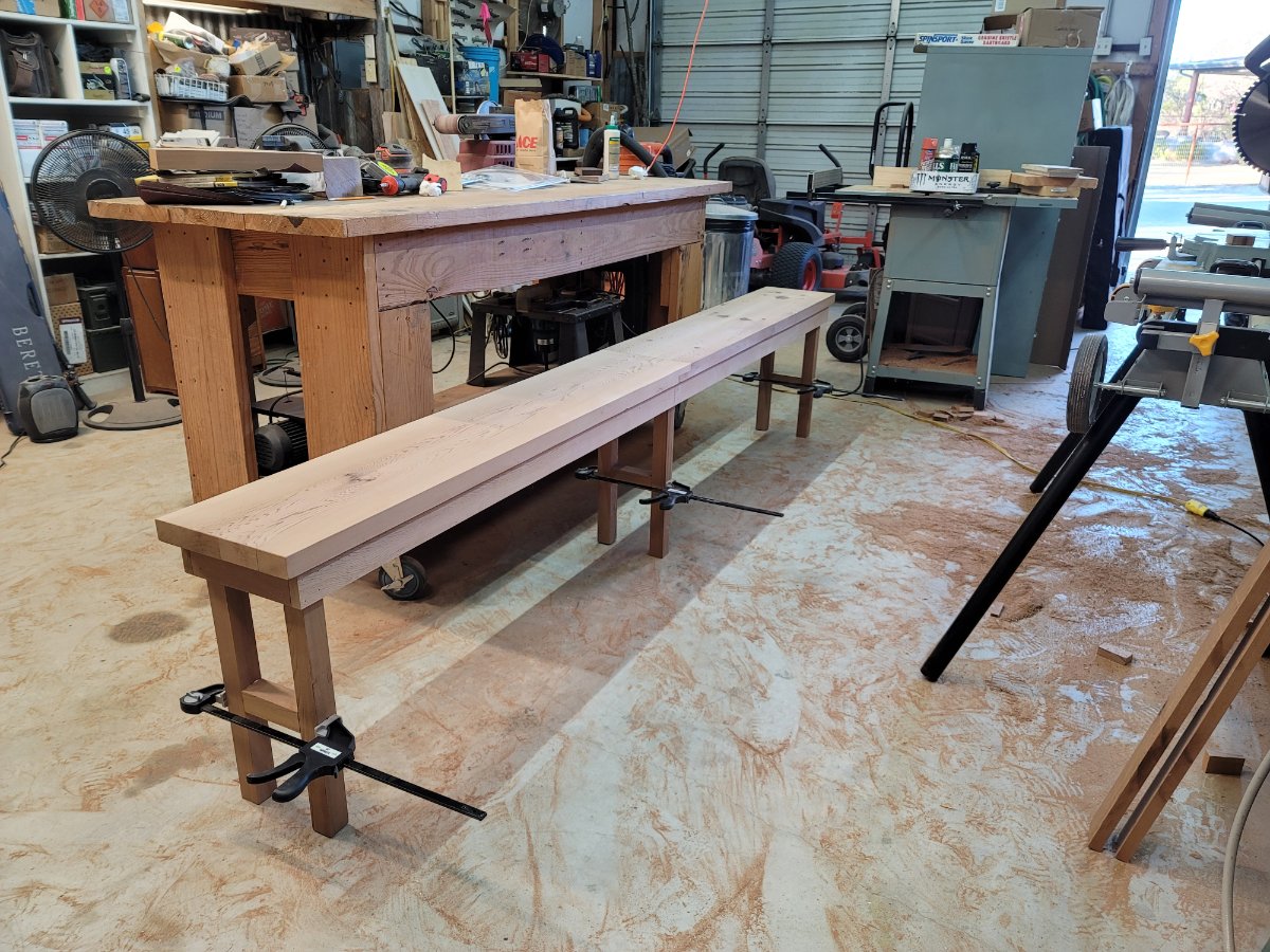

The wife had several plant stands across our dining room windows. She asked me to build a bench to replace all the plant stands - the specs she gave me was 9 foot long, 23" high, and 12" wide. We had a patio cover built this summer, and had some leftover pieces of 6x6 rough cedar - about 5 ft long. I cut the cedar into 2x6s, and ran them through the planer, then bookended a couple of sets together. I used lap joints to make the top pieces and skirt 9 foot long. I then built the skirt and some legs for it. Finished it with some walnut stain and a few coats of poly.

Well Mike, that turned out beautifully. Congratulations. Your wife must be very pleased that she married such a talented husband. :)

That’s a fine looking piece of furniture you’ve made . ::tu::

Turned out great Mike! ::tu:: Well done! ::nod::

D) All of the above
Looks great, Mike!!
As has been said, that's a piece of furniture, not just a plant stand. ::tu::

Thank you, guys. I didn't cost me anything (if you don't include the cost of the patio cover! :lol: ), and the posts were taking up room in my shop. I was getting splinters every time I had to move them around. That rough cedar is rough! :lol:

Beautiful Mike! And you have one heck of a shop there... :wink: :mrgreen:

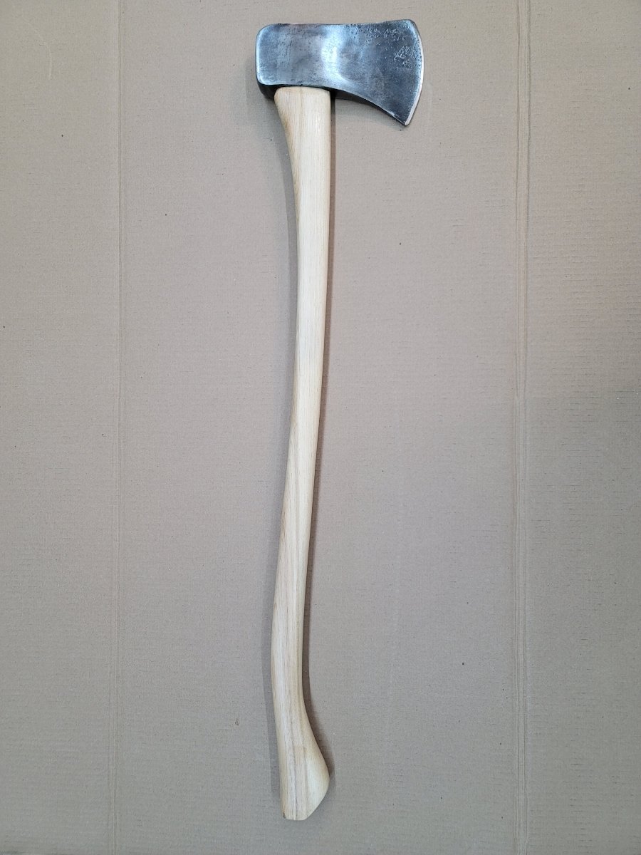

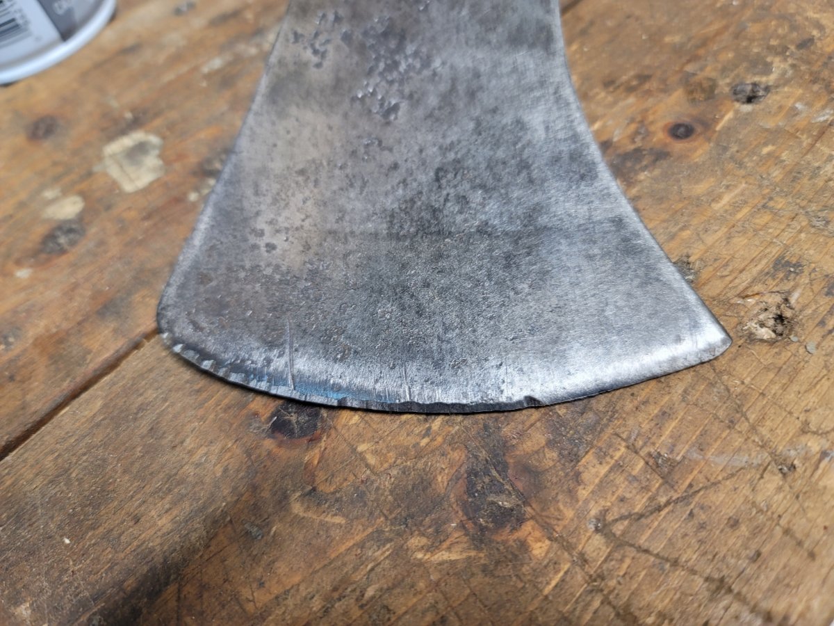

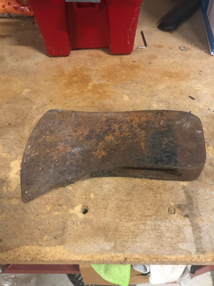

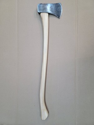

I got a buddies axe up and running for him. Turns out it was the carburetor :lol:
Knocked the rust off with a wire wheel, along with a new edge, handle (store-bought - True Temper Hickory), and a few coats of tung oil on everything. I asked him what he was chopping with it - re-bar? :lol:
I couldn't find a maker's mark or any markings at all on it. ::shrug::

That was a hacked up edge . Nice job on the rehab ! ::tu::

Great work on the plant stand and axe!
