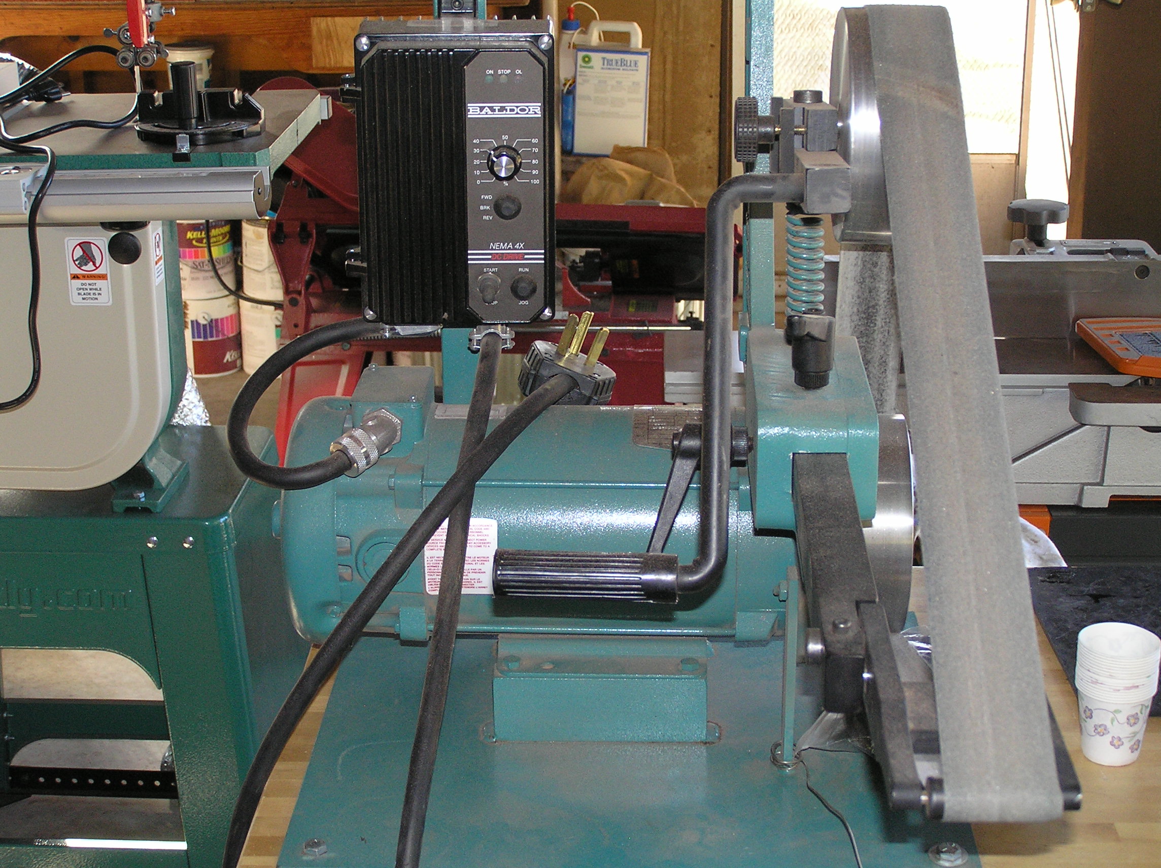

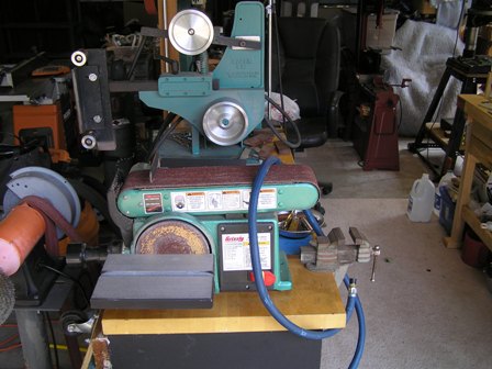

Looks like we may be talking about different grinders. Here is a view from my bench of a 4 x 36 sander/grinder and in background is a 220V 2 HP Bader III with Variable speed control using a 2 x 72 belt grinder with a platen on it - no belt is on it. Wheels for hollow grinding range from 5 to 14 inches. The orange grinder is a bench type grinder - one stone wheel and one wire wheel.
Here is the variable speed control for the Bader with the small wheel attachment
