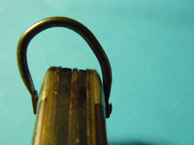

Hi all, I have a Camillus Scout knife in good nick but it has a bent bail.
Looks like it got jammed on something while hanging from a belt.
How do I remove the bail and straighten it.
I don't know if the pin goes all the way through and serves as the end pin or not, I assume
it does, but on second thoughts it can't, can it??
Any help welcome. ::mdm::
cheers Gary.

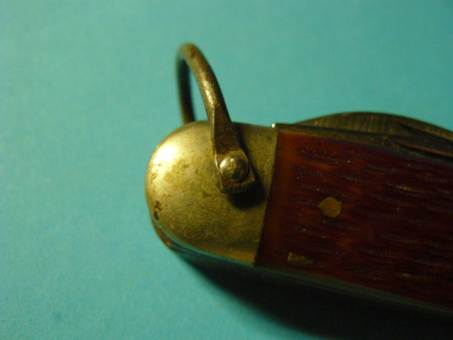

Post by ringergary »
You can see how it's bent to one side like it was swinging of a belt and got snagged, or it's
been jammed of a belt while sitting in a car seat.
The pins aren't loose, just the bail bent sideways.
cheers Gary.

Gary,
That bail is peined along with the end pin.
It looks to be made of brass and should bend easily back into shape.
I have bent ones back into shape by just using two pairs of needle nose pliers.
Wrap the clamping part of the pliers with a lot of tape so not to scar up the bail that much.
If you do ,it will be minor and can be sanded and polished out.
You can also hammer it back into shape but I think that would do more damage than the plier method.
Use a piece of pipe that fits through the bail and clamp it in a vise.
Slip the bail over the pipe and shape away with a very light weight hammer.
I'd try the pliers first.
J W

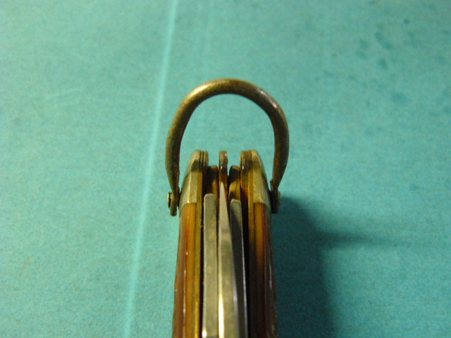

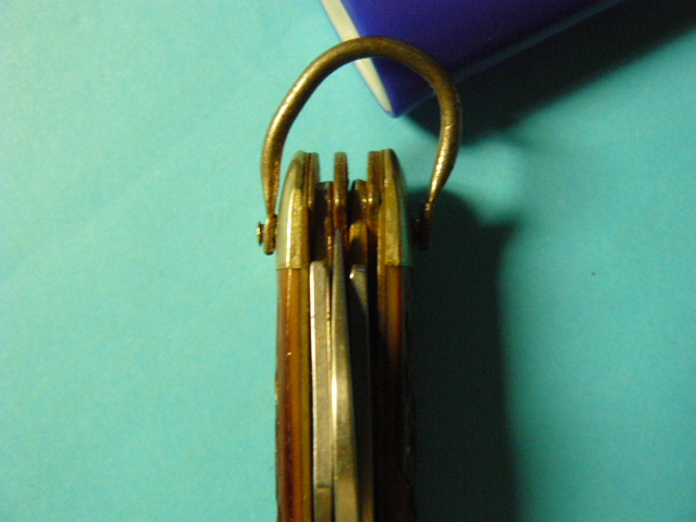

ringergary
Posts: 385
Joined: Sat Mar 19, 2011 4:36 am
Location: North Queensland Australia.
Re: Bent Bail..
Job's done, not perfect but passable for the knife's age.
Thanks to everybody that assisted me in what is a daunting job if you are working
in the dark. ::tu:: ::tu::
It's a lot easier to come here first with a problem and get advice than stumble along
by oneself. Thanks ::groove::
cheers Gary.

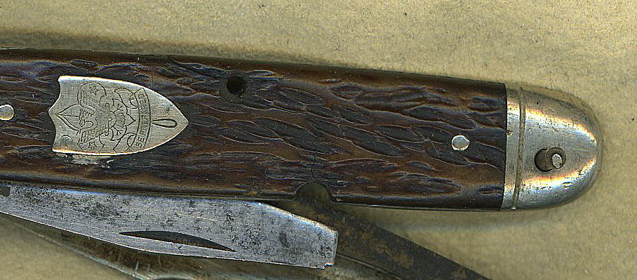

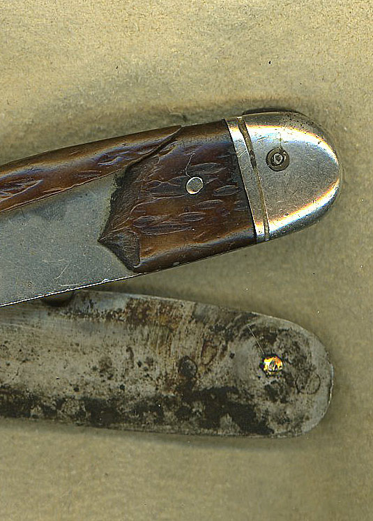

Ok guys,
I found a knife that has the brass tube & inner pin that holds on the lanyard loop.
The knife is an old, pre-1941 Dwight Divine Ulster Scout.
As you can see it is a parts knife.
Notice in the second pic at the bottom you can see clearly that the tube is brass.
The tiny pin that goes through the center is non-magnetic, so I assume it is nickel silver & not stainless given the time in which it was made.
The tube is 3/32” (OD) and the pin is 3/64”.
There you have it. I would love to hear your thoughts on it and any experience you may have had working on them. ::shrug::
