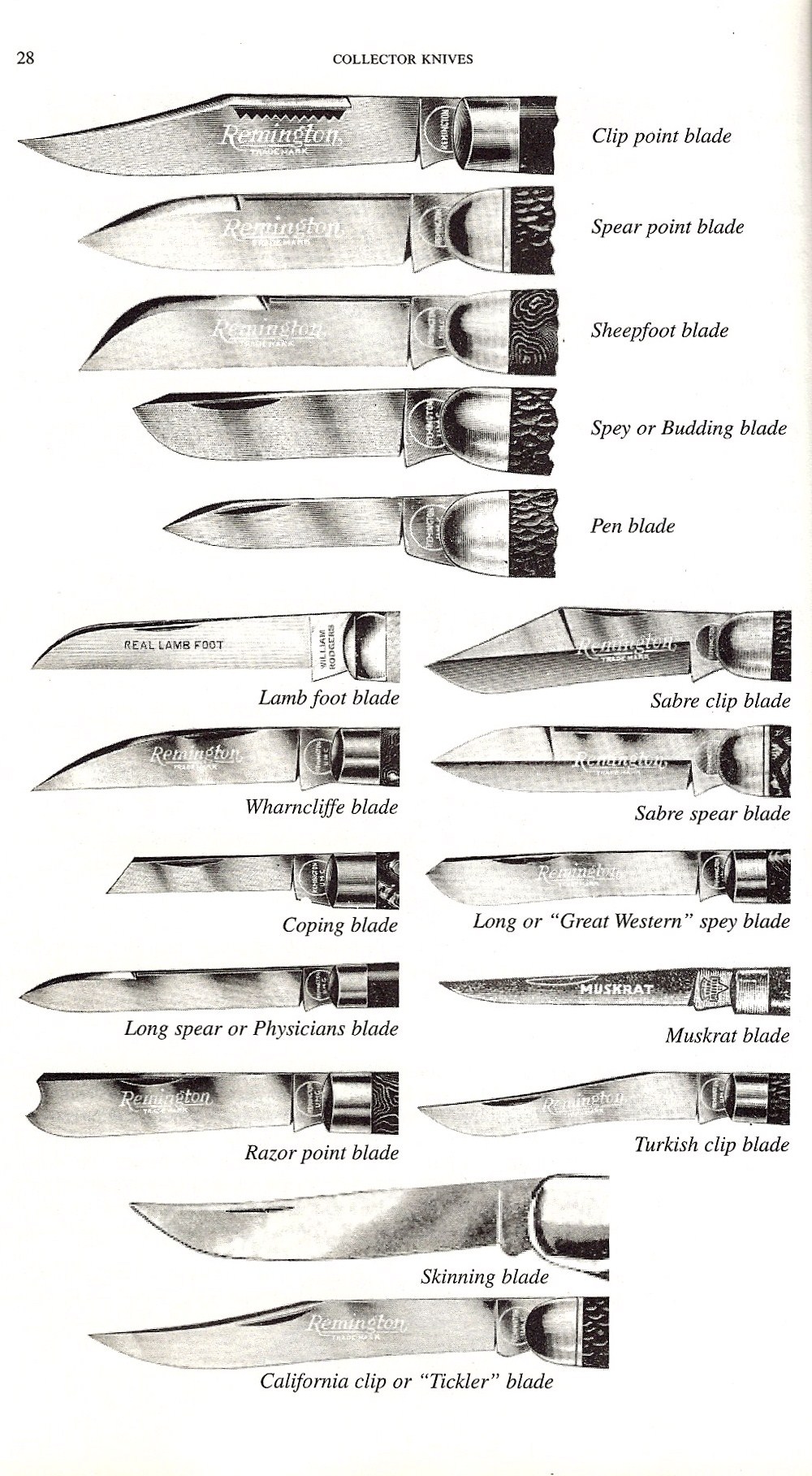

I too have wondered what the original purpose of certain blade profiles were. Something like a coping blade or a spey (spay?) blade is obvious but what about that big ole' round belly blade in a saddle horn knife. Jeez Louise, there are at least a half dozen or more clip blade profiles. I'll be very interested to see some of the answers.
Here are some blades to start with.

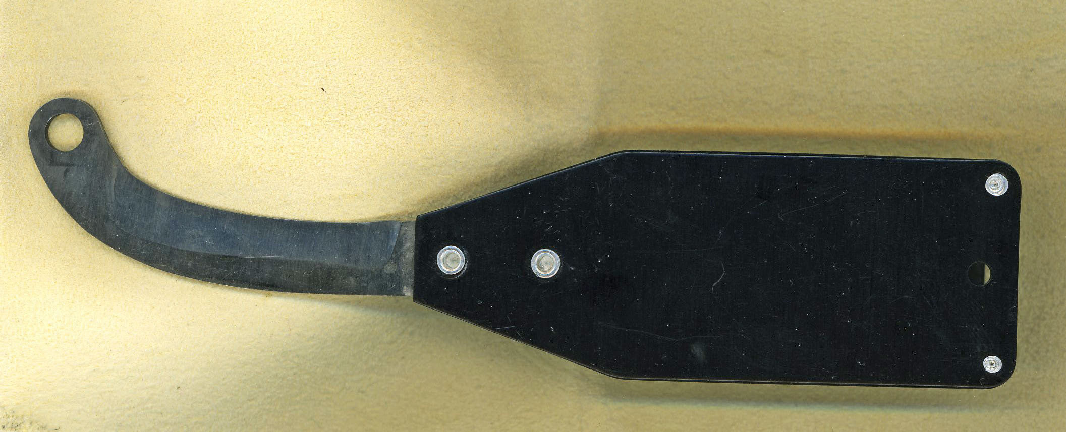

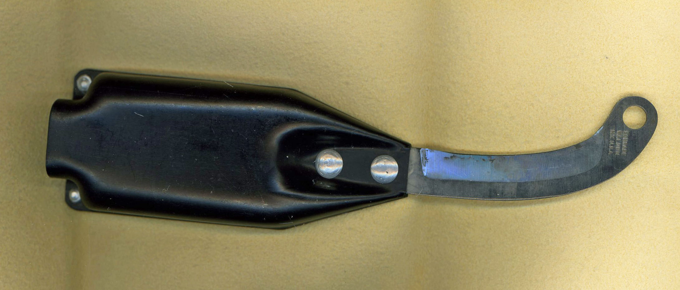

Wouldn't want anyone with a pointy knife in my Life Raft....................

IMBand wrote:Wouldn't want anyone with a pointy knife in my Life Raft....................![]()
IM
Great picture. That knife looks to have been at sea.

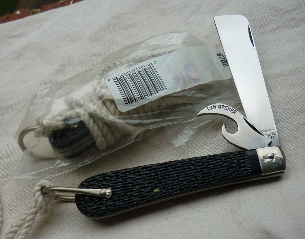

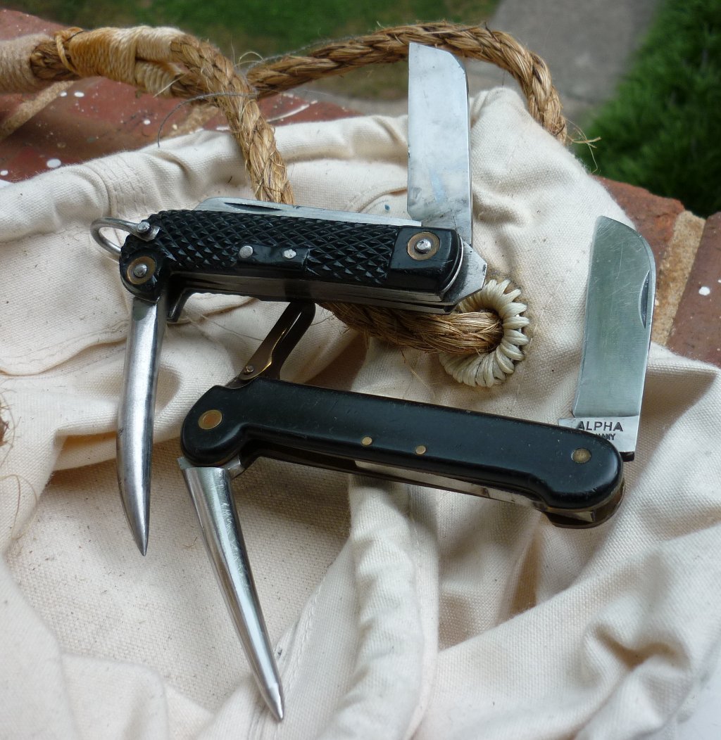

Here's a fun one.
NOT a sailor's knife or yachtsman's knife. No sharp point, yet it has a "marlin" spike.
These were issued to the "Tommies" or soldiers.
The Naval knives didn't have the spike.

The marlin spikes are also very good for opening/closing rigging shackles, esp the locking version.

Owd Wullie wrote:Here's a fun one.
Well I was considering the marlinspike on army knives and it makes sense.
Groundpounders of that day had lots of uses for rope. Horses still were the prevalent mode of transport for the Wehrmacht through WWII. Tents and wagons and cargo on trucks all tied with rope. Splicing rope wasn't uncommon. However combined with the lack of a spike on the navy knife it is really strange to find it with the infantry. Sounds like a bureaucratic mistake which was corrected by changing the milspec.

I figure it was intended that way as the swabbies had access to all the marlin spikes they needed with out having to include one on a knife.jaswarb wrote:
Makes good sense and would allow for restricting the pointy tools to safer areas.

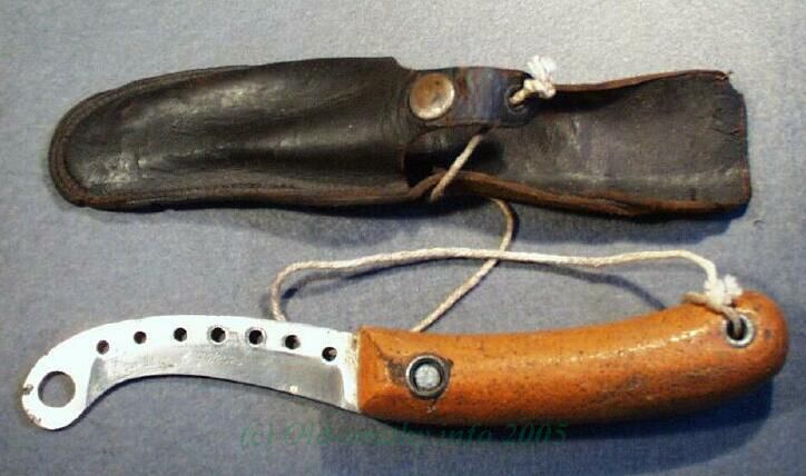

Here is a Schrade Walden lifeboat knife.
These were in the survival kits on the life rafts, as I understand it.

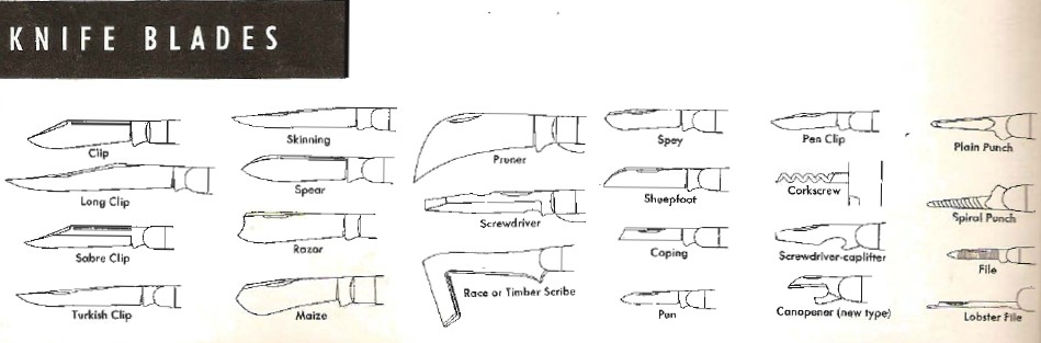

An illustration of Camillus blades taken from a 1965 Camillus catalog.

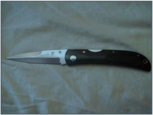

would this style of blade hold up to being used as a pry bar?[img][/img][attachment=0]almar.jpg[/attachment]

sharalds wrote:would this style of blade hold up to being used as a pry bar?
IF you were prying the cover off a pint of Hagen Daas.
No problem.
It looks as though it was designed to pierce vital organs.

The blade design on that Al Mar is designed to pierce.
The false edge on the back gives less resistance when pushing the blade in. If it were a fixed blade the back edge would have been sharpened, but that won’t work in a folder.
Al Mar worked for Gerber before he opened his own company, here in Oregon. Al served in the US Army as a Green Beret and studied martial arts extensively. Many of his knives are fighting knife patterns or variations of them. I think Al called that blade style the “Talon”. When Al was still alive, (he died in October 1992), he did not offer the false edge blade in the smaller patterns like the Hawk & Osprey, as I recall. There really is no advantage to a 2” fighting blade.
Al was a great knife designer, and a good friend.

sharalds - You were just funnin', weren't you.
