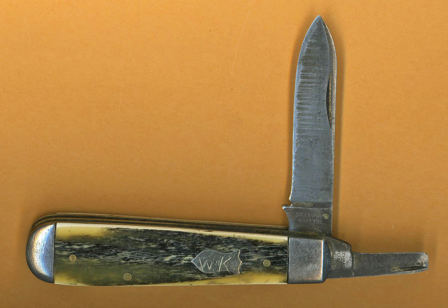

I actually have a before pic on this one, (patting myself on the back for remembering). :mrgreen:
The handle was scratched and the blade had grooves from top to bottom as if someone had used a grinder (Dremel) to attempt to thin the blade or maybe to sharpen?
I removed the broken pen blade and reassembled the knife as a single blade.
There was a tremendous amount of sanding that went into getting the grooves (mostly) out of the blade, also a lot of sanding of the bolsters and polishing of the celluloid. There is also a ding in the celluloid near the pile side rocker pin.
It has such unique celluloid I thought it was worth saving.

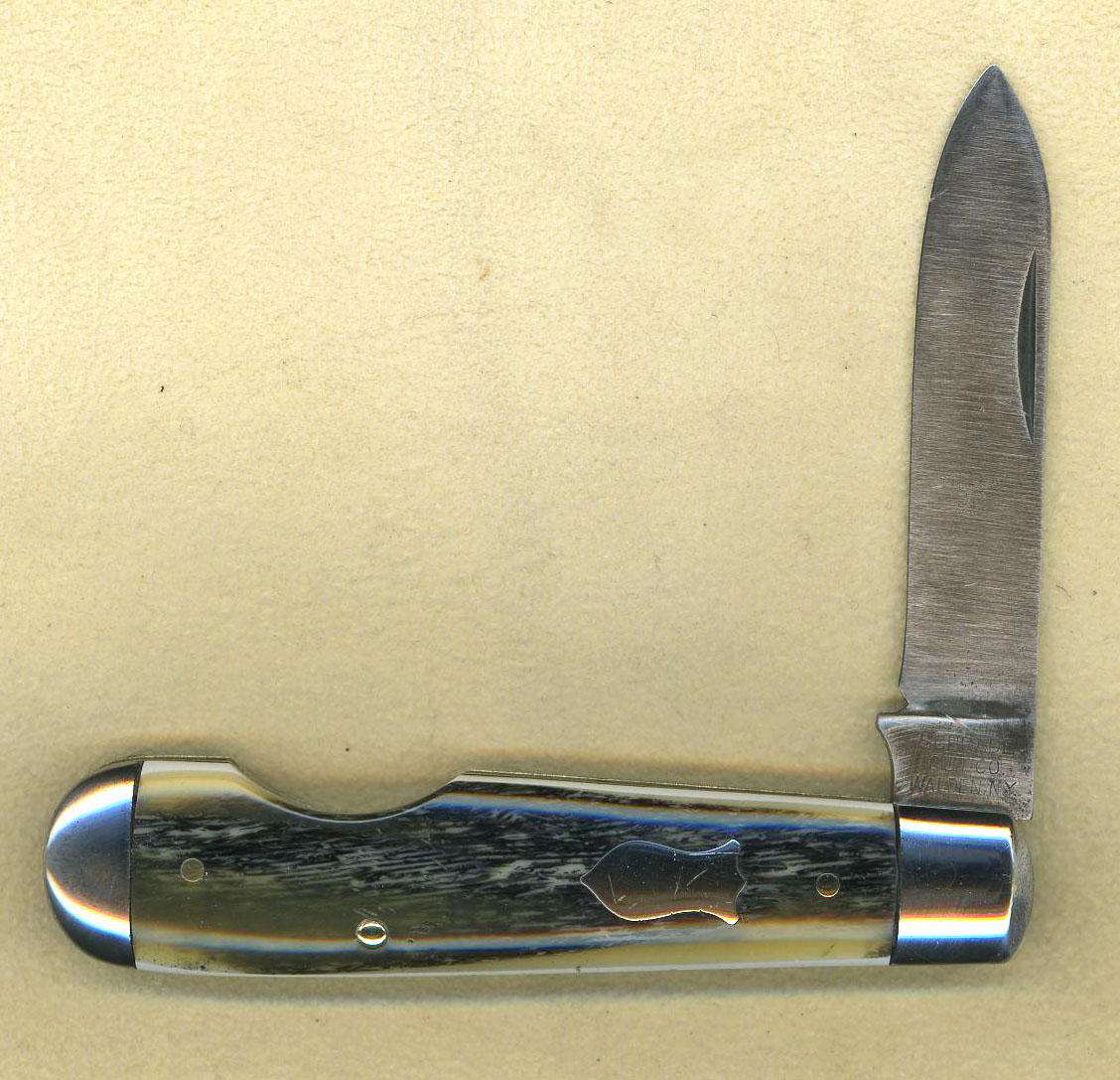

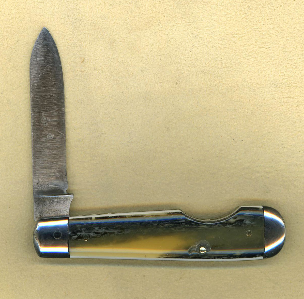

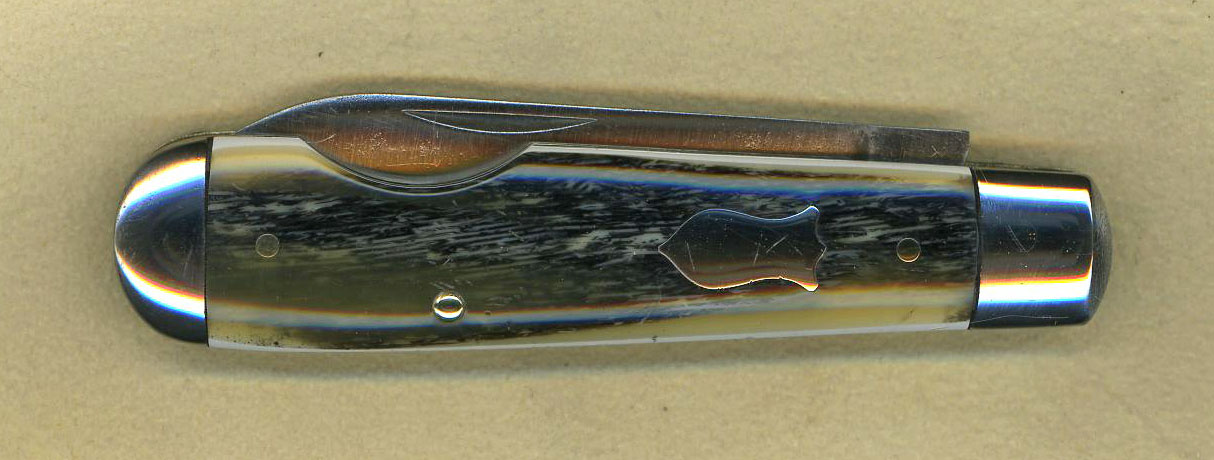

I also decided to make it an easy opener.
This knife is as sharp as a scalpel! :shock:
What do you think?
Would carry such a knife? ::shrug::

Nice save!! I'd carry it with pride.

I think we all like your 'make it a single blade and add an easy open notch' work, Dale.
That is awesome.

Thanks for the nice comments guys.
I haven't decided if I will take this to the show and sell it, or EDC it.
It is super sharp, but it has a stronger snap than I really like. ::shrug::

Dale, are you sure those handles are Celluloid? From Illinois they look like horn but you know how bad my eyes are getting. Or is it how bad your eyes are getting? I can never seem to get that straight. :lol:

So to answer your question, yes, my eyes are bad, but when I polished the handles there was absolutely no mistaking the distinct odor of celluloid! ::nod::
When I bought it on ebay the seller said he thought it was horn, but I have worked with plenty of horn and it smells entirely different than celluloid.

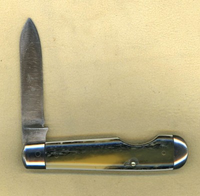

Been carryin this one for 2 weeks now and let me tell ya, Dale's rebuilds are solid!

Wow Perry, I am impressed.
That knife looks a lot better in your picture than it does in my scans! ::tu:: ::tu::

Thanks Dale! It's a great little EO, I carry it everyday and am always playin with it between songs I work on during the day. ::nod::
