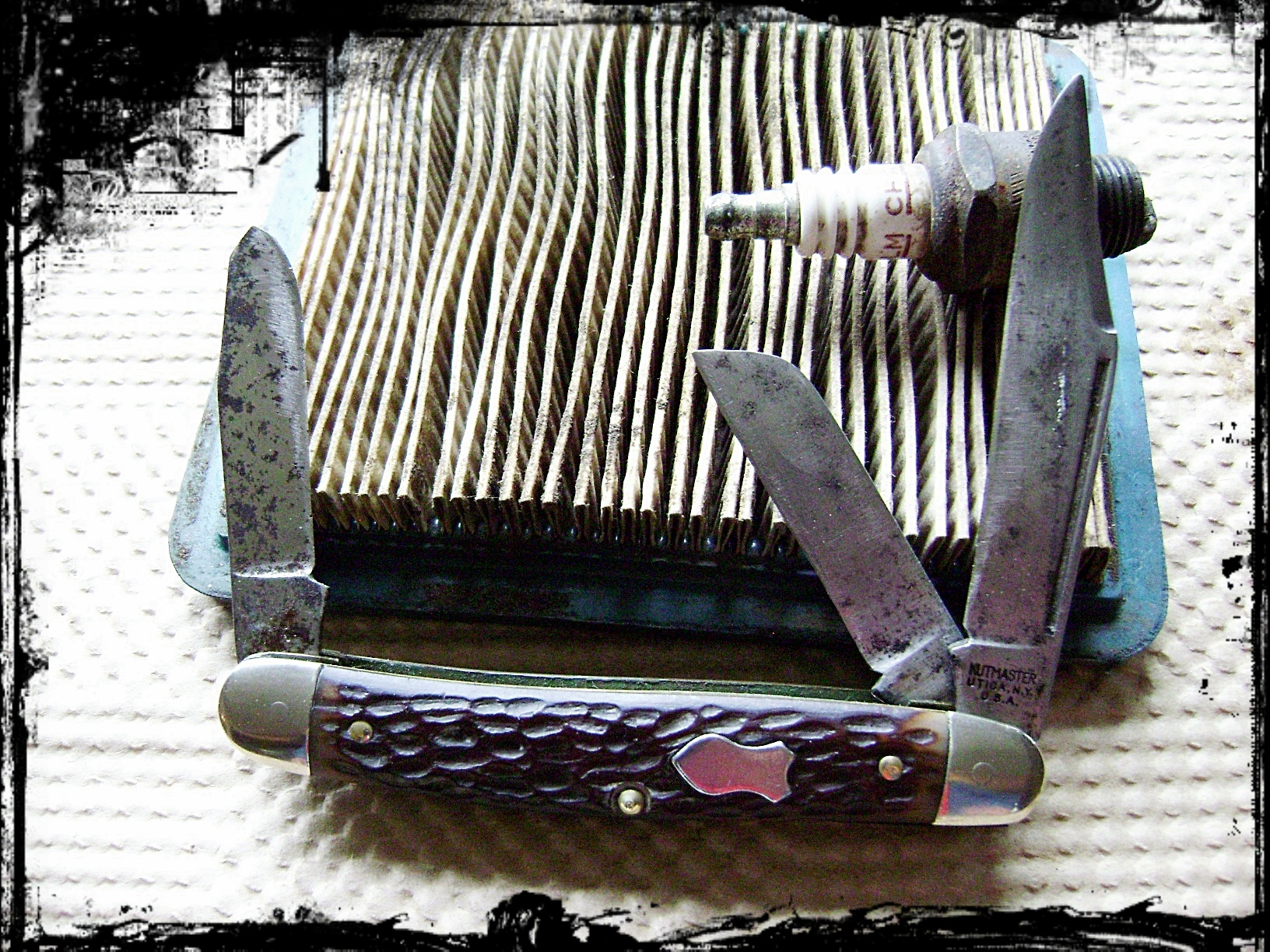

Is your Kutmaster Stockman an older one like this?

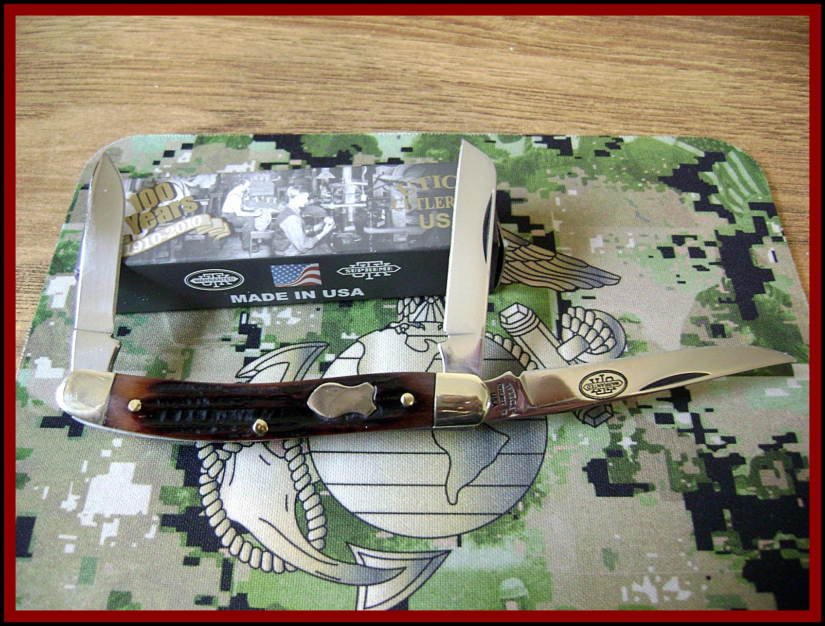

Or a newer one, similar to this?

jerryd6818,
mine's styled more like the older one but no shield on the scale and the tang stamp is different (the "usa" is left justified and has a "0" or an "O" to the right), and the blades 'look' like stainless vice carbon, although it's not marked as such.
The detail on the spey blade is very similar to the older which is looks a little different than most of my other stockman knives (stockmen?)
Chief RID,
i know it's a goofy description, sorry about that -- it doesn't rub on/click over the liner nearest the scale, rather the inner one separating the clip from sheepsfoot blades. it does not catch on the liner when closing... just from the sideways pressure when opening. there doesn't seem to be any damage to the edge indicating past interference, either.
thanks,
Andy
