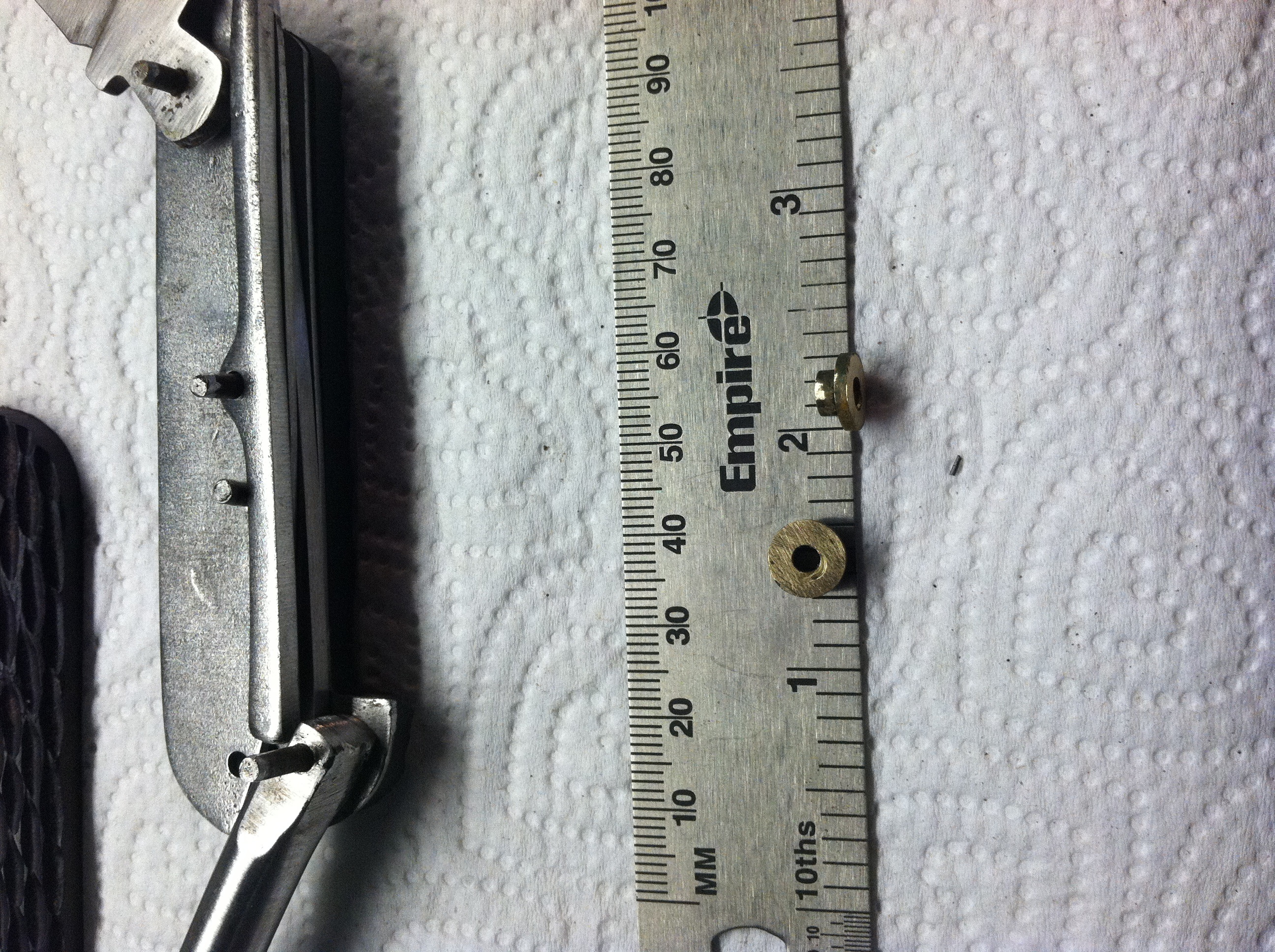

Re: Rigging knife question
Here is a pic Dale. I'm just going to clean em up and use the same ones. No sense making this harder than it has to be.
JAMESC41001 wrote:Here is a pic Dale. I'm just going to clean em up and use the same ones. No sense making this harder than it has to be.
I agree! Not only is it easier it is original to the knife.
Unless I am doing a radical customizing job, I try to use original parts & fitments when possible.
