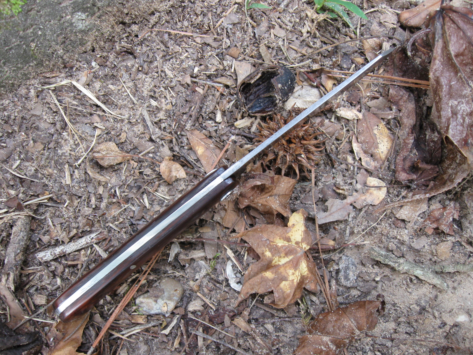

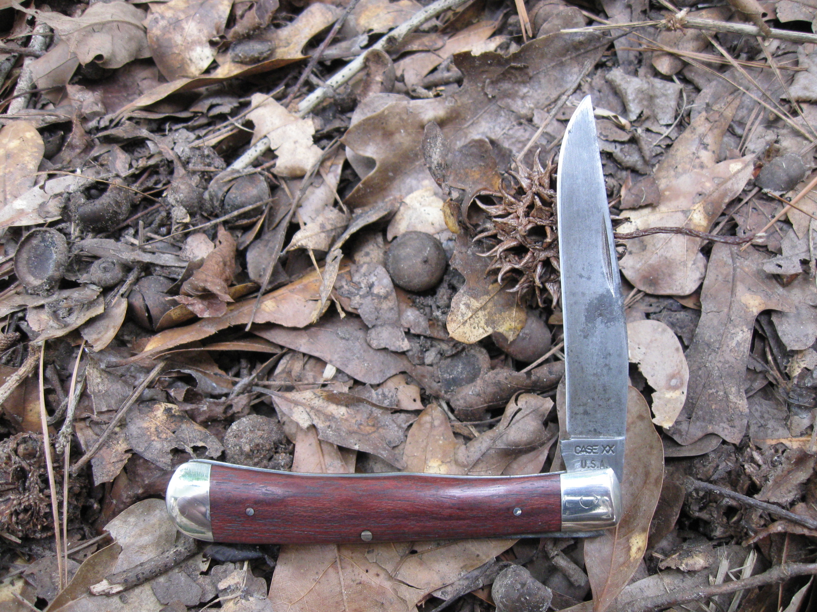

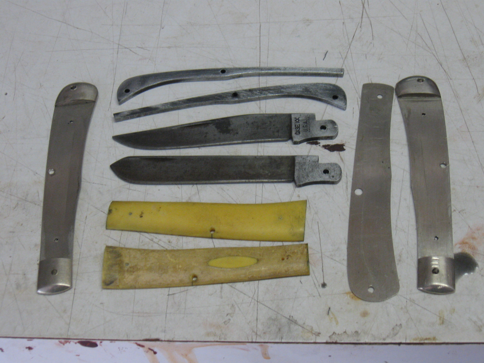

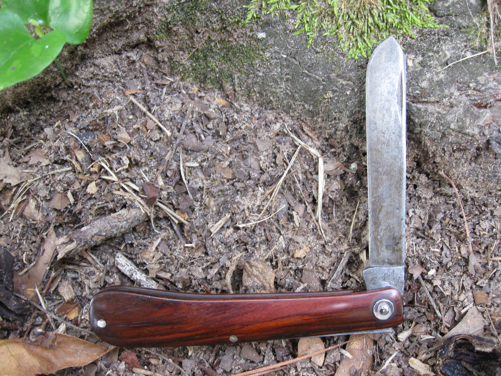

A friend asked me to re-cover this trapper. It had yellow delrin covers and one side was terribly sun faded. I chose to use some Purpleheart wood that I had on hand. While I had it apart I decided to convert it to a single blade. I was able to make another knife from the spey blade that is covered in Cocobolo. I did mess up the pivot hole on the bolster. I thought i was gonna be slick and just quickly hit the hole with a drill bit to knock the burr off. Well the bit dug in and made a nice big chamfer. ::dang:: Peening the pin didn't quite fill it in.

They look good! ::tu::
Did you put liners in the one with spey blades?

no liners

I hope your friend is alright with getting 2 knives instead of one... ::woot::

Nice work on both!

reddirtknives wrote:I hope your friend is alright with getting 2 knives instead of one... ::woot::
hahaha. i thought keeping the spey blade. you know. a mechanics lean kinda deal :)
