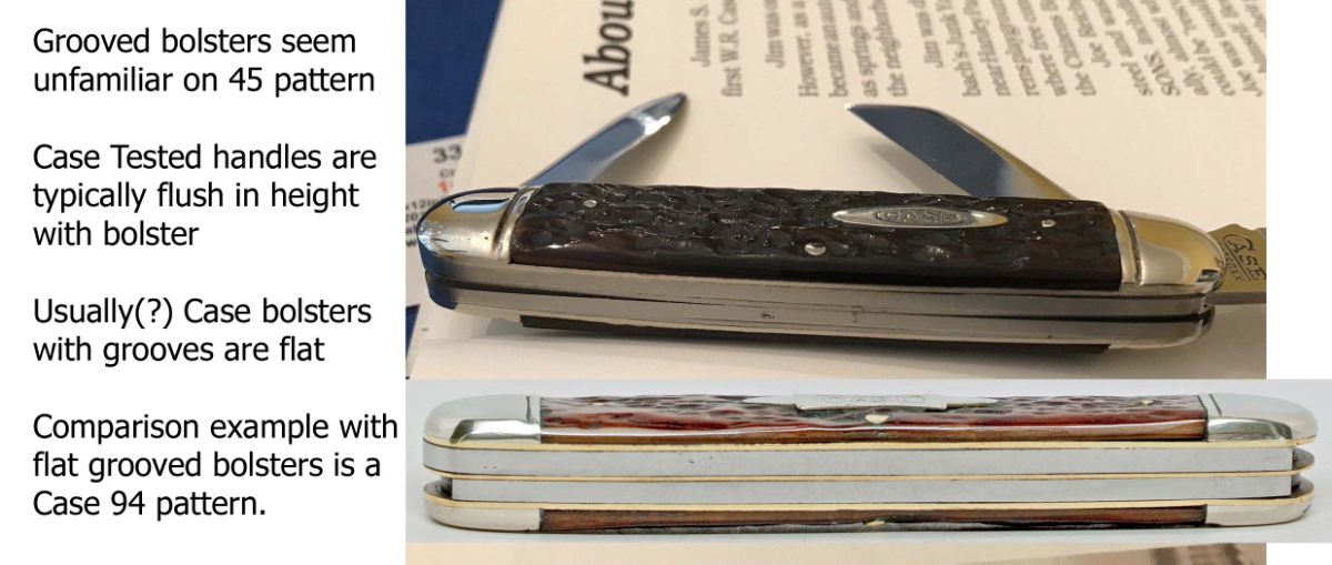

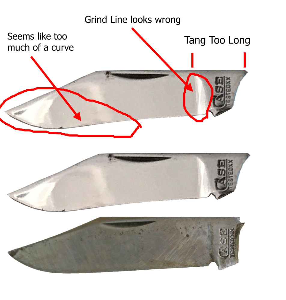

Any thoughts on this example? It looks questionable to me for the reasons highlighted in pictures. The bottom blade is from a reference Case Tested XX 63045 1/2. The 6345 1/2 example I have all have long pulls.
https://www.ebay.com/itm/Vintage-Case-T ... 1438.l2649

Master tang looks shaved.Good heads up Jerry.

"Questionable" would be a compliment - it is an "across the room" fake.

Great knife for those that like to read the writing.
Read Master blade - CASE
Read Pen blade - CASE
Read Sheeps foot blade - CASE
Read Shield - CASE
Read the knife - FAKE

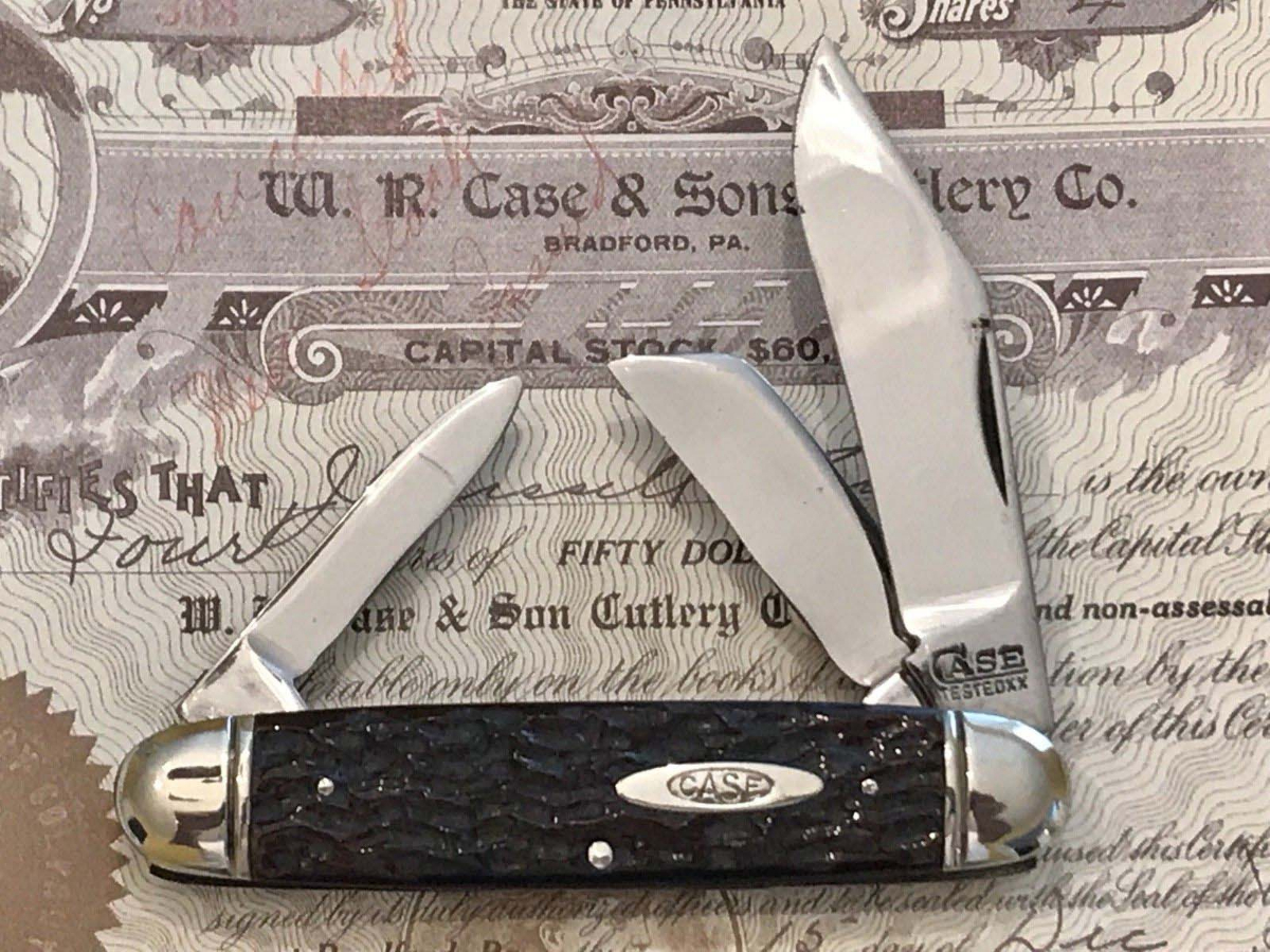

Why is it always a 45 1/2, I have had one for some time that is kept in the worn-out roll. Since we are looking at 45 1/2, look this one over. I hope my AAPK friends can give me some knowledge on this one, I have always questioned it even though it feels nice and heavy in your hand.

Jporter your knife looks fine to me. I can’t tell if handles are bone or composite. When I get back to my big screen computer I’ll take a closer look at the pictures.

OP knife is easy to spot fake.

Jporter, yours is authentic. Looks like jigged black composition. I believe that it may have been a military contract knife.
