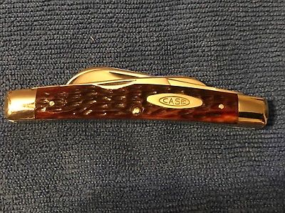

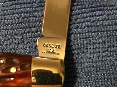

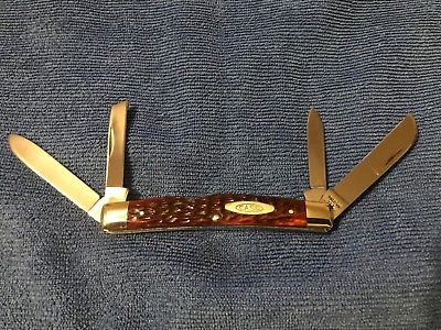

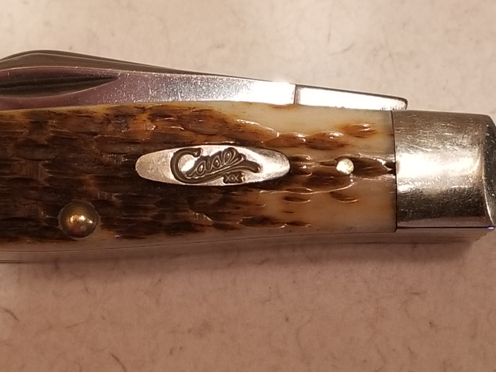

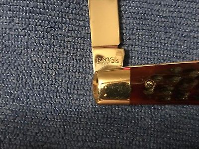

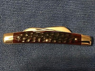

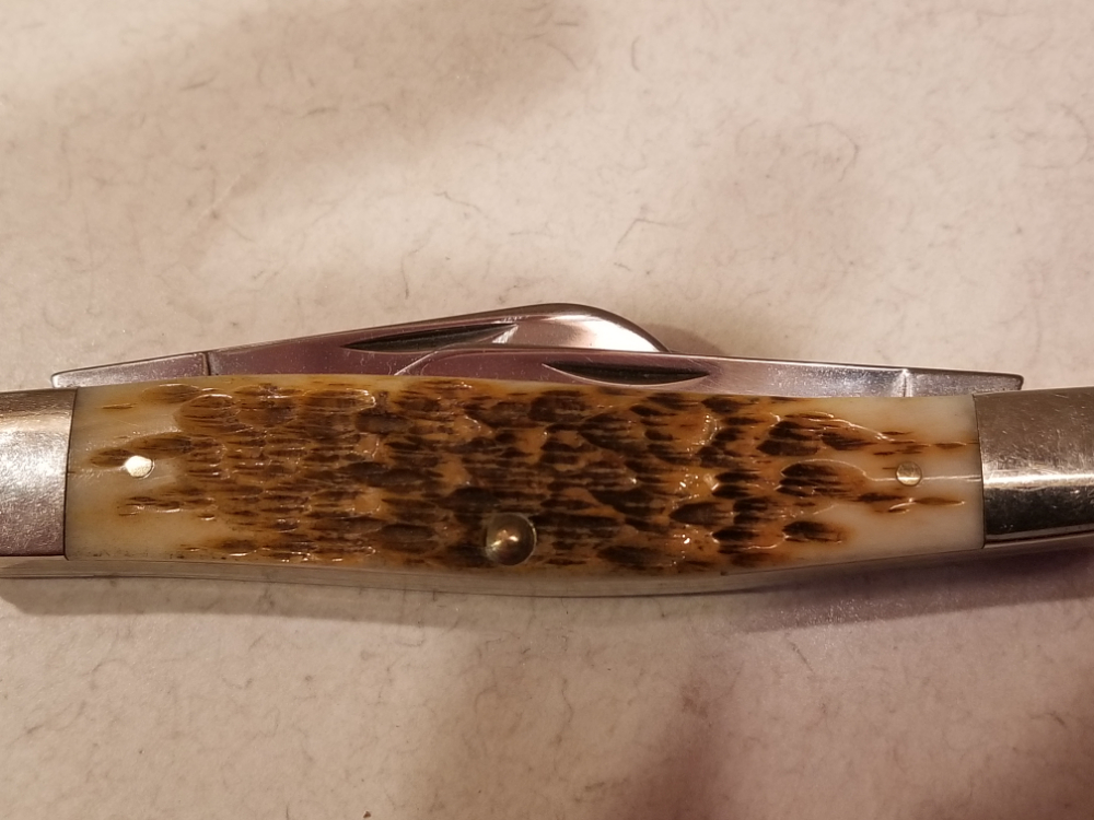

Anyone else think this knife looks odd? The jigging on the front handles looks odd to me.Everything else seems ok.Any comments?

I dont necessarily think its fake, but why does the jigging go all the way to the bolsters on the front? I have several congress knives and the jigging stops right at the pins on each side.Can someone explain?

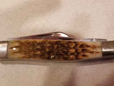

Pretty close on my 75

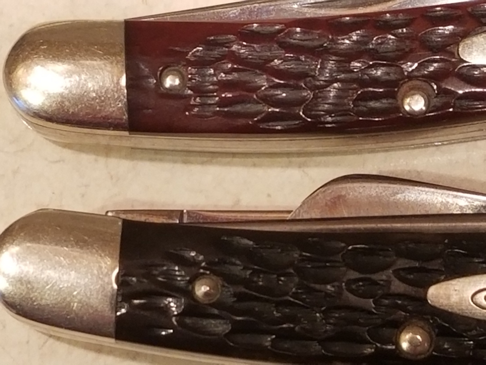

These are both '70s knives.Steve Warden wrote:It happens 20181216_134231.jpg

The OP knife looks okay to me. The jigging is Case.
Bone handle covers are cut, jigged, and dyed before being assembled onto the knife frame. Then they are hafted (a type of grinding) and polished to produce a smooth fit junction with the bolsters. The bone comes from the shinbone of a cow - it's a natural material so slabs are not in uniform in thickness from slab to slab. How far the jigging ultimately extends toward the bolsters is simply a function of how thick the bone slab is. If the slab is thick more material has to be removed during hafting, thereby removing more of the jigging.
