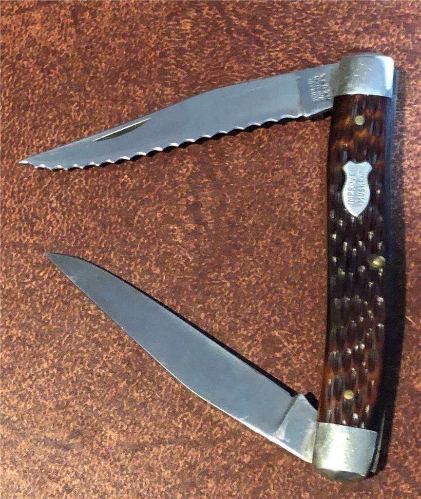

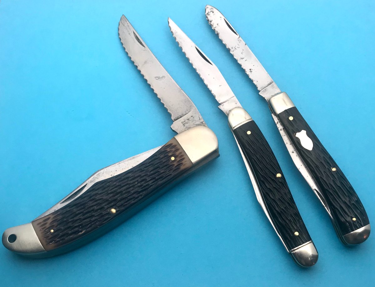

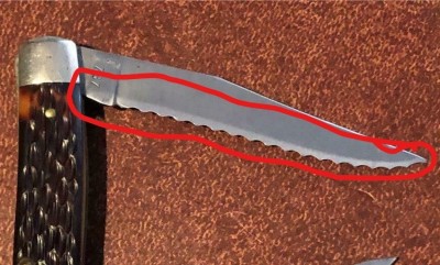

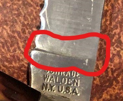

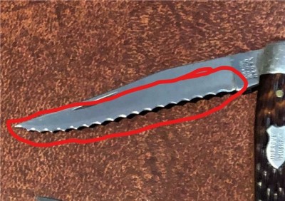

Today we study a 787 wonda blade knife.
https://www.ebay.com/itm/OLD-SCHRADE-WA ... Sw8lpeUvau
Everything on that knife is Schrade but it’s two knives put together from two different eras. The 787 wonda edge was made in 1957 & 1958. It’s a single spring knife with rounded, threaded bolsters and bone handles. They are rare as hens teeth. Here is what the knife looks like: The knife being sold here is a double spring Delrin knife made sometime between ’62-’73. That knife was made with the Swinden key system but when it was doctored it was put back together with pin through bolsters as seen here: Schrade made three multi-blade folders (225, 293 & 787) with wonda edge blades as secondaries and they never tang stamped the wonda blade on any of those knives. The reason this 787 has a tang stamped wonda blade is because the blade was welded onto that tang, but I’ll circle back to that in a moment. Also notable is that the wonda blade is on the right when looking at the mark side of this knife. The wonda edge blade on a correct knife is on the left side. There are already enough red flags to label it a bad knife but there’s more. When you look closely at the base of the blade right above the tang you can see a horizontal line of perfectly round circles, the most prominent being the center one. There’s only one reasonable explanation for them given the context – they’re marks left by the electrode when it was welded. It also appears to have hammer marks on the back of the tang. It’s also curious how the patina ends abruptly just below the stamp on both sides of the tang. If you stuck the blade into a piece of fruit to force a patina but left the lower portion of the tang exposed, seems like you’d have a patina line like that. It’s a little harder to see on the front, but on both sides of the blade the patina is lighter at the edge. Maybe it was sharpened after the patina was added? *Pro-tip: you’re only supposed to sharpen the back edge of a wonda blade. Whoever monkeyed with this knife didn’t know that.
It’s doubtful many (if any) ebay followers would catch these flags and there will always be those who will choose to believe it’s a legit knife despite all signs pointing in the other direction. All good, to each their own – I’m not trying to change hearts and minds here, just documenting the situation.
A common reaction to knives that don’t look right is ‘why would someone fake this knife’ but right here we’ve got a 787 that would get around $25 if it wasn’t turned into a wannabe wonda knife. How much do you figure it will go for now – ten times that amount? Twenty times that amount? Stay tuned to find out.
Maybe the seller unknowingly bought a group of knives from a bad guy. Maybe it’s from the estate of a collector who made frankeknives for fun. Maybe the seller is out in his garage right now practicing his technique to hide the circles better. No way of knowing but now that the knife is revealed as an ‘aftermarket creation’ (I’m being polite – it’s a forgery) I’m curious if that info will trickle down to the folks on that auction who are bidding right now on what they think is a legit – and extremely rare knife.
At the time I'm posting this the auction has 16 watchers and six active bidders.

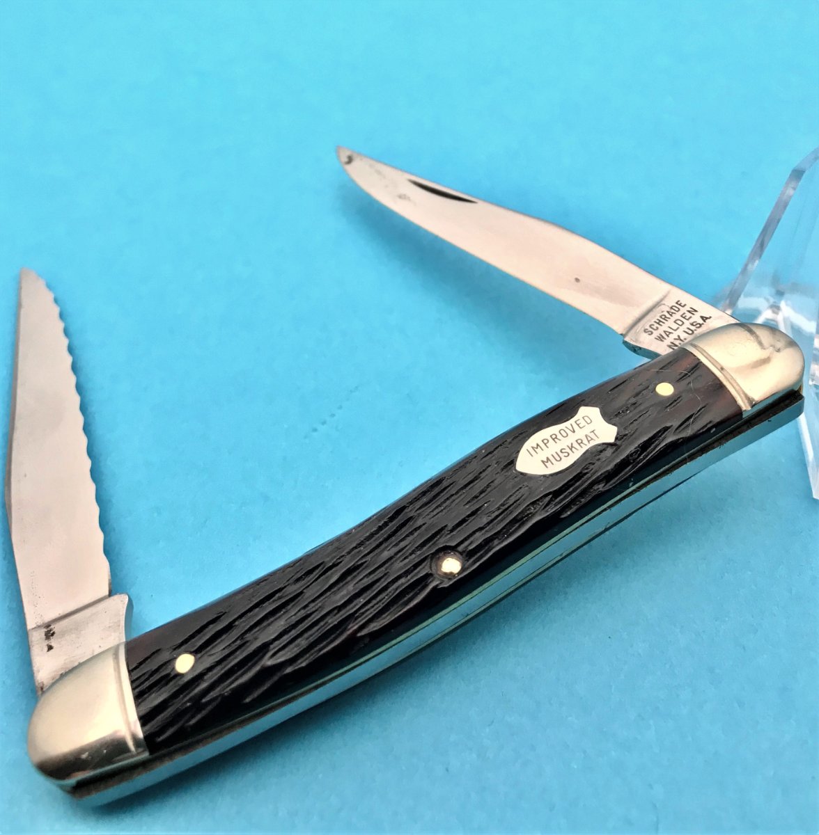

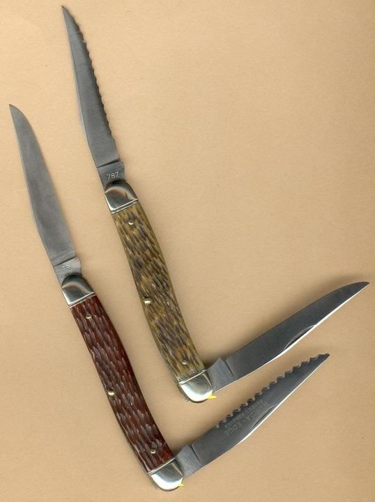

Jason, it would have been nice of you to send me a note on EBAY and share your knowledge with me. Instead you chose to call me a faker with a play on words with my seller name. I do not appreciate that. I would never even have considered they would fake a Schrade with Delrin handles. WOW, I can't believe that. I will take a really good look at the knife when I get home from work & if it looks like you are right I will end the listing. Are you a Schrade expert? You posted that the Wonder blade was never stamped but with a quick search I found one on blade forums. So you are wrong there my friend.
Gunsil, thank for the kind words, I don't remember us ever having a problem,sorry to hear that. Please send me a message & refresh my memory. I did just buy that knife at the Lewisbug show Saturday, seller wanted 40 bucks & I remember having one a while back that went for good money so I jumped on it.

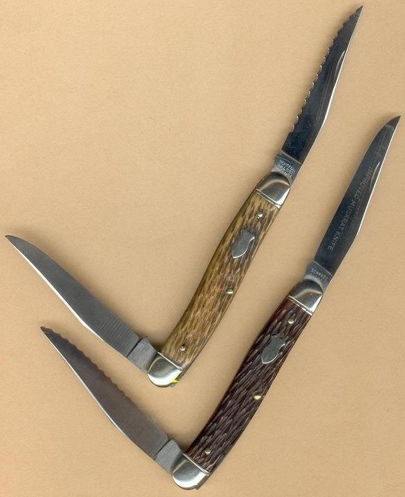

Here is a pic of the knife I found on the net And a link to the thread, it has the round bolsters and is stamped on the serrated blade. I do believe there are always exceptions, & transitions where they used older parts. There are certainly fakes too & I would never sell one knowingly, I am not out to screw anyone as Jason suggested & I don't work on knives in my garage nor would I have any idea how to weld a freaking blade. I will do some research on the knife & take the appropriate action.
https://www.bladeforums.com/threads/var ... at.431458/

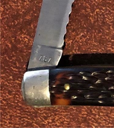

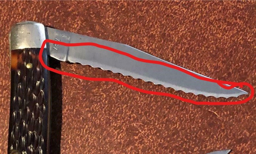

I don't see any welding evidence or pin through in these pictures. They're just not clear enough to tell if it was welded and if they did that good of a job. With the knife in hand maybe something could be seen but I really don't think there's anything there. The haze on the edge is very common when they were factory sharpened and they hit the edge with a buffer for the final touch. It's most often seen on the stainless walden era knives.
There were many knives that schrade made but did not catalog, and they also made changes without notification. The wonda edge being on the main, perhaps uncommon, is not enough of an oddity to say it couldn't be factory. There have been stranger things from the schrade factory. Examples of a wonda edge main have also been seen. There is nothing that points me in the direction of it being non factory original. It's also very unlikely that somebody would fake a delrin schrade and go to the trouble to do a really good job at that. Even old bone handle schrades are rarely faked and they are worth much more than delrins.

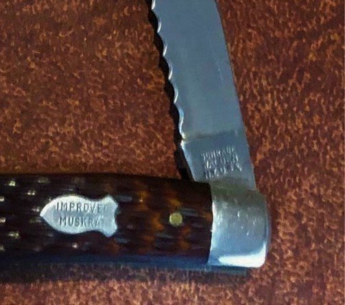

I looked at the post on ebay ( I even bid on it to follow ) I see no evidence of welded blade with the few pics, if it's welded blade best job I've seen - replaced blade is easier to get by with I think - I'm like Itsakiller I might cleanup a knife a little but don't modify them, I wouldn't even know how. I mainly collect what I call retro Schrades usually with the tube or box and I know Schrade made some unique knives at times for short periods , etc . I'm sure ITSAKILLER will look the knife over and make us more informed - I don't know any of you, but I don't think either reputation is in jeopardy - I do like discussions on knives how else can we learn - all that said I kinda like the knife

I think this knife is an all original Schrade. There are always 'odd' Schrade knives that show up that nobody can recall seeing before. This is due in part to Schrade not wasting old blades or parts but assembling them into finished knives.
I think the OP might be 'over reading' this knife. I do not see evidence of welding and both ends might be pin through construction.
I would like to see a cutler, especially one who worked at Schrade, comment on this knife. Knowing how work happened with making & assembling knives would give insight into how this knife came to be and therefore whether it is legitimate or an after factory fake.

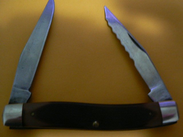

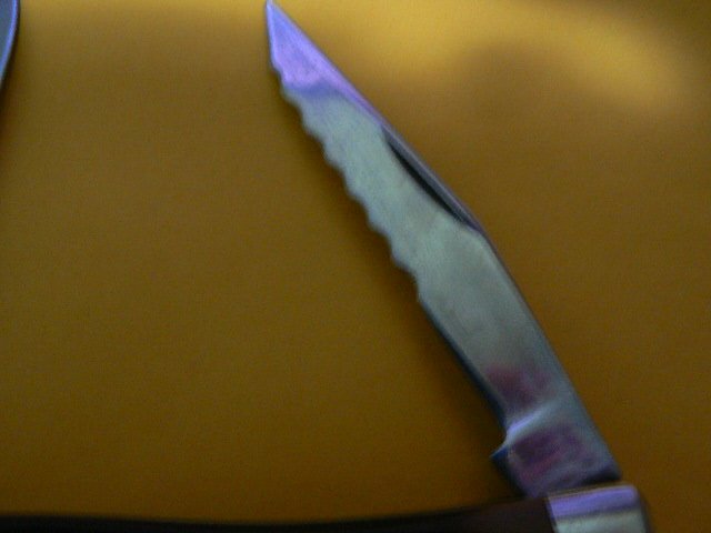

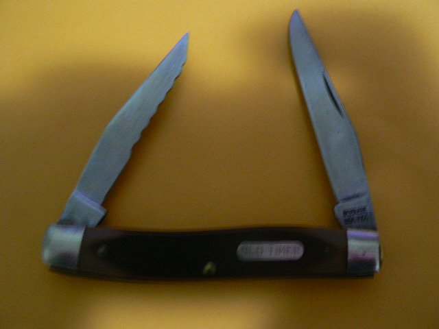

I purchased this knife about eight years ago.I purchased it from the son of the original owner.He stated the the knife was purchased new by his father with the serrations.
Schrade USA 77OT .Sorry about the poor pictures it's still night here.
Grant
Grant

I'd rather keep the conversation on the knife but I'll answer you first. If you'll look at the second post on this thread you objected to me using the itsafaker reference. The next post is me telling you it was directed at the knife. Several posts down you again said it was about your friend and slanderous. After that is when I told you that you already knew what I meant. Can we get past that or am I being cranky? Sounds slanderous to me..Gunsil wrote: ↑Tue Feb 25, 2020 9:50 pmThat may be the way you MEANT your sentence to come out, but if you re-read your original post it sounds like you mean the seller not the knife. Are you just a cranky old guy? I most certainly did NOT know you meant the knife by your own use of the English language when I wrote my original post. I do not write to annoy. One more thing, George has handled and inspected many more knives than most members here for many years and has never knowingly sold a bad knife that I have ever heard about and I have known him for over thirty years. I also agree that it COULD be possible but quite unlikely that anybody would bother welding up a blade on a Schrade delrin knife.
I hope Eric weighs in on this one since he worked for Schrade and knows more about their later knives than most. I like the counterfeit watch but have also seen good knives posted as bad knives by members here. He who calls a knife bad has to have indelible proof of his/her statement. This knife in particular seems to have a few guys believing it is original and I too see no signs of welding.
I know who Eric is and I know his qualifications (and apparently I know his resume better than you do) and if he stops by and schools me, then so be it. His is probably the only opinion I would take above my own in this thread - and for that matter do you realize that I'm the only one who has actually offered an opinion so far? The members who believe the knife is legit have not said why. Not one of them. Would you even be here if it wasn't your friend who owned the knife? Seems like the counterfeit forum is a great resource unless someone you know gets called out. I knew this would be the case and it has no influence on my opinion.
Let's get on to the knife. You believe that the knife is factory. Not because it's your friend's but because you legitimately believe that right? You have doubts about why someone would do this to a Delrin knife. Why does the motivation matter? Lots of people take broken knives and make a good one out of the parts, or maybe it was created to commit fraud. Not for nothing but that is a $25 knife that will likely sell for a lot more money because of the mod - so in this case the Delrin angle doesn't really apply in my opinion.
Since the welding seems to be the sore point I'd like to hear your theory. If you look at the pic you can't miss the circles at the base of the blade. Given all the other factors I came to the conclusion that I was probably looking at leftover marks from the electrode. Since you see no signs of welding, what do you suppose caused those scars?
