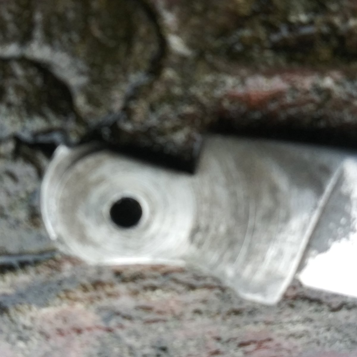

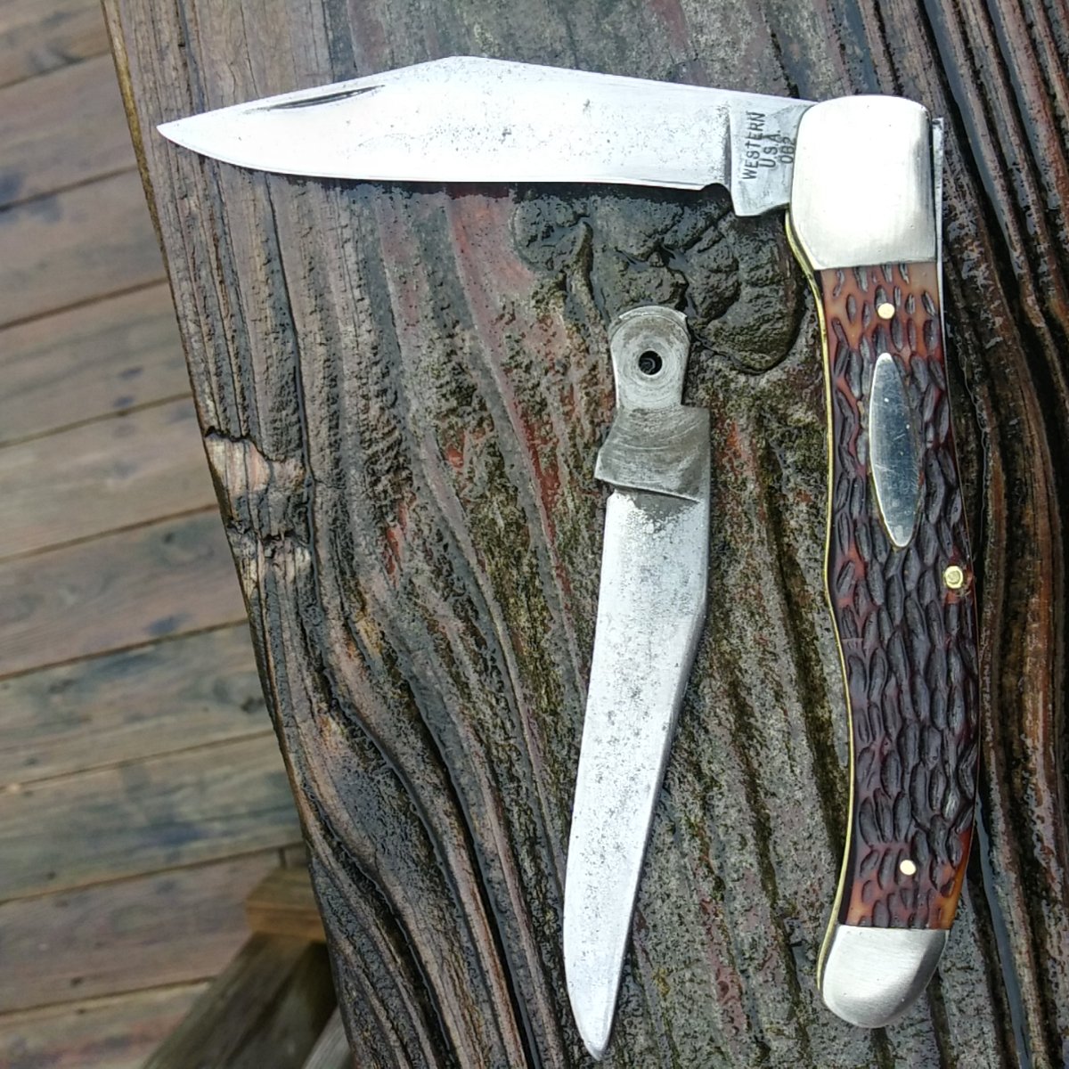

Got this Western 062 for 6 bucks off EBay. The main blade was tipped and the second blade had no snap, which the seller disclosed.
I cut it apart, reprofiled the main blade and reassembled as a single blade. That thing is slim now! You can see in the pictures why the secondary blade had no snap. The tang had worn into the spring and was ground away.

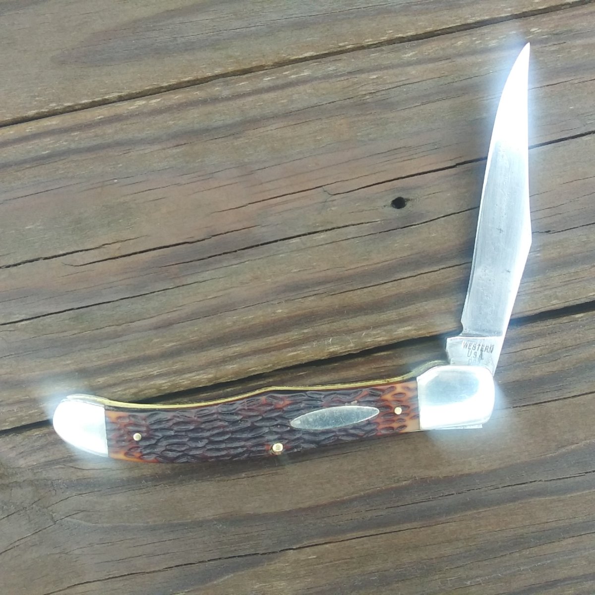

Thank you all! I've always liked these Westerns as well and this one will be a carry for sure!
Request for help/ideas about the blade. Since it was tipped I just filled the top edge until I had another tip.
Although the blade is useable I'm not satisfied with it's looks. What can I do different with it?

Re: Western 062
at first glance..... I don't see a problem with it. The profile looks nice.
What makes you unhappy with it?

Re: Western 062
Problem solved! I made a toothpick out of it! I lost the nail nick, but it doesn't look so chopped off now. I might get the courage to use my Dremmel and a cut off wheel to cut another, but I'll see. I might just leave well enough alone!

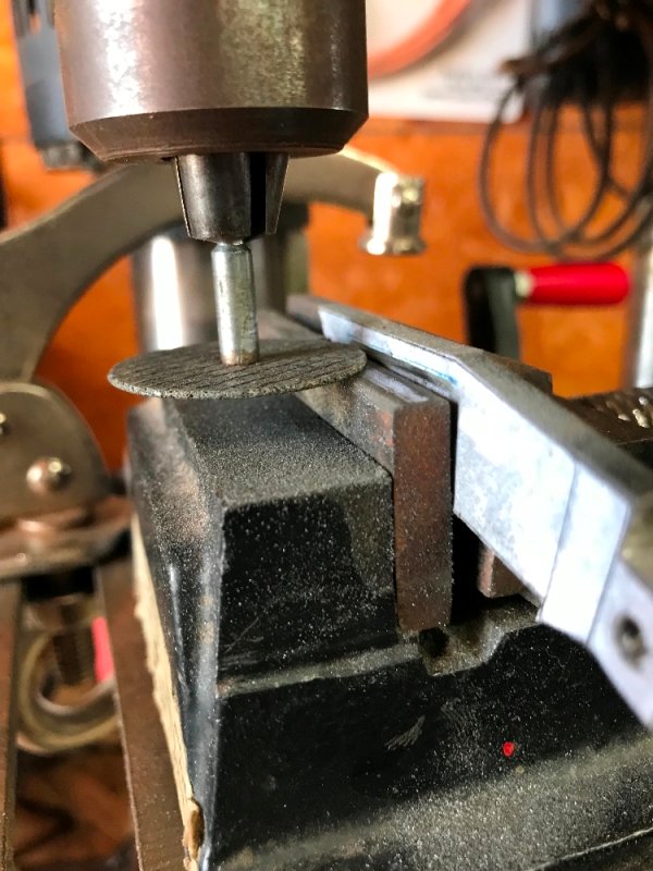

Here is a pic of another method.....
(just for your reference)
I can't find the thread but here is a pic I saved to my hard drive that explains it.... Not my pic... I can't remember who showed this method.
(It sure sux to get old and forgetful....)
Anyway..... this pic was from a knife mechanic here.
This way, you put the knife blade in a vice and everything is in a FIXED position except for the sliding of the vice.
It worked great for me!
