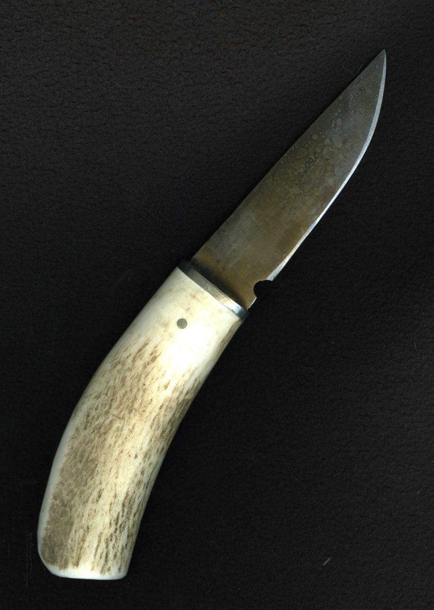

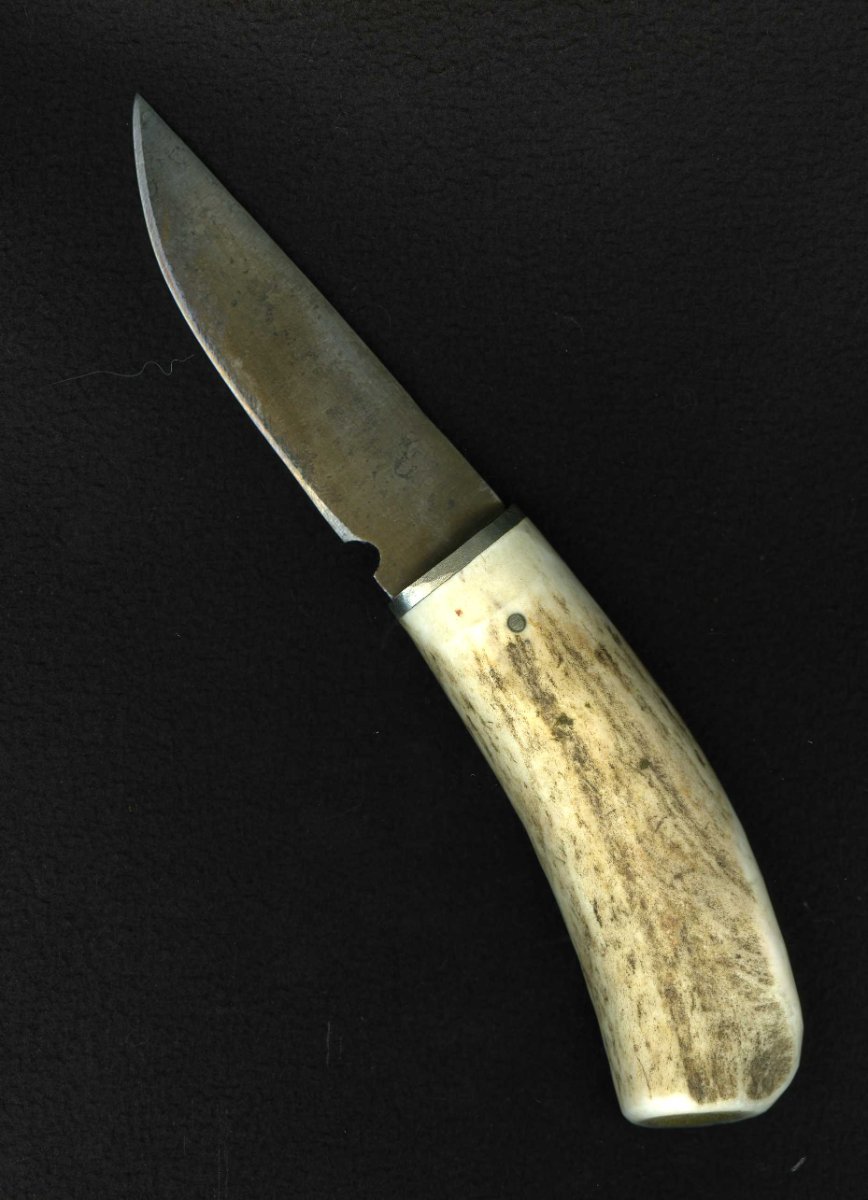

What would be a good product to seal the end of a knife handle made of antler? I forged a knife and hafted it with elk antler which was not the best, as it has a porous place at the butt and another midway down the handle. I would like to seal it up and make it somewhat more smooth.

What about CA glue??

I already have some on hand, so that probably makes a difference, but would be using several light coats of Tru-Oil, and leave to dry overnight between coats, and leave it for 2 weeks to completely cure after the last coat. It dries rock hard, can be left shiny, or sanded back with 0000 steel wool to make a matt finish and will leave the surface area covered super smooth.

Depending on how porous the pith is, dictates the type of glue I use. If it is very porous I use 5-minute epoxy. Of course that usually requires sanding and a second application. Any remaining voids at usually fill in with zap a gap green, the medium viscosity see a glue.
If you want to dye the pith do so before applying any glue. Be careful, because the porous material absorbs to die very readily.
If the pith is very tight and not too porous, I would seal it with CA glue. Normally, I would use the zap-a-gap pink which is the very thin viscosity and I would allow that to run in as far as I wanted to to help make a good seal. They would do a second coat of the like pink CA and allow them to set up. You don't have to fill it up just a good coat down inside so you know the pith is beginning to be sealed inside. I think it holds things together a little better and helps to keep the med CA in place a little.
If you're still not happy with the results I would suggest a brass butt plate. It doesn't have to be brass oh, but I think brass would look good on it.
