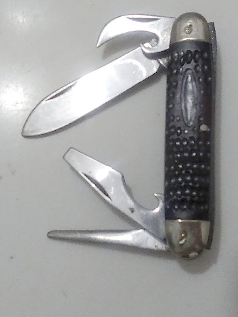

Here is a 640045R (for reject maybe?). Note pins. On this one, the backsprings aren't finished & it is almost impossible to open 2 of the blades. Tang stamp is ground away & shield has been removed. Definitely a lunchbox knife..

knife7knut wrote: Thu Aug 10, 2023 2:44 am Here is a 640045R (for reject maybe?). Note pins. On this one, the backsprings aren't finished & it is almost impossible to open 2 of the blades. Tang stamp is ground away & shield has been removed. Definitely a lunchbox knife..
The "R" on this one would indicate it has a bail.

The “R” in a Case pattern number is their abbreviation for “ring”, meaning the knife has a bail. It does NOT stand for “reject”. The knife you’ve pictured is another Camillus-made knife, made under contract for Case. Maybe Camillus sold them as seconds? Or they were bought by the pound as part of their bankruptcy liquidation?

My inference of the ''R'' standing for REJECT was said with tongue planted firmly in cheek. Sorry if I ruffled any feathers with it & the ''lunchbox'' reference

Both the OP hawkbill and the later posted 640045R are contract knives made by Camillus. The checkering that you see on the blade pins is from the factory when the pins were peened by a drop hammer. This means that each knife was declared a "second" and pulled off the line prior to final finishing.
