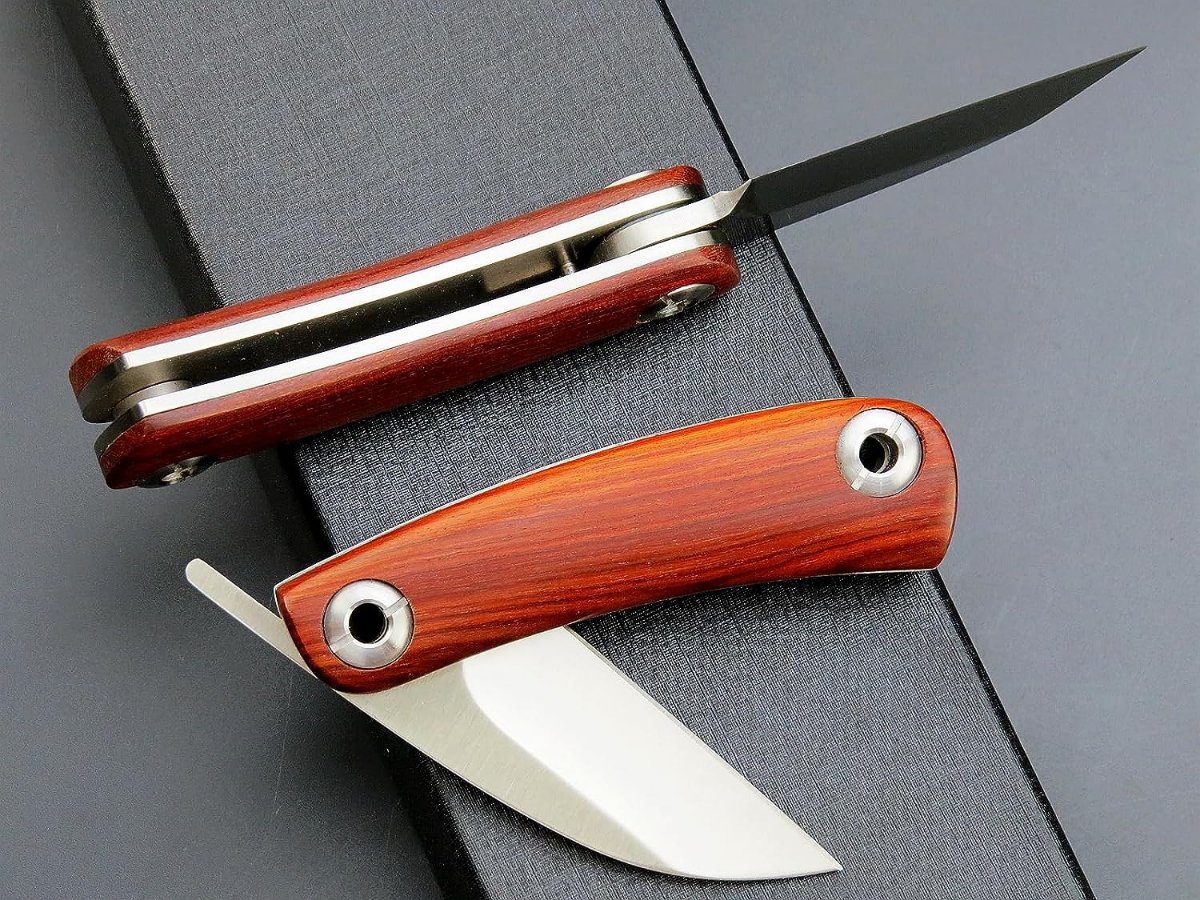

Eafengrow EF11
The EF11 which sells for roughly $12 has a 2.8" D2 blade. The handle is Red Wood, which might just mean that it is stained “redish” in color. The weight is 3.42 oz.
The knife Opens and closes trivially, but, you need to keep your hands in the right place so that the blade does not close. The knife is pretty beefy even if it is not terribly long. The wood scales are over a steel liner. I strongly prefer a locking knife and nothing holds the blade open apart from your hand with the part that sticks out the back of the knife when it is closed. The knife is, however, very comfortable in my hand.
The first EF11 I bought a few years ago came very sharp so I never sharpened it before I gave it away. The second (recently purchased) was not as sharp and I measured the factory edge to be about 25° per side. I used the Worksharp to take the primary angle under 15°. I then polished the edge past a 5K belt finishing with a power strop. The knife was very sharp, but, I did this freehand and I finished on the Spyderco where it is easy to do a final touch-up at 15° for my secondary bevel.
When finished, the edge was very polished and nice looking. I cut thin newsprint very nicely as I cut wavy patterns into the paper.
While belt sharpening at finer grits, I drew a thin paper-like burr along the entire edge that kept it from cutting paper well until after I removed the burr. I removed the burr by either running the cutting edge gently in a piece of wood or by “stropping” the blade on one of my ceramic stones. I expect that simply using the Spyderco would have also removed the burr.
A very impressive edge on finishing.

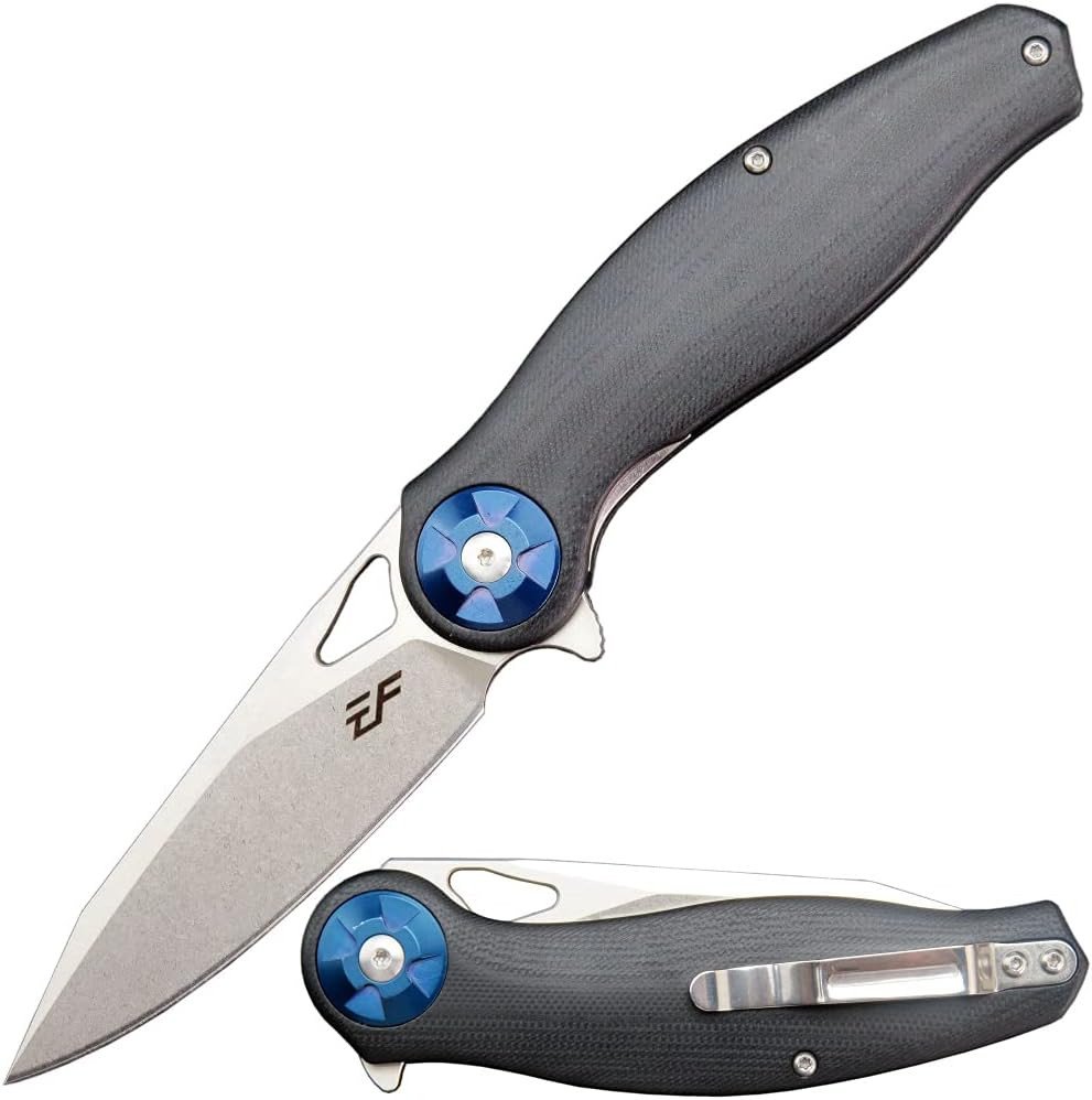

Eafengrow EF76
The Eafengrow EF76 has G10 handles that come in black (the one I have), Jade (light green), and Orange. All three have a D2 Stone-washed Blade and a deep carry pocket clip. The cost is roughly $25, but it was $20 after a 20% instant coupon on Amazon.
The knife Opens easily and has a frame lock. There is no spring assist with the knife but I can open it without too much trouble if I flick my wrist. Most of my other knives open a bit more easily than this (Case and Buck with a similar opening mechanism).
This knife does not have a liner, but at the bottom rear there is a chunk of metal that adds some heft to the knife. The knife is sanded smooth (very little texture), and it feels good in the hand, but, without texture I expect it to be slippery (ish) when wet.
The D2 blade is 3.5" long and weighs 4.34 oz, so almost the same weight as the EF11.
Bevel angle was similar to the EF11 so I did the same for sharpening with exactly the same results.

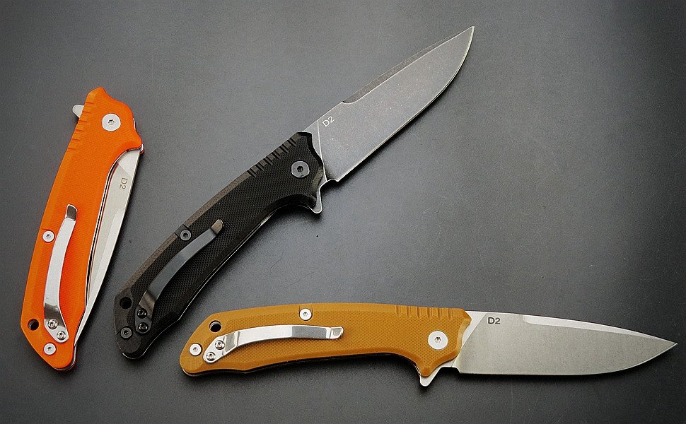

Eafengrow EF223
The Eafengrow EF223 has G10 handles that come in orange, brown, and black. All three have a D2 Blade and a deep carry pocket clip. Notice that the black knife has a darker blade than the orange and the brown handled knives. These sell for $20 on Amazon.
This knife has a steel liner, but it is still the lightest of the three knives by about half an ounce. The handle is textured and feels good in the hand.
The D2 blade is 3.5" long and weighs 3.84 oz, the lightest of the knives.
I have had a couple of these and I usually give them away to someone who needs a knife because they are one of the cheaper knives that I might carry. Every one of these knives came pretty sharp. I measured the factory edge at roughly 13.5° per side. I was happy with the edge until I sharpened my other two knives. I was not able to get it cutting as well as the other two, but, I only did a quick sharpen on my spyderco. I think that for fancy cutting I would want to polish the existing edge because the primary factory grind is rather rough compared to the polished surface that I created on the other two before I did the final sharpening. I just have not take the time to do it yet because the results are still pretty amazing for a minute or two of work. I currently have an orange knife and a brown one will be delivered shortly. I will probably polish those and then do a final sharpening. At the moment, however, I am very happy with the edge even though I expect do better with 10 minutes setup / take down and four or five minutes work per knife.

I received three more EF223 knives this last weekend and they all had the same (ish) angle and sharpening. As with the others, I was able to cut curves in thin newsprint. The edge is consistent and clean along a secondary bevel.
I realized that each of these EF223 knives come with a small square of white cloth in the box.
