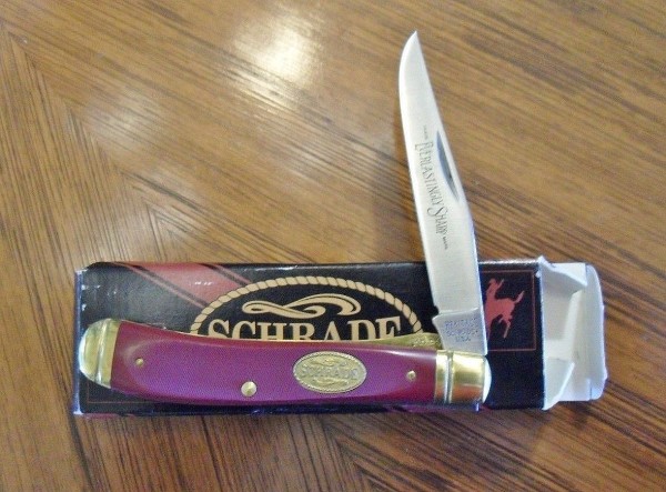

I picked up a Slim Trapper in jigged delrin and a tang stamp of (1st line) HERITAGE (2nd line) SCHRADE+ (3rd line) U.S.A.; reverse is stamped H194. No shield.
I paid an OK price - plan to carry and use, not as an investment. Is this an "end of days" knife assembled in the factory or offshore from leftover parts that SMKW bought?
Thank You!
*seller's pic*
Thank You!
*seller's pic*

I would call it end-of-days. The Heritage folding knives had smooth genuine bone covers.

I am OK with that and the seller had more than 1 in stock, which is a pretty strong hint that its not a rare, one of a kind, bargain
P.S. The seller did not mis-represent it.

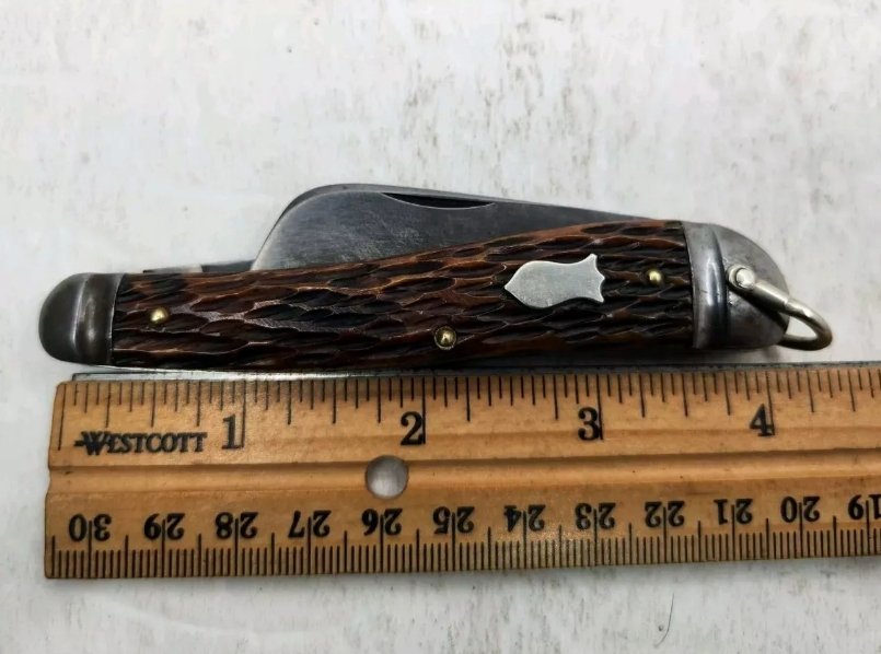

Was staring at this Schrade Farmers Knife a day or more ago - Being offered for $500.00 - Pattern 730 - Pretty example of some of the more Valuable and Higher Quality Made Schrade's ~ Farmers are Highly Sought and aren't usually in such good shape as this one is ~ Used for Horticulture and Agriculture around the Farm, Tasks from Grafting Fruit Trees to Cutting Rope and Twine ~ Pocket Knives Your Great Grandpa would of owned ~

It is a safe bet that the knife was assembled after the original Heritage run, probably at or after the end of Camillus' existence. The seller did not indicate it is anything special, only noted the tang stamps, model, and handle material.
I bought it for what I think is a fair price for a user in what appears to be very good condition (although knife prices shot up as much as ammo in the last few years). It also appeals to me visually, a consideration since I tend to carry and use my pocket knives daily.
A stainless knife won't require as much care as my carbon pocket knives and hopefully I will have better luck with the Schrade stainless than I have with Case SS, which seems to dull if you wave it through the air.

Whelp, its not exactly the knife I bought. The seller grabbed one of the batch of as-new knives they are selling for pics, which happened to be the one with the heritage blade. I received a non-Chinese delrin Schrade + Trapper, which was the goal.
