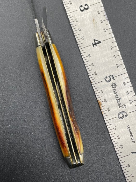

Am I right to believe this is a modern day Remington reproduction by Camillus? What is the difference between “fake” and reproduction? Licensing? Intent? Just curious.

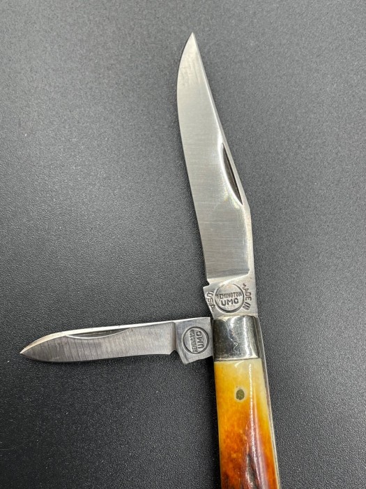

It is a complete fake - not an authorized repro. Appears to me that it was made out of a Queen #51.

Those stamps are horrible. Great example of a “cold stamp”. Note the mushy, not sharp/crisp look. Also, can’t recall ever seeing an old authentic Remington or a Camillus-made authorized reproduction Remington having Sambar stag covers.

Utica / Kutmaster used that "T" stamp on back tangs. Likley a Kutmaster blade.

We hate to be the bearer of bad news, but we do all know the feeling. There are knives being counterfeited every day, and it tarnishes the reputation of knife collecting.
Here are a couple of things to look for: The choil on the main blade is upswept, especially noticeable when you compare it to the small blade. That happens when the counterfeiter ground off the original tang stamp to restamp it. The secondary blade was originally blank..
Also, the metal is "mounded up" around the stamp, showing that it was cold stamped.
A Remington knife will usually have an R+ model # stamped on the back of the main blade.
Lastly, if an old knife is too shiny, it has been buffed and polished. Sometimes that is done to make it sell easier (shiny sells!), but sometimes it is because the knife has been taken apart and they are trying to buff away the evidence.
As far as a reproductions, Remington sold their knife plant in 1936 I believe.
Since then the Remington company has commissioned their knives made by many different countries, both in the US and overseas. Those are licensed and paid for by Remington. So technically they are a genuine Remington knife, just made by someone else for Remington.
I hope some of this helps. That counterfeit is yours to do with as you want, but some guys drill a small hole through the tang to mark it and use the knife. Some people keep them to show other new collectors what to look out for. Some people destroy them. Whatever you choose, I am sorry that someone took advantage of you. As you handle more real old knives, you learn how to spot a lot of these fakes.
Have a great day!

It looks like a nice knife and the stag is very attractive but there is the fact that Remington never made a standard size trapper during their pre-1940 production years. Any such standard size trapper can't be an original Remington.

Drill holes thru that fake Remington tang stamp. That will denote that the knife is a fake for future owners, but will still allow use of it.
